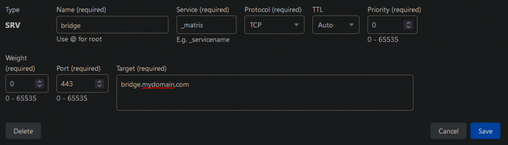

DNS Setup:
You're gonna want a few subdomains, even if you have a dyndns setup pointing to your host. Then can all point to the same IP, or you can use CNAME or ALIAS records to point to the root domain. A DNS setup for somedomain.gg might look like this:
Type - Host - Value
A - @ - 1.2.3.4 (Your WAN IP)
CNAME - bridge - somedomain.gg
CNAME - chat - somedomain.gg
CNAME - meet - somedomain.gg
In the above-the `@` A-record will set the IP for your domain root, and the CNAME-records will cause the 3 subdomains to resolved to whatever domain name you point them at (the root domain, this this case).

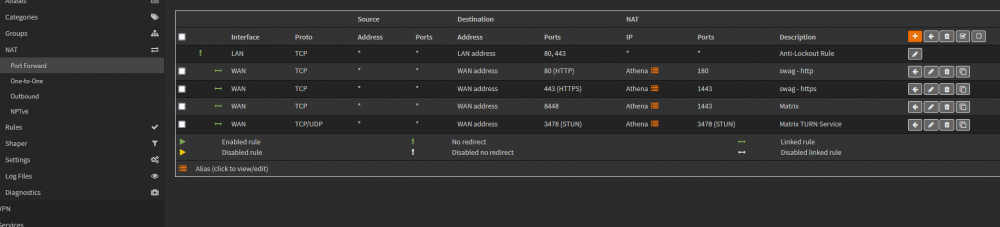

Firewall Setup:
You'll need the following ports forwarded from you WAN to you Unraid server:
LetsEncrypt: WAN TCP 80 -> LAN 180 , WAN TCP 443 -> LAN 1443, WAN TCP 8448 -> LAN 1443, all on your Unraid server IP
  - 80: Used by LetsEncrypt to validate your certificate signing request -- this can be disabled after setup, then only enabled when you need to renew a certificate.
  - 443: LetsEncrypt proxy for encrypted web, duh :P
  - 8448: Matrix Integrations port for enabling plugins. Also proxied via LetsEncrypt. Make sure this points to 1443, not 8443!
STUN: TCP and UDP 3478 on WAN -> 3478 on Unraid (or changed to suit your needs)
Jitsi: UDP Port 10000 -> 10000 on Unraid
We'll be assuming you used these ports in the rest of the guide, so if you needed to change any, compensate as needed!

Okay so I can’t connect to matrix.mydomain.com:8448 I’ve double checked PFSense and TCP 8448 is forwarded to 192.168.x.x:8448. Same as the other ports (443 to 1443 and 80 to 180).  So I’m pretty confident that part is correct in pfsense. I set up my letsencrypt proxy configs according to your your config example file....so I’m not sure what I have wrong
do I need to add anything to the homeserver.yaml to tell it to listen to 8448?
You found my mistake in the write-up, congrats :D My setup forwards 8448 to 1443 rather than exposing 8448 directly -- that way it goes through LetsEncrypt and you dont get cert warnings, and you don't need to make Matrix listen on 8448. Nice catch! I'll update the guide to reflect that.
Edit: to make that more clear: The guide originally said to forward WAN 8448 to LAN 8448, which is wrong. It SHOULD have said to forward WAN 8448 to LAN 1443, so that LetsEncrypt redirects the traffic back to the HTTP port of the Matrix service on 8008.
Edited by yinzer
okay so I changed NAT to forward WAN 8488 to LAN 1448 and I still fail the federation check.
edit:
Got it.  miss type on your edit.  its not "It SHOULD have said to forward WAN 8448 to LAN 1448" its:
only pointing it out in case someone is right behind us trying to figure it out.  I now pass the federation check.
Thank you so much for the back and forth, defiantly could not have gotten this working with out you
