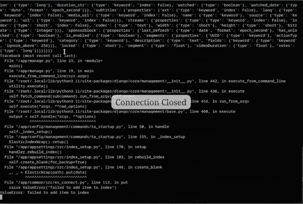

[Support] Crocs - Tube Archivist
Was able to update to v.0.5.0 with no problem, but updating to later versions causes my TubeArchivist app to crash on startup. Has anyone else dealt with this? Even when I try to view the logs, the window closes out on me. I changed permissions, increased the ES memory, deleted the dump.rdb and the db.sqlite3, and I'm left scratching my head. TubeArchivist-Redis and TubeArchivist-ES startup and stay running.But when I run TubeArchivist and I open the logs to check out what's going on, it runs until it just randomly closes out and the docker container stops. Obviously, I'm missing something. I was able to screen record and then catch a screenshot of what the logs looked like before it closed out and I've posted the picture here. If anyone can help, I'd much appreciate it.

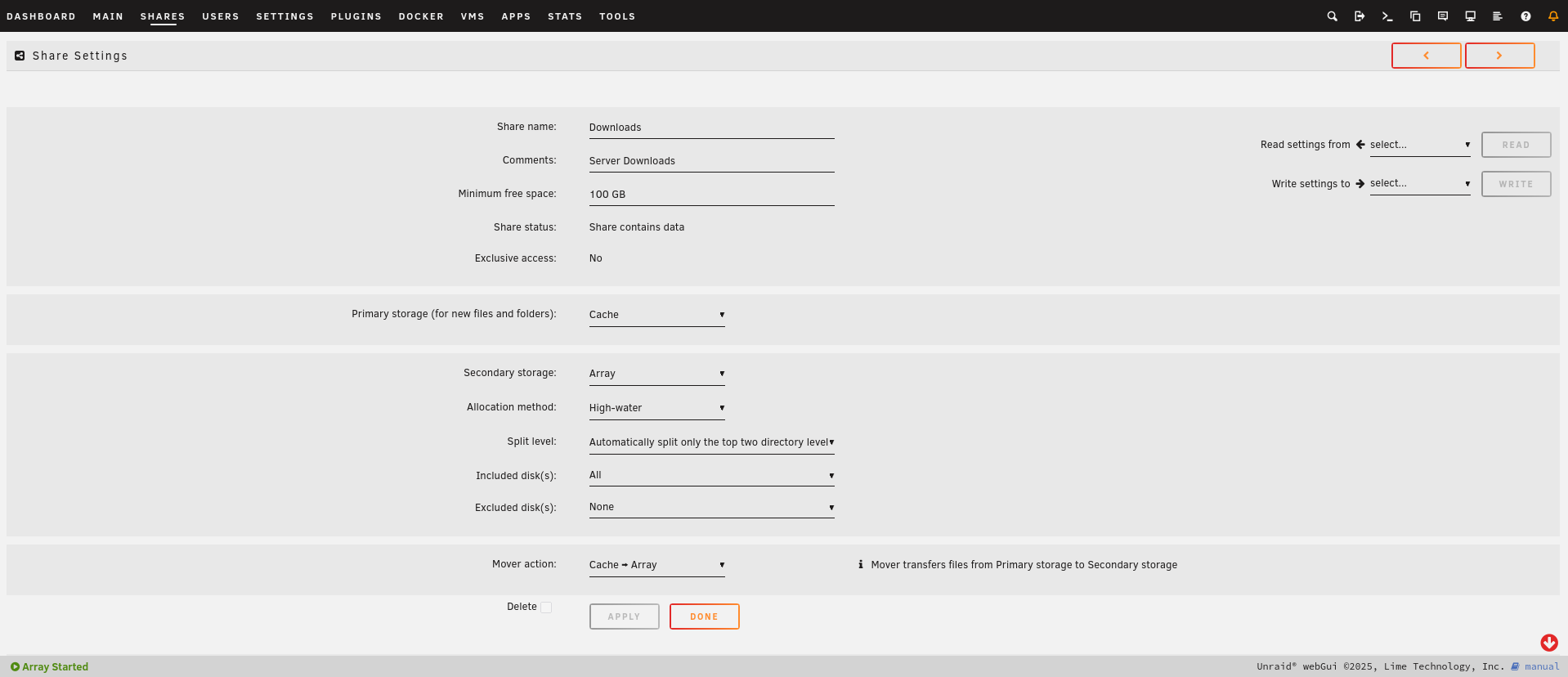

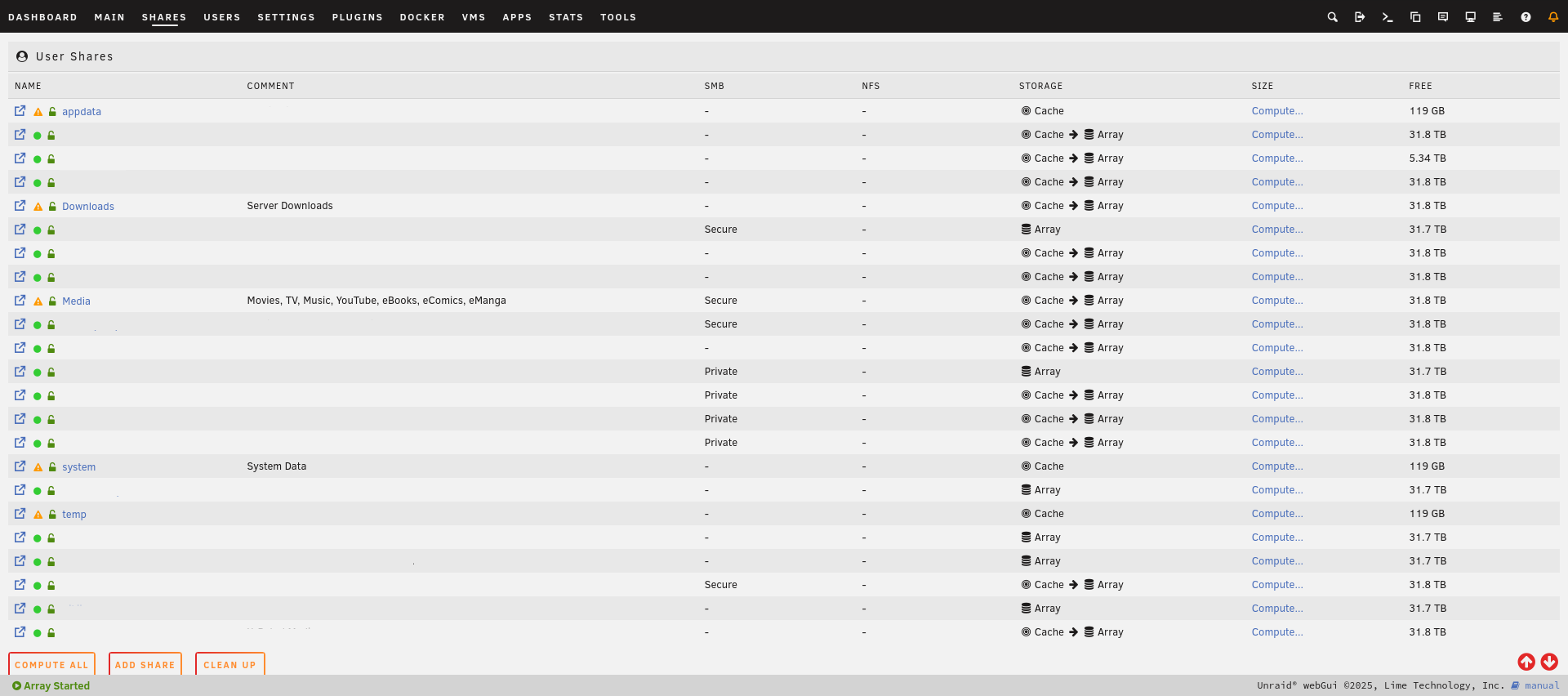

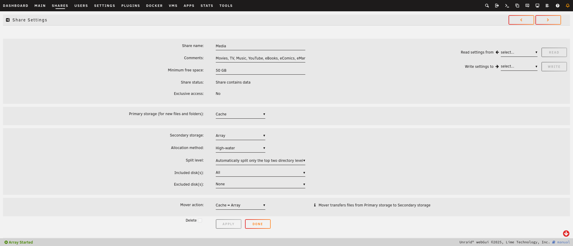

[SOLVED] Mover Is Not Moving Files From Cache To Array (Screenshots and Diagnostics Included)
That seems to have fixed my issue. Thank you! Just out of curiosity, how did you figure that out? I feel like I scoured the internet and forums and I never saw anything mentioning capitalization in the flash drive, of all places, affecting the Mover. How did you know that was the issue?
I'm sorry. I thought I added them. I've attached the diagnostics.
Using Unraid 7.1.4. Essentially what the title has said. I have two shares, Downloads and Media, that have files on the cache. The shares are set up to move the files from the cache to the array. The Mover is scheduled to move the files when the server is idle at 04:00 every day. However, it has not been doing that. Even when I manually invoke the Mover, nothing happens. It just starts and stops. I am not using the Mover Tuning plug-in, just the default in-built Mover on Unraid. The diagnostics show no errors that I'm familiar with. Oct 22 03:20:26 SERVER move: mover: started Oct 22 03:20:26 SERVER move: mover: finished Oct 22 03:23:39 SERVER emhttpd: Starting services... Oct 22 03:23:40 SERVER emhttpd: shcmd (390): /etc/rc.d/rc.samba reload Oct 22 03:23:40 SERVER emhttpd: shcmd (394): /etc/rc.d/rc.avahidaemon reload Oct 22 03:23:40 SERVER avahi-daemon[3138]: Got SIGHUP, reloading. Oct 22 03:23:41 SERVER unassigned.devices: Updating share settings... Oct 22 03:23:41 SERVER unassigned.devices: Share settings updated. Oct 22 03:23:53 SERVER emhttpd: shcmd (399): /usr/local/sbin/mover start |& logger -t move & Oct 22 03:23:53 SERVER move: mover: started Oct 22 03:23:53 SERVER move: mover: finished Oct 22 03:32:32 SERVER emhttpd: Starting services... Oct 22 03:32:32 SERVER emhttpd: shcmd (402): /etc/rc.d/rc.samba reload Oct 22 03:32:33 SERVER emhttpd: shcmd (406): /etc/rc.d/rc.avahidaemon reload Oct 22 03:32:33 SERVER avahi-daemon[3138]: Got SIGHUP, reloading. Oct 22 03:32:33 SERVER unassigned.devices: Updating share settings... Oct 22 03:32:33 SERVER unassigned.devices: Share settings updated. Oct 22 03:32:41 SERVER emhttpd: shcmd (411): /usr/local/sbin/mover start |& logger -t move & Oct 22 03:32:41 SERVER move: mover: started Oct 22 03:32:41 SERVER move: mover: finished Oct 22 03:33:56 SERVER emhttpd: Starting services... Oct 22 03:33:57 SERVER emhttpd: shcmd (414): /etc/rc.d/rc.samba reload Oct 22 03:33:57 SERVER emhttpd: shcmd (418): /etc/rc.d/rc.avahidaemon reload Oct 22 03:33:57 SERVER avahi-daemon[3138]: Got SIGHUP, reloading. Oct 22 03:33:57 SERVER unassigned.devices: Updating share settings... Oct 22 03:33:57 SERVER unassigned.devices: Share settings updated. Oct 22 03:35:29 SERVER emhttpd: Starting services... Oct 22 03:35:29 SERVER emhttpd: shcmd (425): /etc/rc.d/rc.samba reload Oct 22 03:35:30 SERVER emhttpd: shcmd (429): /etc/rc.d/rc.avahidaemon reload Oct 22 03:35:30 SERVER avahi-daemon[3138]: Got SIGHUP, reloading. Oct 22 03:35:30 SERVER unassigned.devices: Updating share settings... Oct 22 03:35:30 SERVER unassigned.devices: Share settings updated. Oct 22 03:36:06 SERVER emhttpd: Starting services... Oct 22 03:36:06 SERVER emhttpd: shcmd (436): /etc/rc.d/rc.samba reload Oct 22 03:36:07 SERVER emhttpd: shcmd (440): /etc/rc.d/rc.avahidaemon reload Oct 22 03:36:07 SERVER avahi-daemon[3138]: Got SIGHUP, reloading. Oct 22 03:36:07 SERVER unassigned.devices: Updating share settings... Oct 22 03:36:07 SERVER unassigned.devices: Share settings updated. Oct 22 03:37:03 SERVER kernel: nvidia_uvm: module uses symbols nvUvmInterfaceDisableAccessCntr from proprietary module nvidia, inheriting taint. Oct 22 03:37:10 SERVER emhttpd: shcmd (445): /usr/local/sbin/mover start |& logger -t move & Oct 22 03:37:10 SERVER move: mover: started Oct 22 03:37:10 SERVER move: mover: finished I tried changing a few settings and running it manually a few times, but to no avail. I have noted that the mover will still move files from other shares on the server, but just not these two shares for whatever reason. It was working before so I'm not sure what has changed. Any help would be much appreciated.
Has there been a fix to this that isn't reverting back to previous version? I'd like to be able to use the `latest` tag. This does work though.
