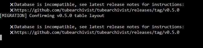

Getting the internal server error despite installing the two dependent packages and pointing to the local IP addresses in the setup.  Any advice here?  See link below for settings.  Im not seeing anything I need to change in the dependent packages but maybe Im missing something.  Thanks!
Your Redis variable is set up wrong.
It's just the IP address, your variable should be '192.168.1.70'.
No 'http://' or '6379'
Let me know if that works!
