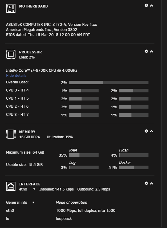

I have attached diagnostics. I know there are mce errors in the log, but after an upgrade my log memory is maxed out, that didn't happen before. I don't know what to do about the mce errors, if anyone can help me narrow down what the issue might be, I'd be really grateful. I'm hoping correcting that will help reduce the memory utilization. syslog.1.txt tower-diagnostics-20220519-1214.zip

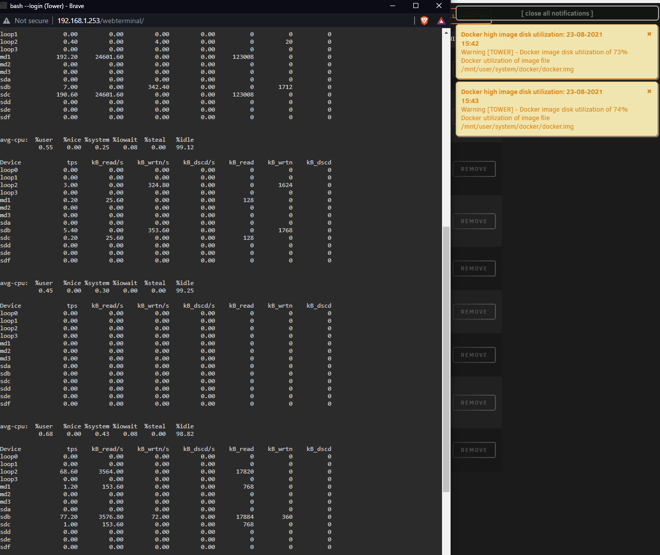

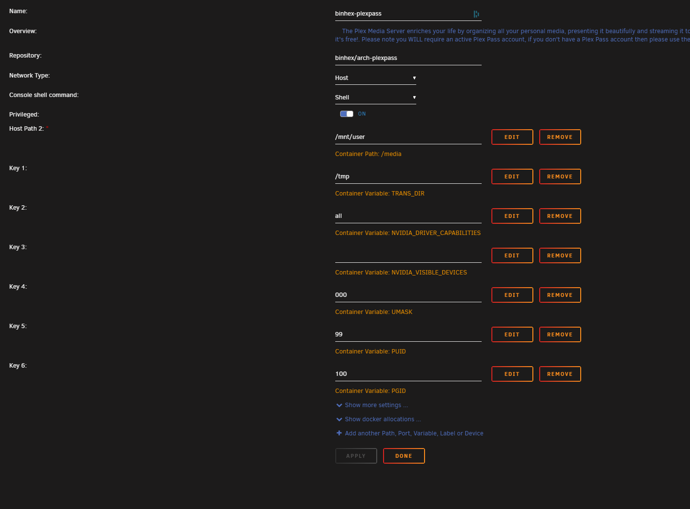

I don't know how to check how big I made the Docker image, but right now it is at 11.2GB. The only Docker I have adjusted recently was Plex, and I think the disk utilization issue might have been with the Key 1 value in Plex. I saw that it can be better to transcode to /tmp so I added the Key 1, but didn't include a forward slash after the /tmp, I updated it now to read /tmp/ maybe that was the issue with the warning?

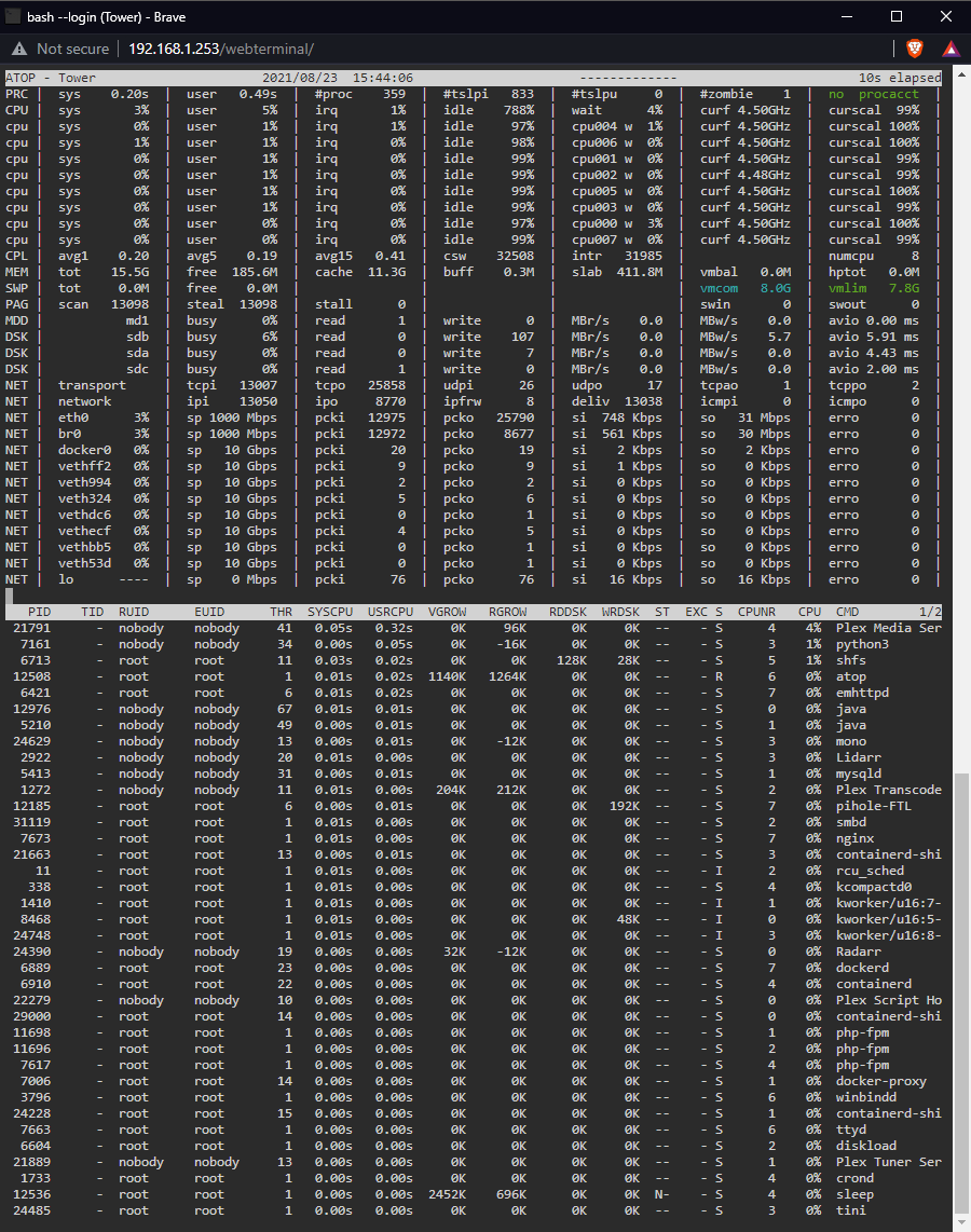

Running a 4k file stops and buffers every 10 seconds. I have a Docker high image disk utilization warning in the Dashboard. I ran the I/O checks I could...IOTOP and DSTAT require GLIBC 2.33, and despite having all of the packages installed for DevTools and NerdTools they won't run, and I don't know how to install GLIBC 2.33. I have included screenshots of what I have, and I also have included my PMS debug logs if that's of help. Thanks for any suggestions. Plex Media Server Logs_2021-08-23_15-48-16.zip
Thanks binhex! I don't see any extra logging options in Unraid/Docker aside from Debug level within Plex Settings, is that where I should tweak logging? I'll also try and run some of the io tools you suggested.

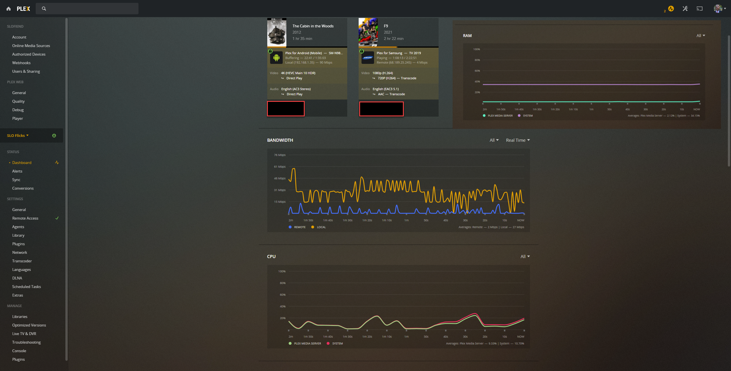

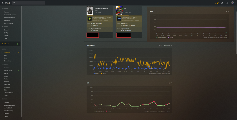

Is this the right place to post questions for support? I recently moved Plex to Docker and it's been working great. I have had several recent issues however with buffering whereas I didn't prior to migration. I am trying to understand where the bottleneck (if any) is coming from. From the Unraid Dashboard, all performance data seems to be in good shape. Plex Dashboard shows all is well too. Yet I have buffering, on DirectPlay as well as Transcoded content. How do you suggest I work through to find the source of the issue that is causing buffering to occur? I am attaching my Docker Config screenshot, a modified version of my Plex Dashboard, as well as a screen shot of my Unraid Dashboard while several streams are running if that helps. Thanks for you insight!
