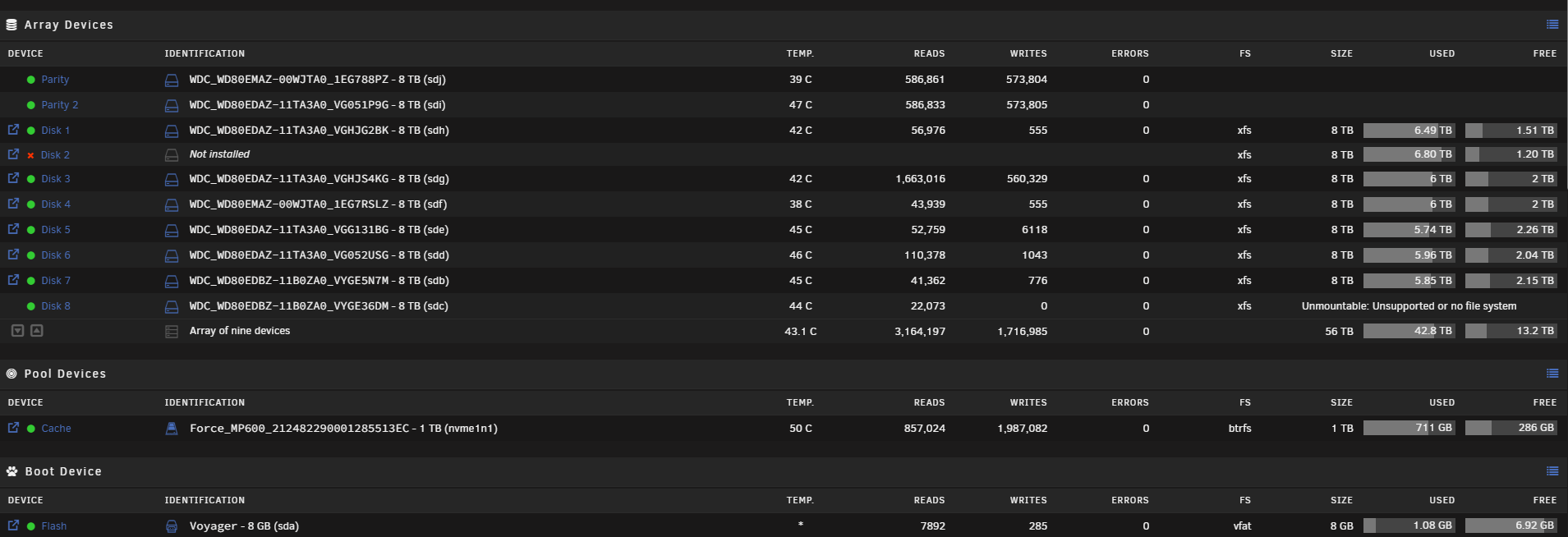

  1. Well. A week later, the new disk has implosed too. Assuming this come from cable, I got an extra 8TB on my array! From your experience, may it come from the power supply cable or the sata one? Thanks!
  2. Fingers crossed... Data-rebuild is in progress. After that, I'll do some checks on the "old" disk.
  3. Hi ! Thanks for your answer. So you're pretty sure that the LSI card is not faulty ? Where did you see that in the log ? Here ? Apr 22 00:24:21 Unraid kernel: sd 1:0:4:0: device_block, handle(0x000d) Apr 22 00:24:23 Unraid kernel: sd 1:0:4:0: device_unblock and setting to running, handle(0x000d) All drive where online and spining up. The PSU may handle it, assuming the big drop is when drives are spinning up ? Maybe it is caused by the electronic in drive itself... I ordered a new HD, just in case. Will see tomorrow with the new one. Thanks again.
  4. I'm not sure about that. It has probably been rebuild from udma crc error. Do you want me to remove it from the array and try a smart report ?
  5. Hello there, I often have disk errors, couple of minutes after the partity check starts. I usually resolve this by opening the case, moving cable, and lot of prayers ! Disks are plugged on a LSI cards. Do you think it is relied with HDs, cables, temperature, LSI card ? Is it possible to access to le LSI card log, temp, or something ? Thanks a lot... FP unraid-diagnostics-20250422-0113.zip
  6. Ok. Recovery with XFS seems to be pretty good, doin' it. Not all heroes wear capes. Thanks again.
  7. Well, UFS works pretty well. I got like.... 40GB of soup. (maybe old removed files) The rest (about 7TB) are ok, with a correct structure. I'll just "format" the drive after the backup, and the show must go on ! But I've got a last question : is the xfs file system strong enough ? Theses last 24h were painfull af, don't wan't to do this again ! Thank you again.
  8. Agreed, With the array and parity on, some of my files vanished. Do you have any tips with UFS Explorer ? => Doing a recovery. Praying for a pretty good result. Thanks again.
  9. Thanks for your quick answer ! Ok I'm trying it. If no good result, the parity can't help me ? Zeroing the disk and rebuilt it will result a data loss ? I never had very good results with recovery tools...
  10. Hi, There is an "Unmountable: Unsupported or no file system" disk in my array. (It's the disk 8, the second will be replaced tomorrow). It happened after a crash. Partitions are xfs. I tried the check_xfs command in maintenance mode, with or without the -L argument, but no way. I'm pretty scared, If someone have an idea... Should I zero the disk and rebuild it with the parity ? Thanks a lot. Here's the diag and the result of xfs_repair. _____________________________________________________ TLTR : xfs_repair didn't help me. Even the beta 7.0. Using UFS Explorer in another setup was the solution. (The only "trick" to do is to select the right system file format, xfs) Investigation still ongoing: percentage of dataloss. Pretty low I guess. xfs log.txt unraid-diagnostics-20240726-1819.zip
