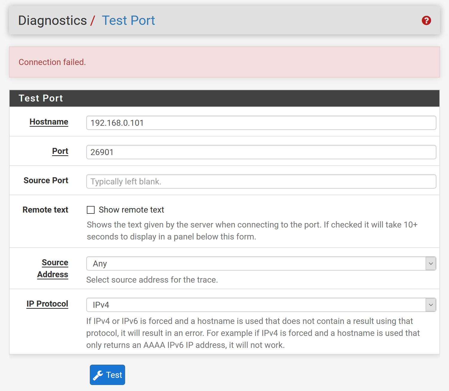

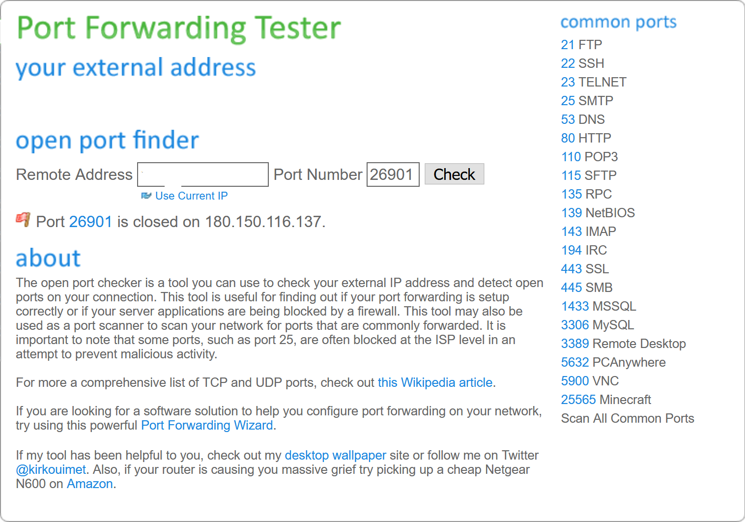

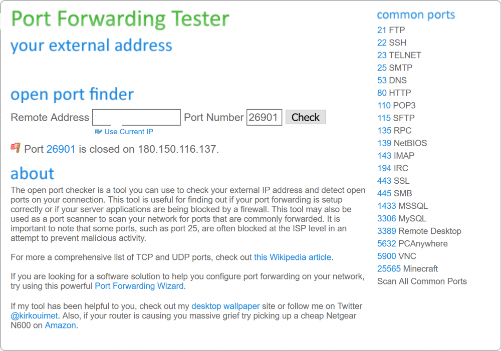

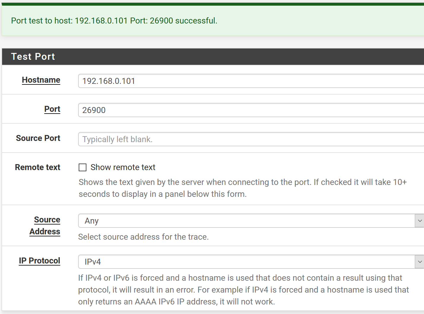

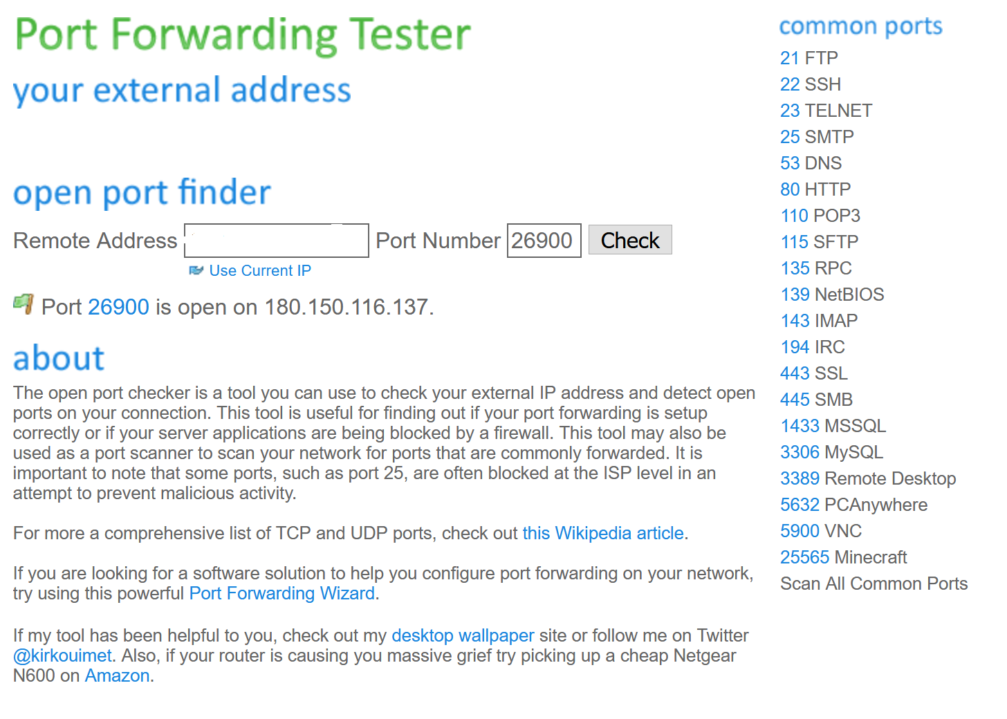

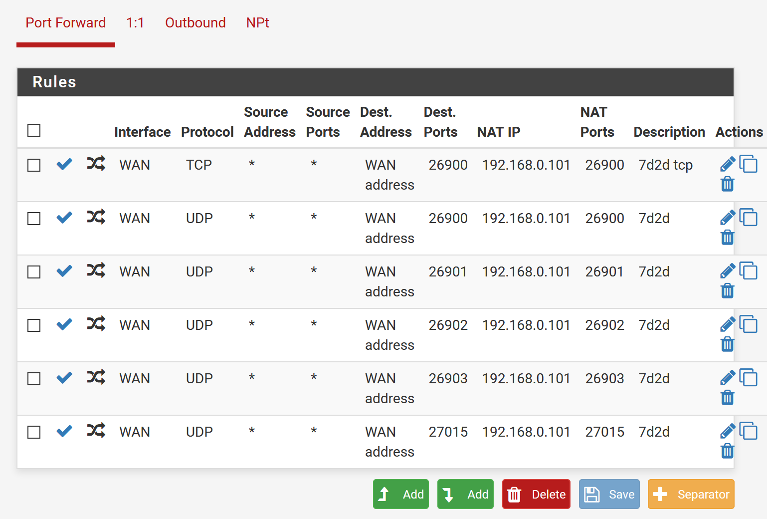

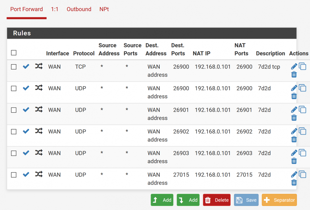

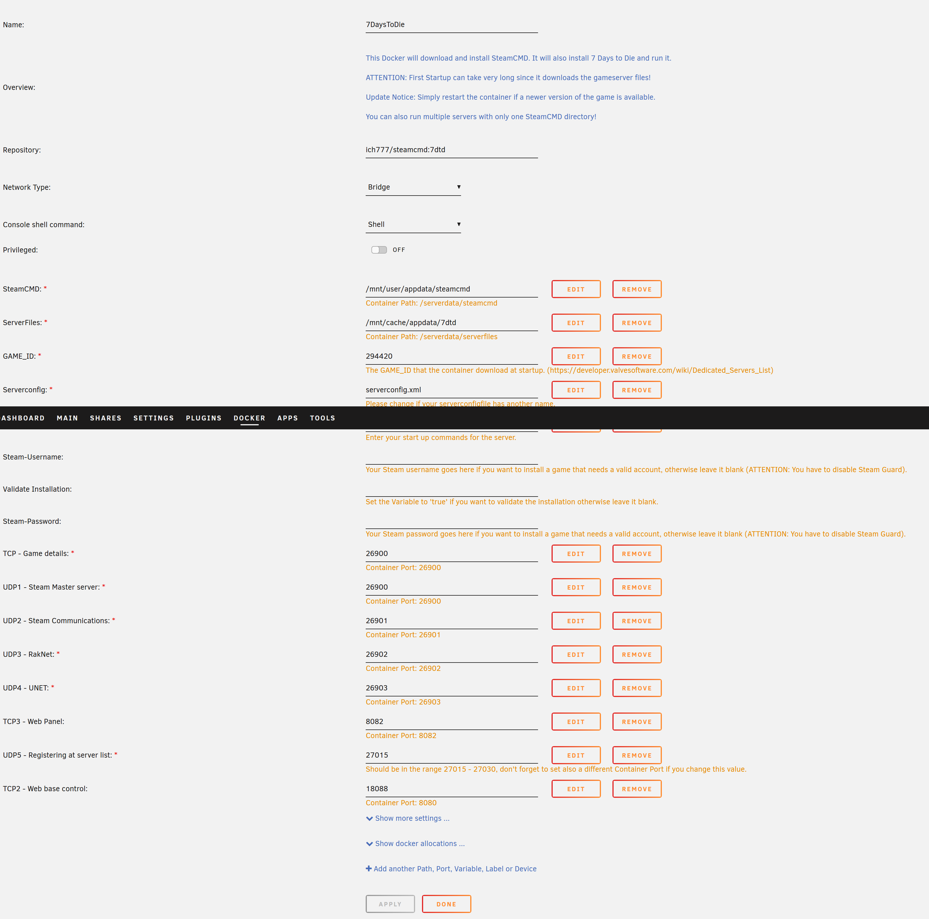

  1. I've been troubleshooting this on and off for the past 2 weeks. would love to work it out by myself but am turning here for help in the end. I'm new to pfsense so I assumed it was an issue with my knowledge there, but I think it's down to checking that the docker is working on my end properly. I'm having some issues getting the server connected from external IP's. I'm sure it's a port issue. I can access the game if I use the local address 192.168.0.101:26900, but can't using the external one. Using the diagnostics from the router it seems the docker isn't actually listening on port 26901/26092/26093/27015. Is that right? I opened the ports listed in this wiki page: https://developer.valvesoftware.com/wiki/7_Days_to_Die_Dedicated_Server#Firewall_Ports as I couldn't find anything concrete specific to the docker container, and it correlates with the container ports output_log.txt
  2. Thank you, of course it worked. I combed that log for about 3 hours trying to see something that would flag the issue. What made you see what the problem was? Like I said I was pretty annoyed I couldn't fix it myself, even more annoyed now it turns out the answer is in the FAQ..

  6. Fixed! I had the wrong subnet in the docker settings. entered 192.168.0.1 instead of 192.168.0.0 Interestingly, managed to typo that a few times since I think I reinstalled the docker image 3 times.

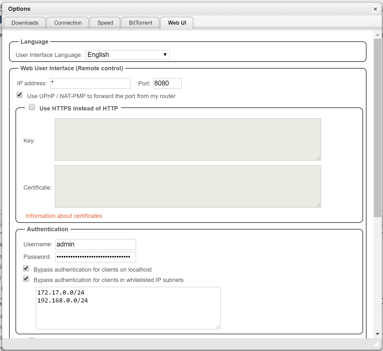

  7. I'm having trouble getting sonarr/radarr to talk to qBitTorrent. I've done a lot of sleuthing, and after following Radarr's error of 19-7-14 16:27:01.9|Warn|HttpClient|HTTP Error - Res: [POST] http://192.168.0.101:8080/login: 503.ServiceUnavailable 19-7-14 16:27:01.9|Error|QBittorrent|Failed to connect to qBittorrent, please check your settings. [v0.2.0.1358] NzbDrone.Core.Download.Clients.DownloadClientException: Failed to connect to qBittorrent, please check your settings. ---> NzbDrone.Common.Http.HttpException: HTTP request failed: [503:ServiceUnavailable] [POST] at [http://192.168.0.101:8080/login] at NzbDrone.Common.Http.HttpClient.Execute (NzbDrone.Common.Http.HttpRequest request) [0x00131] in C:\projects\radarr-usby1\src\NzbDrone.Common\Http\HttpClient.cs:93 at NzbDrone.Core.Download.Clients.QBittorrent.QBittorrentProxy.AuthenticateClient (NzbDrone.Common.Http.HttpRequestBuilder requestBuilder, NzbDrone.Core.Download.Clients.QBittorrent.QBittorrentSettings settings, System.Boolean reauthenticate) [0x000a4] in C:\projects\radarr-usby1\src\NzbDrone.Core\Download\Clients\QBittorrent\QBittorrentProxy.cs:276 --- End of inner exception stack trace --- at NzbDrone.Core.Download.Clients.QBittorrent.QBittorrentProxy.AuthenticateClient (NzbDrone.Common.Http.HttpRequestBuilder requestBuilder, NzbDrone.Core.Download.Clients.QBittorrent.QBittorrentSettings settings, System.Boolean reauthenticate) [0x000e5] in C:\projects\radarr-usby1\src\NzbDrone.Core\Download\Clients\QBittorrent\QBittorrentProxy.cs:286 at NzbDrone.Core.Download.Clients.QBittorrent.QBittorrentProxy.ProcessRequest (NzbDrone.Common.Http.HttpRequestBuilder requestBuilder, NzbDrone.Core.Download.Clients.QBittorrent.QBittorrentSettings settings) [0x00000] in C:\projects\radarr-usby1\src\NzbDrone.Core\Download\Clients\QBittorrent\QBittorrentProxy.cs:217 at NzbDrone.Core.Download.Clients.QBittorrent.QBittorrentProxy.ProcessRequest[TResult] (NzbDrone.Common.Http.HttpRequestBuilder requestBuilder, NzbDrone.Core.Download.Clients.QBittorrent.QBittorrentSettings settings) [0x00000] in C:\projects\radarr-usby1\src\NzbDrone.Core\Download\Clients\QBittorrent\QBittorrentProxy.cs:210 at NzbDrone.Core.Download.Clients.QBittorrent.QBittorrentProxy.GetVersion (NzbDrone.Core.Download.Clients.QBittorrent.QBittorrentSettings settings) [0x00012] in C:\projects\radarr-usby1\src\NzbDrone.Core\Download\Clients\QBittorrent\QBittorrentProxy.cs:48 at NzbDrone.Core.Download.Clients.QBittorrent.QBittorrent.TestConnection () [0x00000] in C:\projects\radarr-usby1\src\NzbDrone.Core\Download\Clients\QBittorrent\QBittorrent.cs:214 I found a corresponding error in qBitTorrents logs (W) 2019-07-14T20:40:40 - is not a valid IP address and was rejected while applying the list of banned addresses. (N) 2019-07-14T20:40:40 - Web UI: Now listening on IP: *, port: 8080 Google really didn't bring up much. I suspect most people enable localhost authentication and ignore authentication processes entirely, but I can't get that to work when entering my subnets for the host PC/docker image. I have no banned addresses entered - this is a clean image of qbit with no settings changed. I tried to enter some with no luck as well. The only troubleshooting I've really found on this issue is here: https://www.reddit.com/r/qBittorrent/comments/9oej06/is_not_a_valid_ip_address_and_was_rejected_while/ The solution Doesn't work either, as changing the IP address to anything else results in being unable to connect to the webui. I'd really like to get qbittorrent working, as I find it the most user friendly client!
  8. Problem: default username and password ("admin" ; "adminadmin") not working on the qbittorrent webui Solution: https://github.com/qbittorrent/qBittorrent/wiki/Web-UI-password-locked-on-qBittorrent-NO-X-(qbittorrent-nox) notably: Bitdefender was blocking me. I tried using a firefox docker through my unraid server and it worked flawlessly. Hope it helps others having the same problem.
