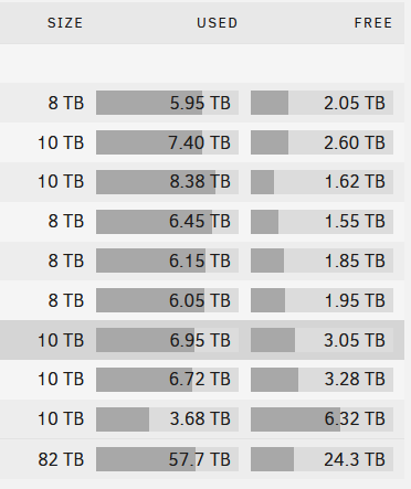

  2. My parity drive is 16TB. Array of 9 devices. My current idea is to move all files off of one of my 8TB drives (I have 24 TB free right now) and replace it with a 16 TB drive to use as second parity. I also want to replace one of the other 8TB drives with another 16 tb to get back the 8TB I'd be losing. My main question is how do I move the files from the 8TB I'll be replacing to the rest of the array? Do I have to move everything manually from disk to disk wherever there is space or is there a trick to get the files off and spread around with the mover or some plugin or something? tower-diagnostics-20250310-2038.zip
