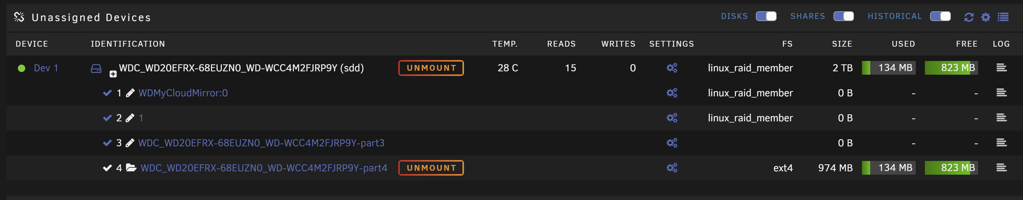

  2. Thanks for that. However, /mnt/disks/ is only showing me the 4th partition.
  3. Hello! I hope I'm not asking a question that has been answered repeatedly, but I am having trouble making any progress after much reading. My friend had a WD "My Cloud Mirror" that he used in conjunction with Time Machine/Apple backup. The drives were in RAID 1 (as far as I know). It is a two drive enclosure and he explained they were mirrored. I have been able to mount the disks in my Unraid machine using a spare SATA port. Below, I have only one connected at the moment, but have tried with both and they are both listed similarly. I have created an Ubuntu VM and attempted to read the contents of mnt/remotes, but it appears empty (as it does using Krusader). I found a thread started by someone in a similar situation, and one recommendation was: "You can try installing a Linux VM and then pass through the drives to the VM (using the ata-id method - see Spaceinvaderone video)" But I'm having trouble locating the particular video, and cannot figure out where to go from here. I would appreciate any suggestions. I feel like I am 80% of the way there, but not quite sure what to do next. The EXT partition (4th one) can be browsed, but this is not where his data is stored naturally. Pass Through settings for the whole disk and individual partitions does not aid my situation. Thank you in advance! Edit: I do have Unassigned Devices Plus installed and it's possible there is an APFS format on the drives, but I'm not certain.
