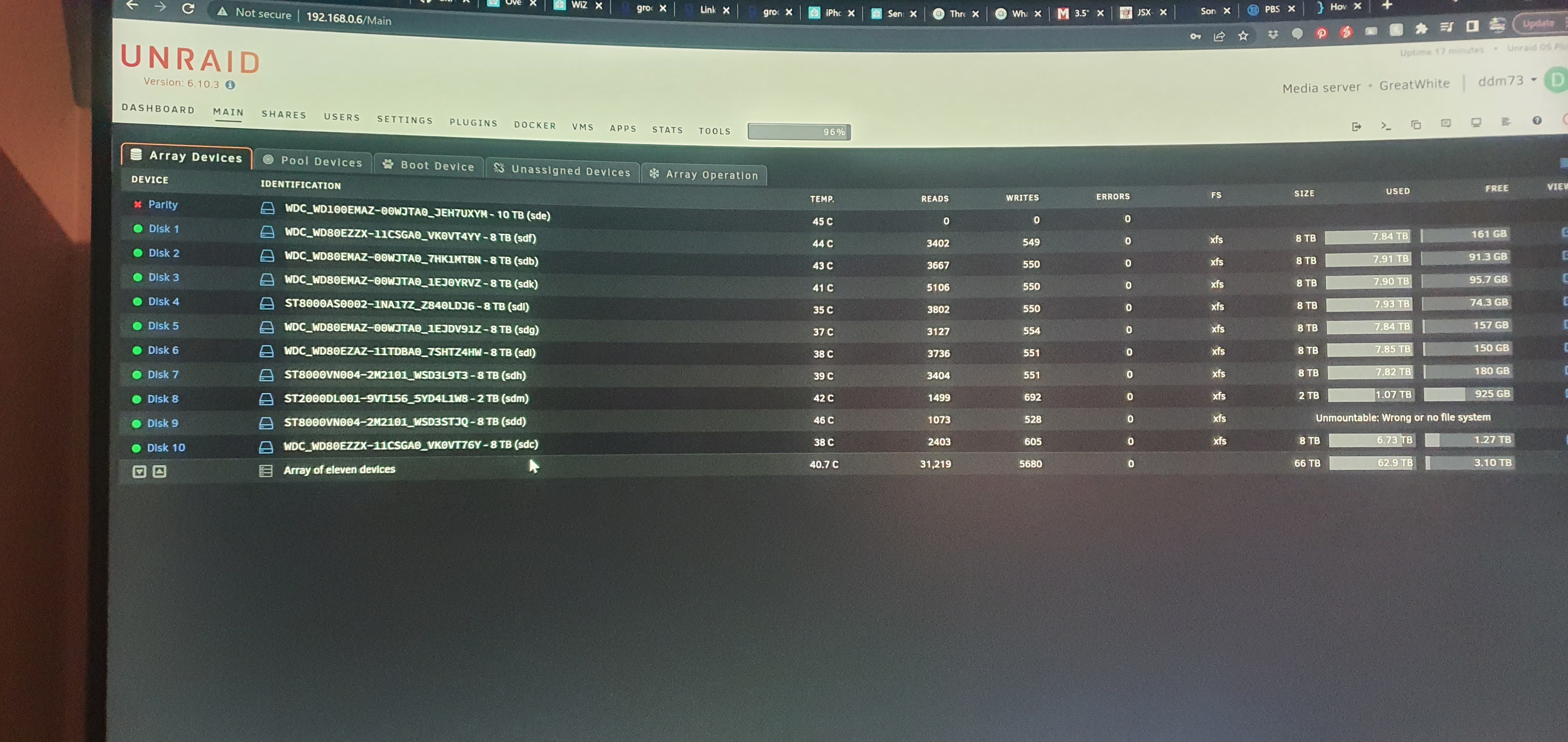

  19. The screen shot was prior to adding the 2nd parity but I didn't start the array with the new parity disc. So the array is back to how it was when it failed. I don't have any reason to suspect that the parity wasn't valid before it became disabled.

  22. The old disc 9 is in a box ready to ship off to Seagate to have data recovery attempted on it. I can pull it out of the box and plug it back in but then how do I attempt the repair?
  23. SO, not having 2 parity discs appears to have bitten me in the arse. My parity disc is showing a red x and one of my data disc in not mountable [image attached]. The data disc is under warranty with free data recovery so its a maybe for getting the data back but in the meantime because the party appears to have failed I can't rebuild either. What are my options for getting the server back up and running without the data [hoping that I will get it back from the data recovery service]? If I rebuild the array, do all my apps still know where everything is? Or am I going to need to effectively start with a fresh UnRaid install and reinstall everything from scratch? I now have enough replacements to run 2 parity but need a path to get back to operational [preferably] without starting from scratch. Diags attached. Thanks greatwhite-diagnostics-20220922-1309.zip
