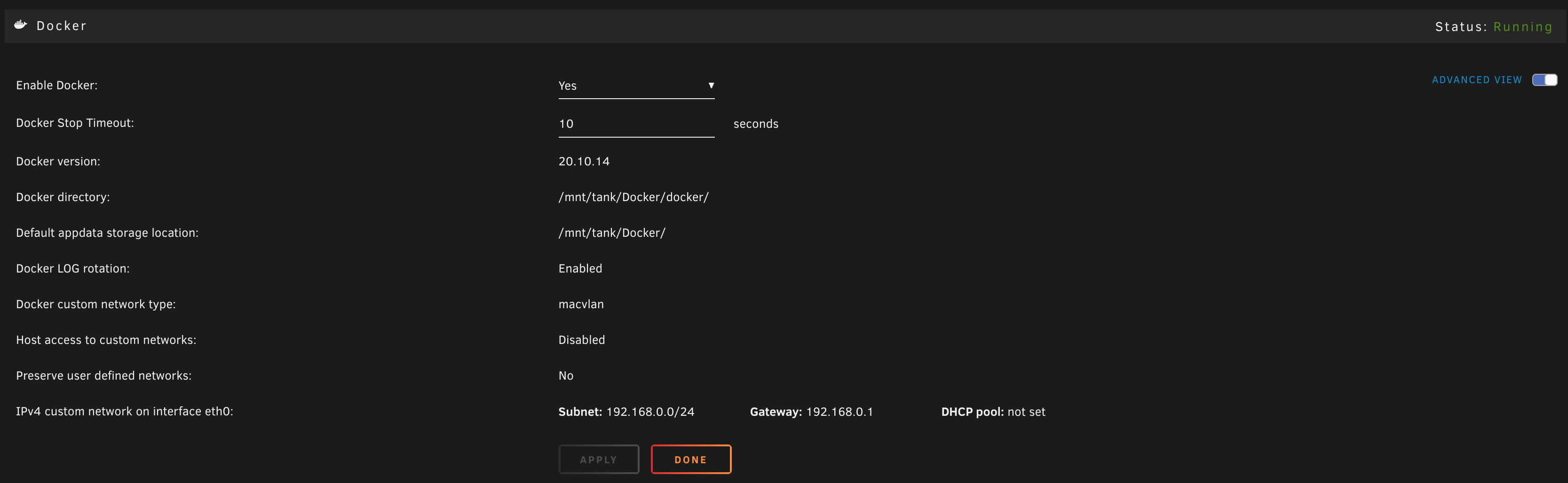

What particular settings should I adjust? I tried looking for it but there's 52 pages of stuff I've had to sift through, including the search function. Here are my settings under Settings\Docker.

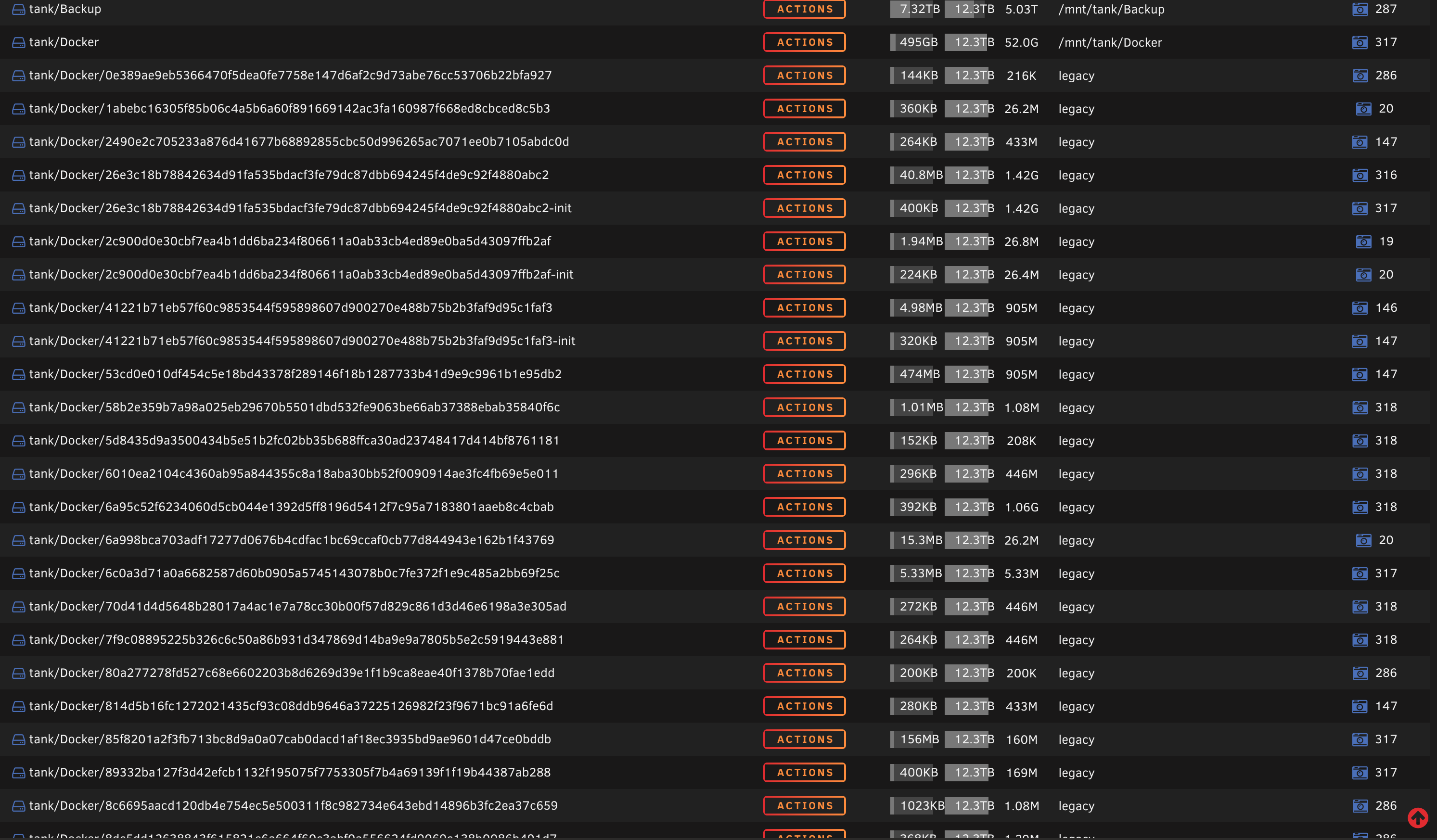

So the thing is I have the docker container img pointing to a docker dataset, but it makes its own datasets that look like this. I'm trying to get rid of them.
