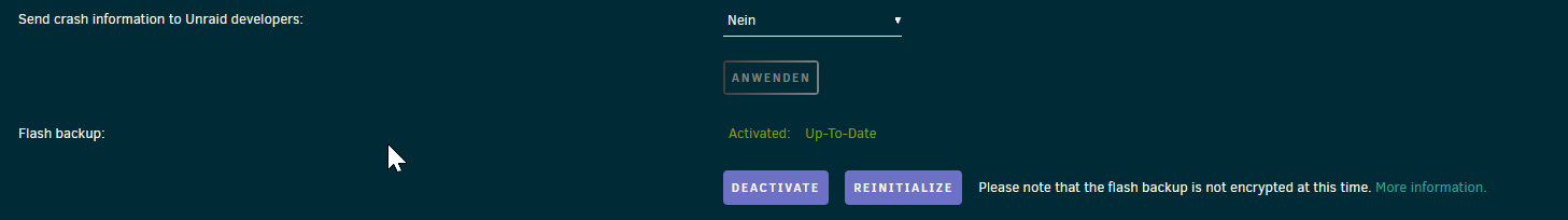

  6. I have another problem right now: When I go to my profile I got the following error: actual server - not connected to mothership?? What does that mean? I also get an error, that the Flash backup file doesn't work, why? In the settings/managing access menu I see that the backup is active? Best regards johannes

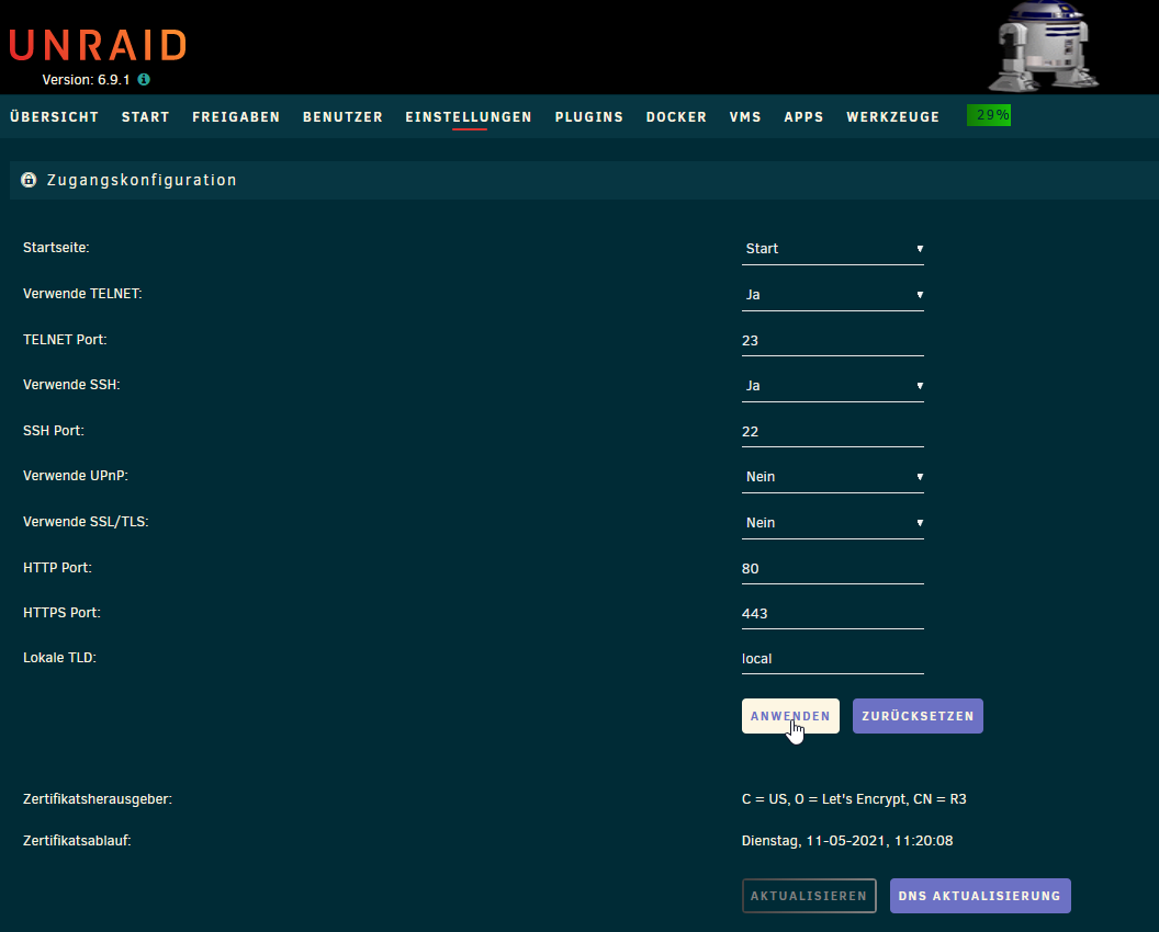

  8. I use the internal IP-Adresss to make the changes. (but I also tried from remote, without any success) I tried this, without success. I also tried to change the ident.cfg in /boot/config/ without success.
  9. I checked the tabs, only one open. Furthermore I tried another browser and deleting the cache and the incognito tab, without any improvement. I have a reverse proxy on port 443, but I can't change the unraid management-port to e.g. 10443, because I can't save the changes no problem, I have time

  12. Hello, I just wanted to configure the unraid.net plugin. But I realized, that I have to allow the remote access first (e.g. via https 10443). So I went into "management access" in the settings tab. Then I tried to change some of the values e.g. "Use SSL/TLS", "HTTP port", "HTTPS port", "Local TLD" but nothing changed after clicking on "apply". Nothing happens until I refreshed the hole browser-tab. Now any changes have been discard. Can you please support me? Best regards Johannes
