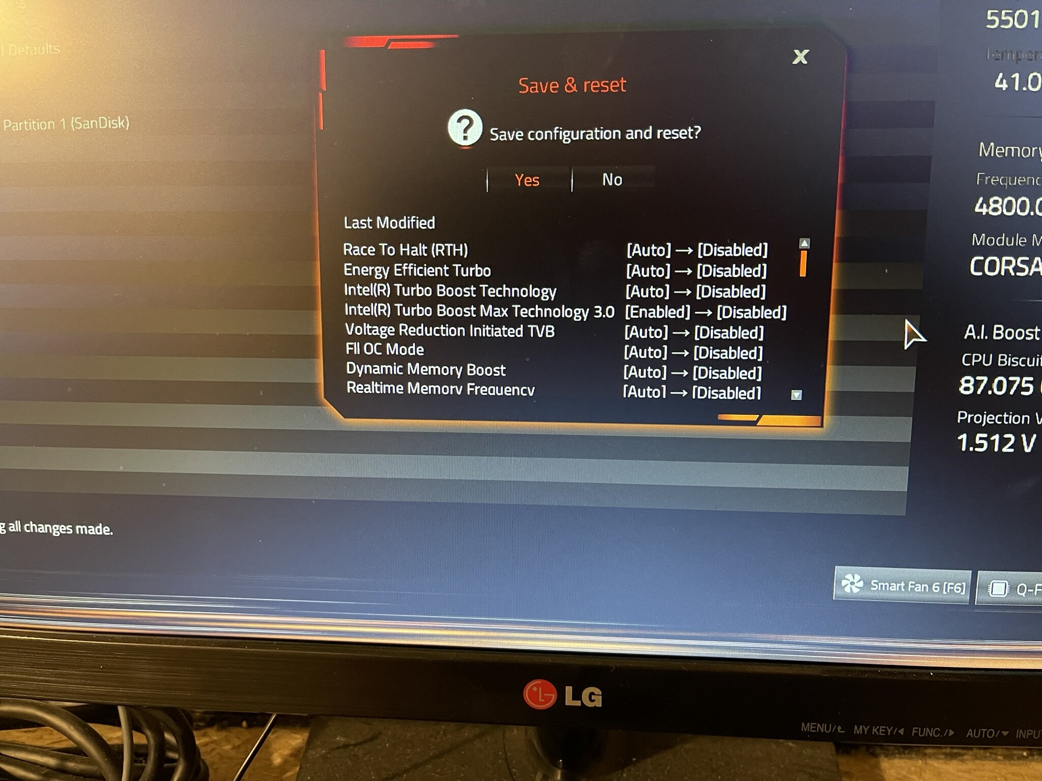

  3. I just thought I would give you an update on my system. After doing this I still had random reboots so I went back into the bios and made all the changes shown below and my server has been completely stable now for over 23 days. I went back in and set my memory profile back to xmp 1 and my server has been stable as well so you can run with the xmp profile. I don't know which of these settings fixed the issue. I know there is a problem with intel 13th and 14th gen cpu's, so I'm guessing that has something to do with the issue. I am currently running a beta version of the bios F11b, but since my server is completely stable I will wait for the final version to come out before updating. I hope this helps if someone is having the same issues I was having. My motherboard is an Asus z790 UD AC with a 14700K core i7.

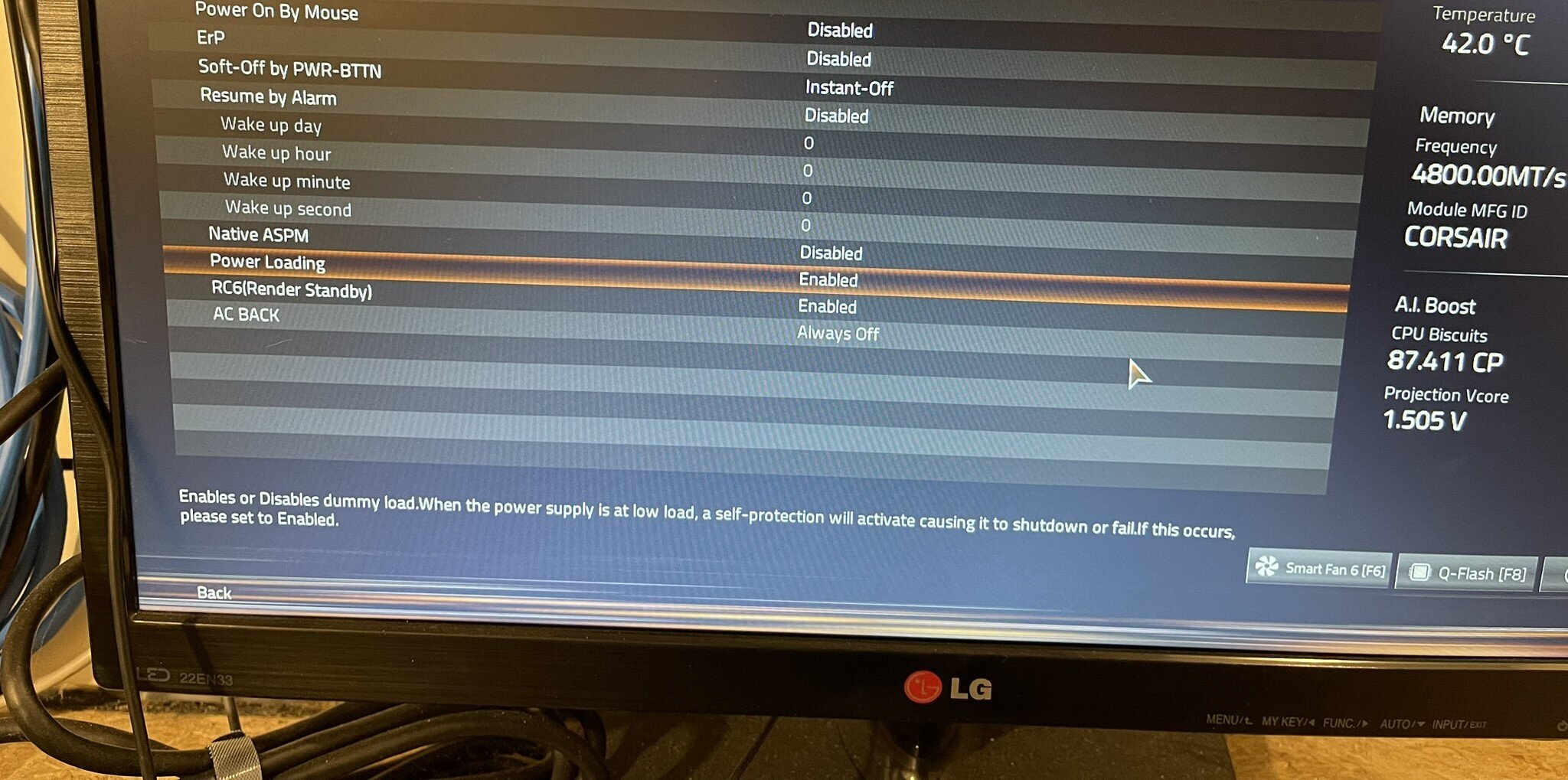

  4. I found the issue! I didn't want to pose until I tested the fix. My server has been running without issue for over a week, the fix came in a new beta bios for my motherboard, see the attachment. I'm still having some hard drive issues, but those issues are caused by my server. I am getting read errors on a drive and it keeps disabling. I took out the drive and ran a test on the drive and it has no issues so the connection in the server is going, this is the second drive that this is happening with. I got an external drive cage and put the "bad drive" in the cage and no more drive issues. So I am replacing this old server which will fix the drive issues. Anyway the solution for my original problem is the bios setting. Thanks for all the help

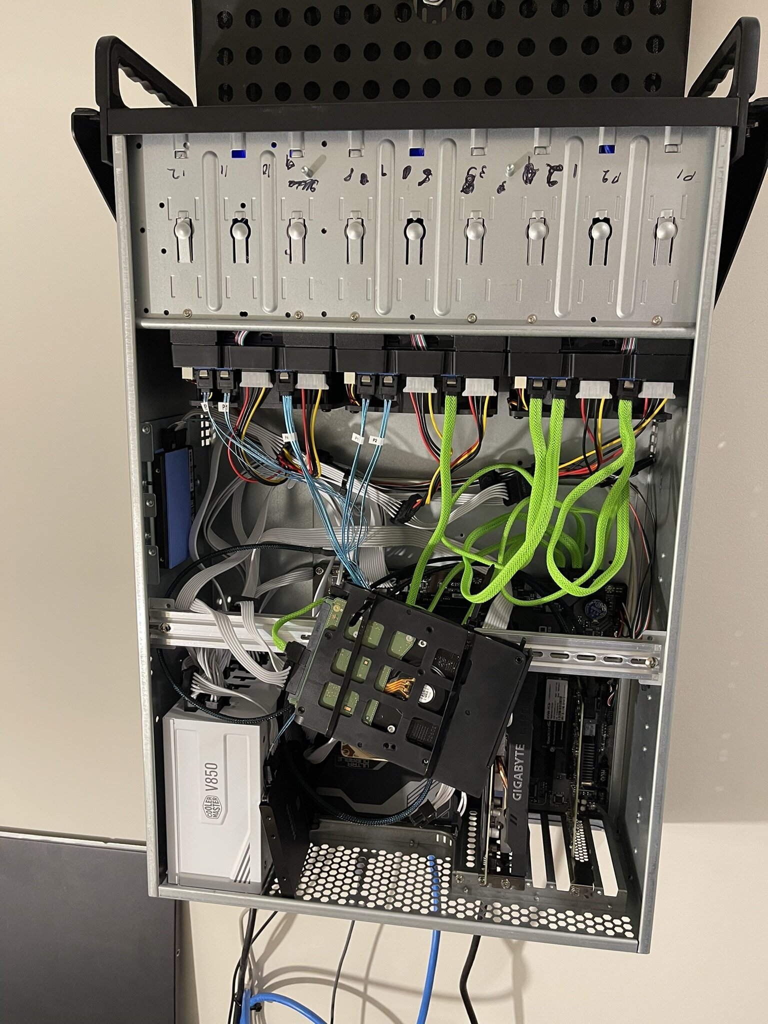

  14. Ok, I was trying to assign them to shares. How do I add to the number of array slots? Thanks
