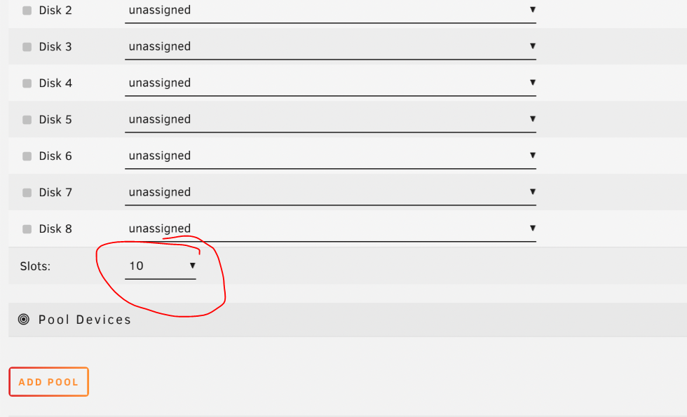

June 12, 20242 yr Community Expert Do you mean you cannot assign them to the array, or cannot assign them to shares? For the former make sure you increase the number of array slots. P.S. IMHO not much point of including all disks in global shares, if you then add new ones they won't show up in shares, unless you don't forget to add them.
June 12, 20242 yr Author Ok, I was trying to assign them to shares. How do I add to the number of array slots? Thanks
June 12, 20242 yr Author I not quite sure I understand, when the array is stopped, what slot number do I click to increase it? I only see the 10 array slots when I stop the array. Thanks
June 12, 20242 yr Author I don't know how I missed that! Thanks to all the help from everyone, I'm pretty sure my server is stable again!
