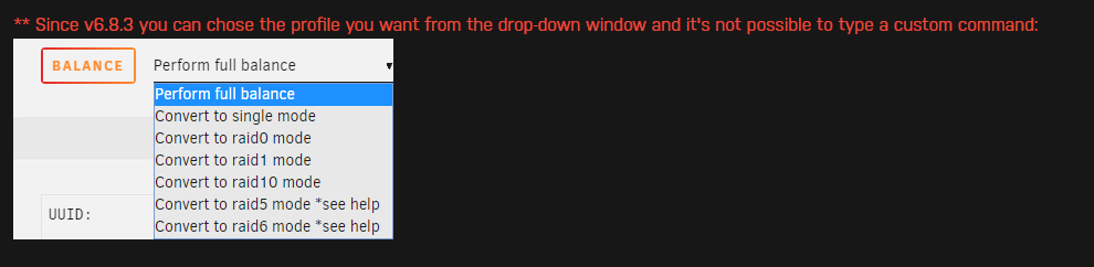

  1. Yep. I removed the appdata folder for one of the dockers, reinstalled, and I'm now able to access the docker. Is there a way to backup my data and somehow bring it over to the new docker or am I going to have to set up everything from scratch? Something probably of note: In my appdata folder, there were changes to the owner and permission fields with the new image. Owner changed from root to nobody and permission went from drwx------ to drwxrwxr-x. EDIT: Most of the dockers that aren't working match the old root / drwx------ and changing this (then restarting the docker) does allow access to the docker so I'm all set. Except for my Plex docker... which is already set to nobody / drwxrwxr-x. Not sure what to do about this one? EDIT: Something in the folder must have had different owner/permissions because I went ahead and "changed" it to nobody / drwxrwxr-x and after restarting it's working. Thanks for all of your help! While I've got you here... why don't I have the drop down options on my cache to convert it back to single mode? This is what started all of my problems: EDIT: For anyone that comes across this, I couldn't convert to single mode because I had already removed a disk from the pool. I added the disk back, balanced again, and then I was able to convert to single mode.

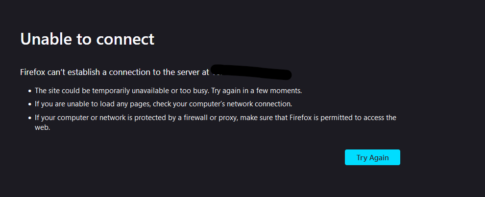

  3. This is what I see when I try to access the affected dockers:

  7. I'm trying to get my cache pool removed and, in preparation of this, I was moving everything off of my cache drive. Apparently this is a no-no and I only saw the error alert after it was too late and some of my appdata files had been moved. I moved them back to my cache but now I can't connect to any of the dockers. What's the fix for this?
