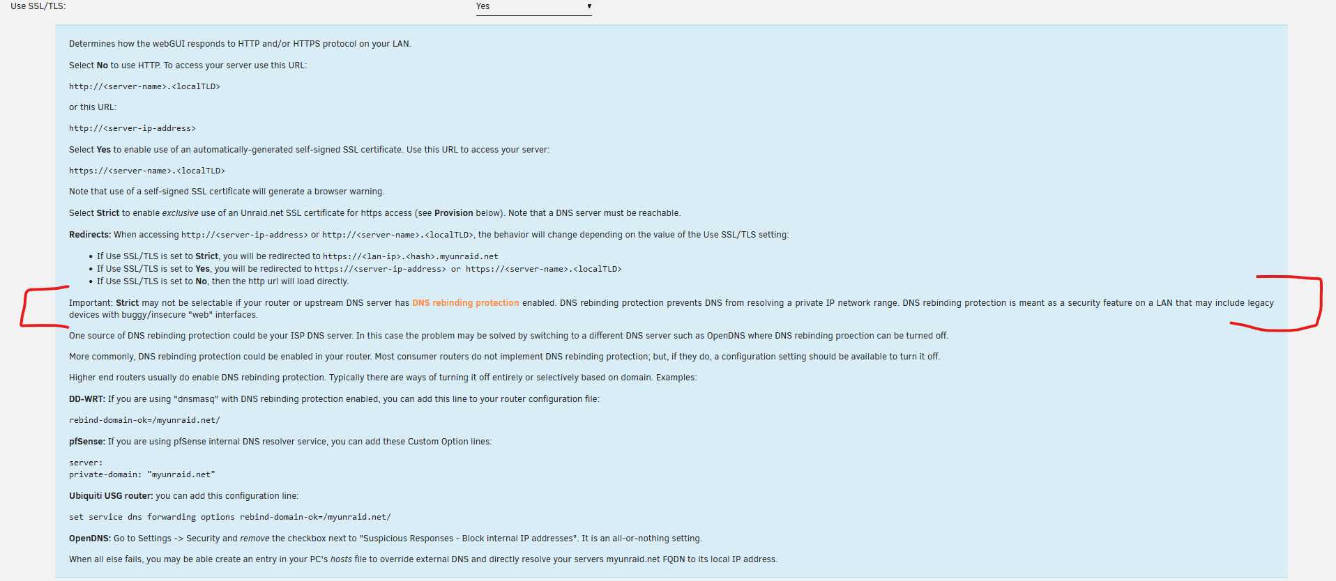

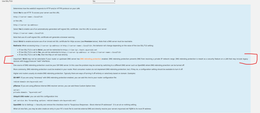

Make sure your Pihole does not have 'rebinding protection' turned on  off.  See below:
Edited by Frank1940
"Off" was "on"...
How do I do this without access to the server?
You make the change in Pihole's setup.   (If you  have set Pihole up on your Unraid server, you may well have a 'catch 22' situation.  (I seem to recall having seen that to be the case but I don't remember if there was a satisfactory solution...)
Bummer... I do have it set up on Unraid. I don't think it was set to strict based on the behaviors listed but this gives me something to go on though. I'll see what I can find. Thanks.
