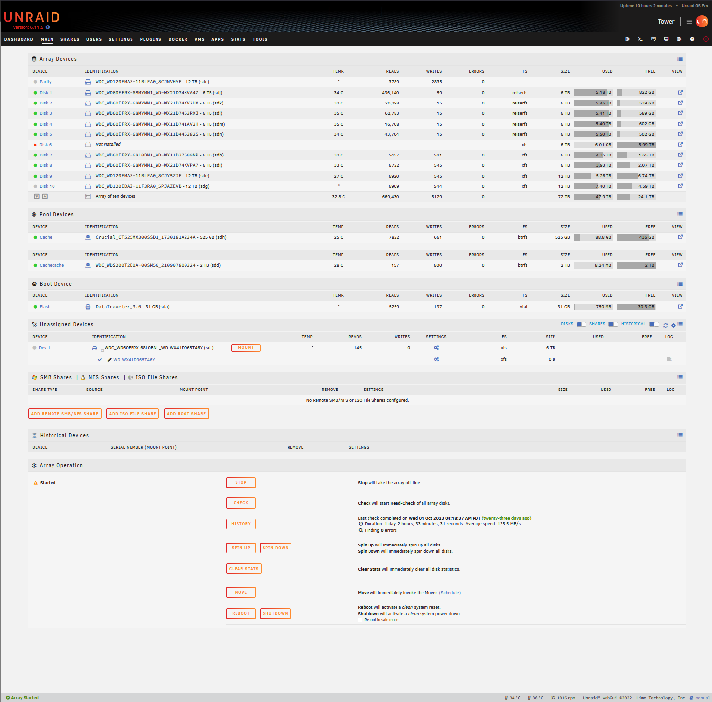

  1. That did the trick, parity sync is now in progress and no disk 6 listed on the main tab. I must have been a dummy and missed the checkbox. Thank you both, I really appreciate the help.
  2. Hmmm, I honestly can't remember. But what you describe could very well be the case. If that is the case, do I just repeat the steps above and make sure that I have that checkbox checked? The worry that I have is that drive is currently unassigned, do I need to reassign it first or just leave it unassigned? Hopefully that makes sense.
  3. Did I unassign Disk 6 incorrectly or something? Per your instructions in this post I did the following. Stopped the array Went to Tools -> New Config and chose All Set Disk 6 to unassigned Restarted the array Did I miss something?
  4. I don't see any kind of progress report or anything, it doesn't look like anything is happening which is why I am confused. Here is a diags. tower-diagnostics-20231027-1059.zip
  5. Thank you JorgeB, that did the trick.
  6. I was able to get this done thanks to JorgeB's help in this thread. The array is up and running but it says "Started, Array Unprotected", Is this normal behavior? I can see the read counts going up on Disk 1, is the system doing some kind of check/rebuild since I did the new config and the Array Unprotected status will go away when that is done? Is there another step that I need to do after restarting the array?
  7. I am trying to stop my array so that I can finish the process from this thread but pressing the stop button on the "Main" tab doesn't seem to be working. I can press the button, it's not grayed out or anything, but the array never stops. I doubt that this is relevant at all, but I figured I would include it anyway. Yesterday, the internet was down at my house from ~7am-5pm. Here is my diagnostics. Any help would be appreciated. tower-diagnostics-20231027-0826.zip
  8. Thanks again, I really appreciate the help!
  9. I just want to make sure that I do this right. I have moved all the data from the bad disk (Disk 6) to the good disk (Disk 10) using Unbalance. Do I the following: Stop the array Unassign Disk 6 Restart the array Tools -> New config Thank you JorgeB, you always seem to be the one coming through for me
  10. Thank you! I hate to be dumb but what do you mean by "then do a new config without it." Do you mean make sure any shares that used disk 6 (the bad disk) now use disk 10 (the good disk)?
  11. I have a disk that has been giving me some issues for the last couple months. You can see what has happened in my last couple of posts here and here The disc just got a red X again and this time I can't run a smart test on it. When I go to run the Smart test the button presses but then nothing happens and the button is pretty much immediately able to be pressed again. At this point, I think that I just want to remove the disk. The problem disk is a 6TB drive and I have a 12TB drive sitting in the array unused and all ready to go. What I am wondering is what is the best way of going about doing this? How do I transfer the data from the bad disk to a disk already existing in the array? If it helps, I have Unbalance and Krusader installed on the server. If the 6TB drive is still okay I can still it in my desktop and it won't go to waste. Thanks in advance for any guidance.
  12. Thank you for your help again JorgeB, you're a gentleman and a scholar. Rebuild is started, should take about 24 hours and then it's finger crossing time. Thanks again.
