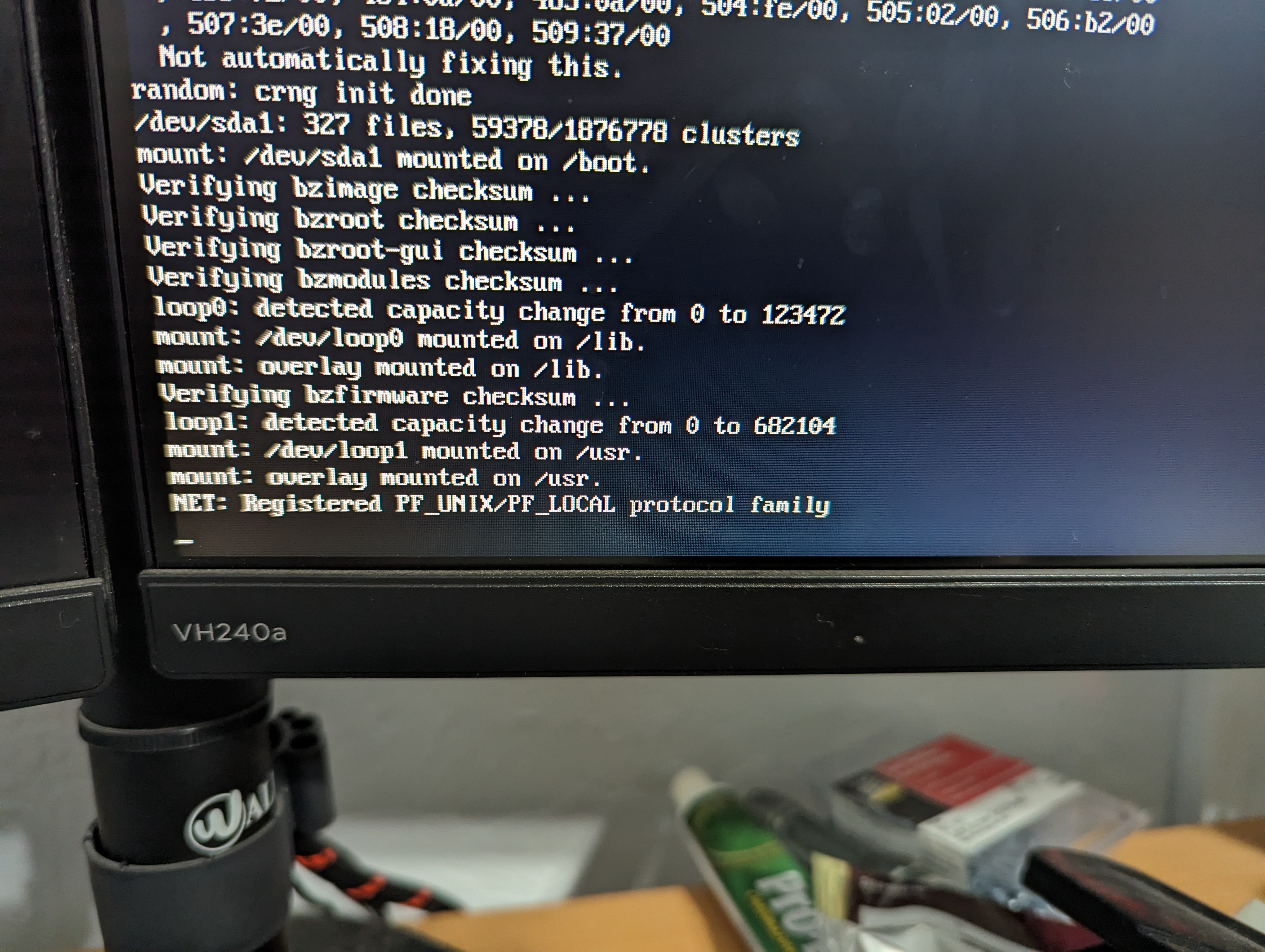

Ahh, I bet that is it. I'll try to swap to the HDMI port instead of the DP port on the GPU. Thank you so much for everything

Oh nice : ), I just started the rebuild, fingers crossed. The other error I am getting is the screen is frozen on this screen, (attached photo) Everything seems to work fine on Unraid though.
