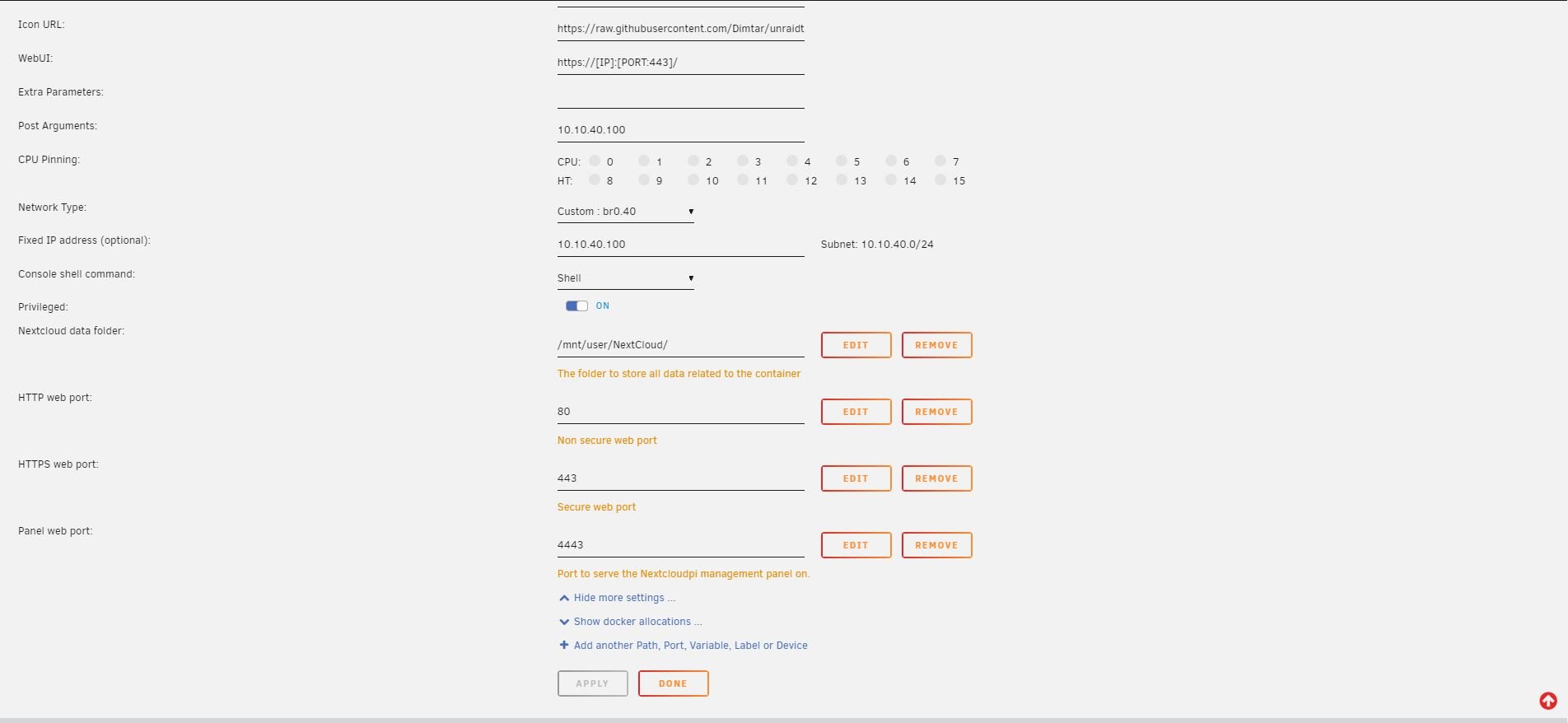

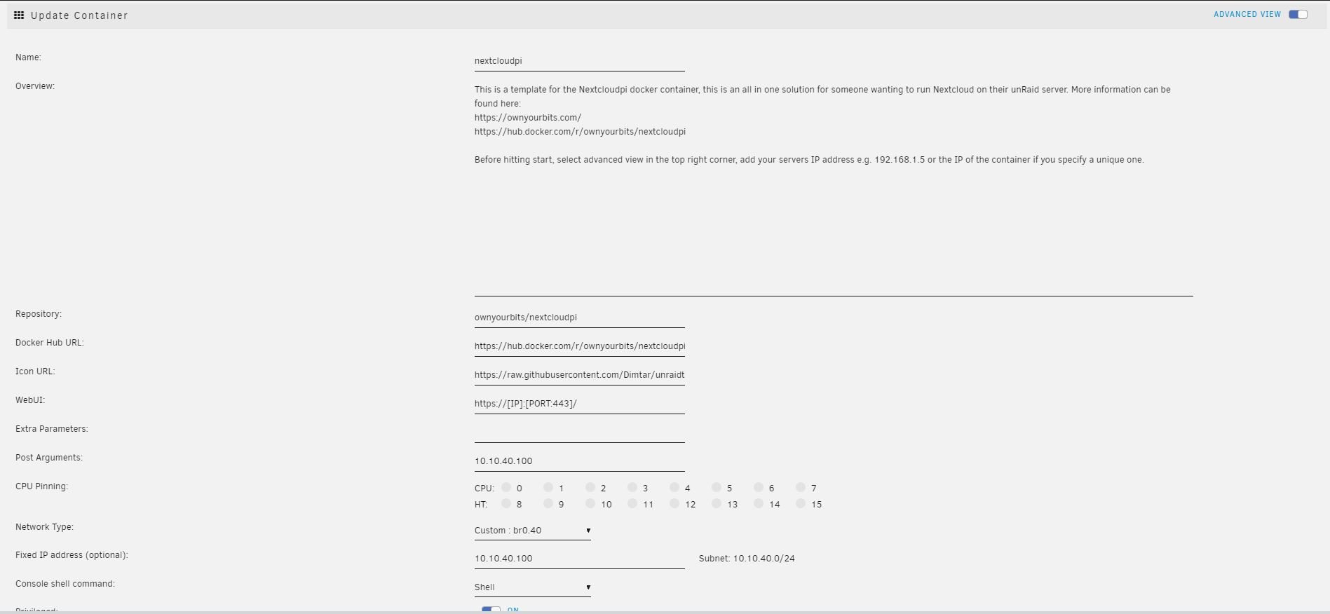

I'm not able to get to the web ui so far, I am sure I am doing something wrong, here is my setup: LOG: Starting PHP-fpm Starting Apache Starting mariaDB 2020-12-15 7:23:57 0 [Note] mysqld (mysqld 10.3.25-MariaDB-0+deb10u1) starting as process 223 ... Starting Redis Starting Cron Starting Postfix System config value trusted_domains => 1 set to string 10.10.40.100 System config value trusted_domains => 6 set to string 10.10.40.100 Provisioning Provisioning Redis password Updating NextCloud config with Redis password Provisioning MariaDB password Updating NextCloud config with MariaDB password Running nc-limits Using 25236667392B for PHP Using 16 PHP threads Using 8361890816 memory for the database Stopping MariaDB database server: mysqld. Starting MariaDB database server: mysqld .. Stopping redis-server: redis-server. Starting redis-server: redis-server. e
