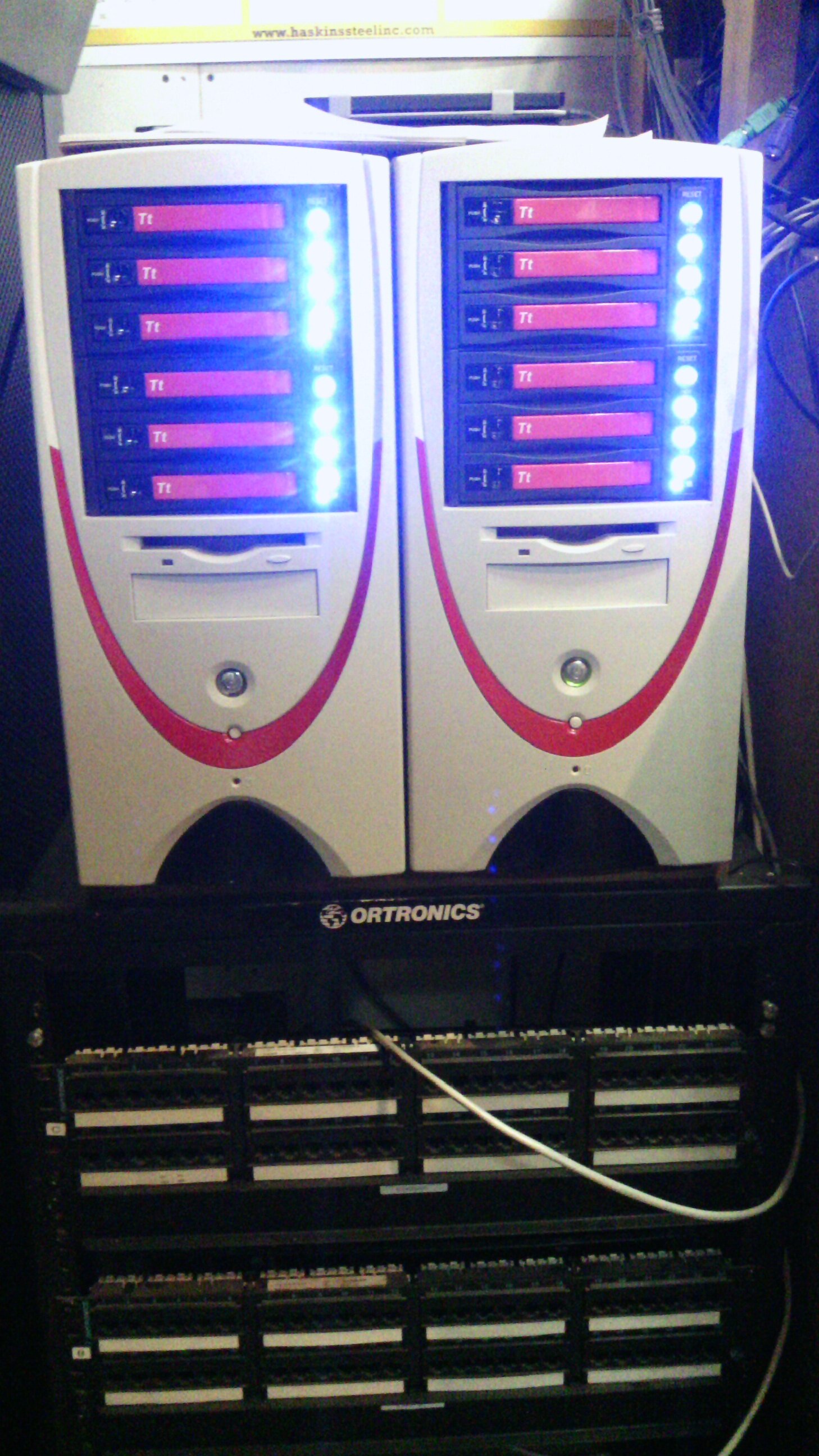

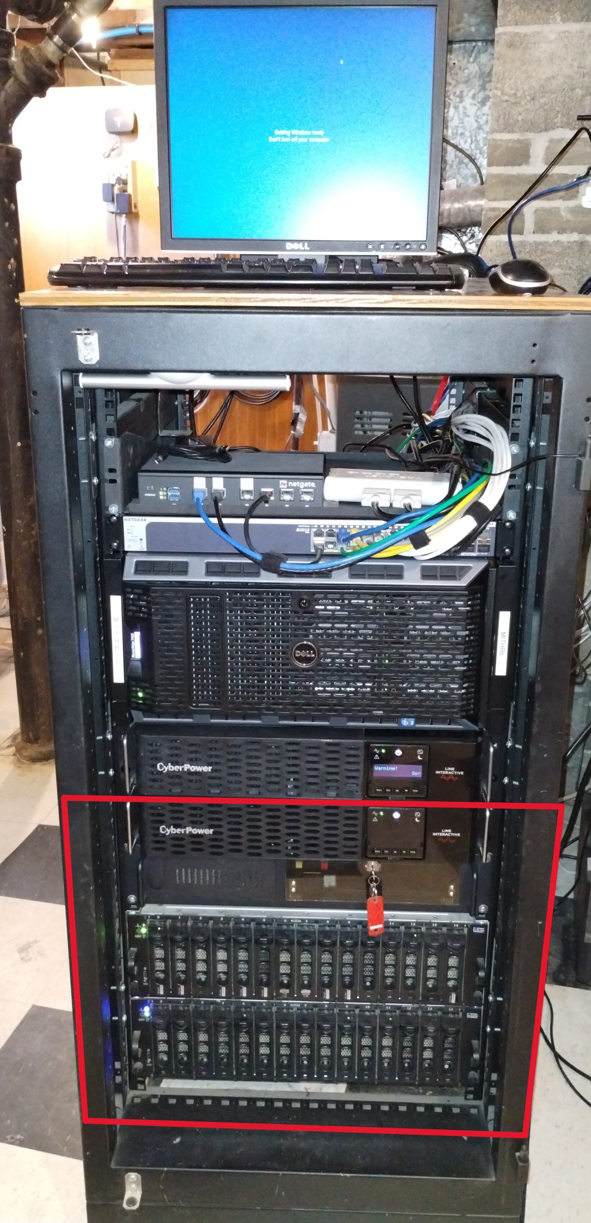

  1. Don't remember what my first OS version was, but I started sometime in 2013. Got my feet wet understanding the unraid system and went from there. My first real build was Frankenstein. 22 drives in two standard cases that were riveted together, with the side cutout between them for ventalation and cable access. Single Gigabyte motherboard with various SATA and IDE cards installed to make this patchwork. 12 drive front loading, with 10 more (5 in each case below the front loaders) for probably a max of 30TB at the time. Three power supplies inside to power all the drives and the mobo. Ran that configuration for around 3 years. Frankenstein: After that got full I started building out "Bride of Frankenstein". 30 drives (2 parity) in 2 DAS units, with 2 cache SSD's in the main 2U server (red tag). Currently sitting at 100TB capacity with 20TB more to go. I'm about 80% full in just media. Bride of Frankenstein: (in red area) I have 2 other unraid servers that I had to move my music and photos off of "Bride" to make room for more media. Needless to say I have a problem ;-)
