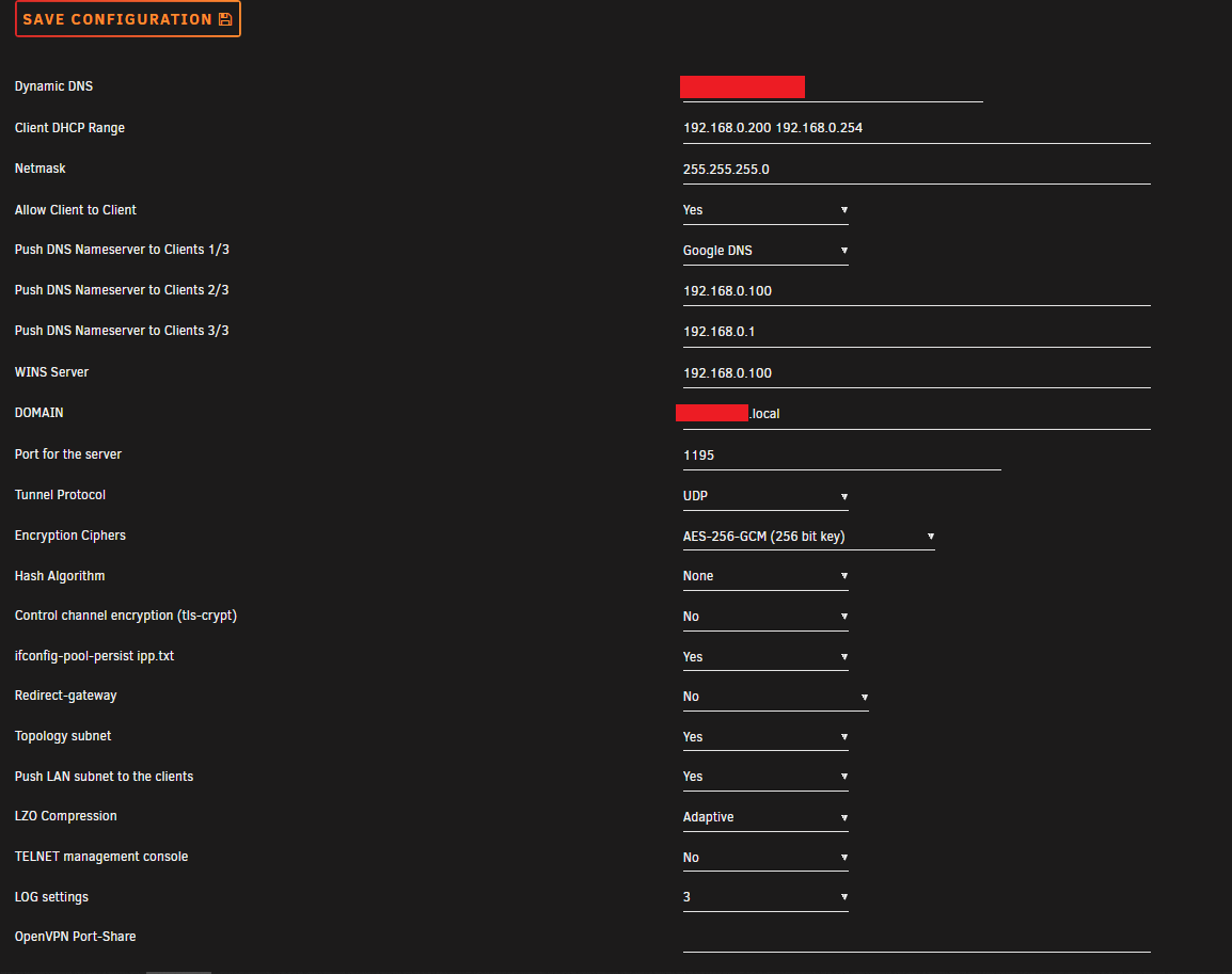

Your Lan Gateway should be your Router (Single IP) And your Client DHCP Range need to be in the same Subnet. Try DHCP Range 192.168.10.200 192.168.10.254. Please take a look at your dhcp Range from your Router and Free that Range.

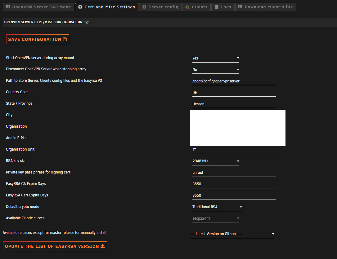

Hi there, I would like to point out again that I forked the petersm1 project on GitHub a long time ago. I modified the plugin, It now uses Layer 2 (tab device) by default, i.e. a network bridge to the existing br0 in Unraid. If you prefer layer 3, i.e. a routed network, you should switch to Wireguard or something similar. Layer 2 has the advantage that it is seen like a "real" LAN cable, broadcast etc. comes through, I personally use it to connect with my friends online and to be able to play classic "LAN" Games together. However, if you want to access with Android, you need the app "openvpn pro", because android can only emulate tap without being routed, which is also the only app that I know of. Windows, Linux and Mac have no problems whatsoever. openvpn 2.4.9 is used, The easyrsa installation has also been fixed. who wants to start openvpn automatically after a system restart (without a started array because it is encrypted) can add that to /boot/config/go : ##OPENVPN-SERVER source /boot/config/plugins/openvpnserver/openvpnserver_cert.cfg logger "Starting OpenVPN Server" /usr/local/emhttp/plugins/openvpnserver/scripts/rc.openvpnserver start | logger https://github.com/DeBaschdi/openvpnserver Plugin : https://raw.githubusercontent.com/DeBaschdi/openvpnserver/master/openvpn_server_x64.plg

Hello everybody, Some time ago I forked the petersm1 Project on Github, modified the Code to be able to use a bridged tap instead of tun. (layer 2). This works good, but everyone has to be aware that Layer 2 has a bit more overheat, I modified it to be able to use Lan Games which use a broadcast. Also, Layer 2 (tap device) does not work under Android, but there is a paid APP that emulates the tap device. You can find my Fork here: https://github.com/DeBaschdi/openvpnserver

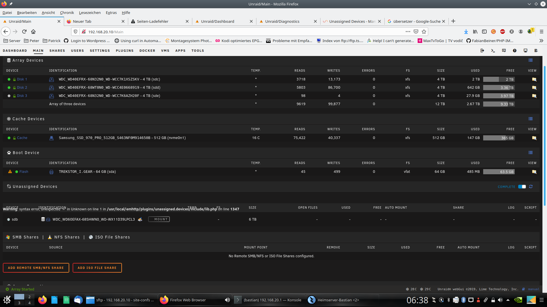

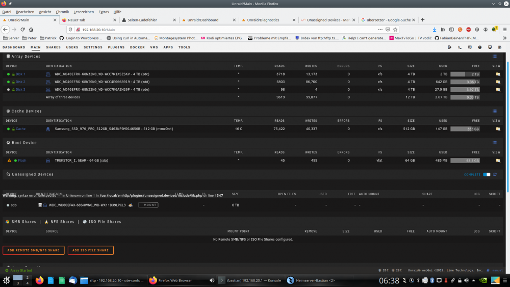

Hi, unassigned Devices don´t work'for me, it displays in maintab "Warning: syntax error, unexpected '=' in Unknown on line 1 in /usr/local/emhttp/plugins/unassigned.devices/include/lib.php on line 1349" can u help me ? unraid-diagnostics-20191214-1734.zip
