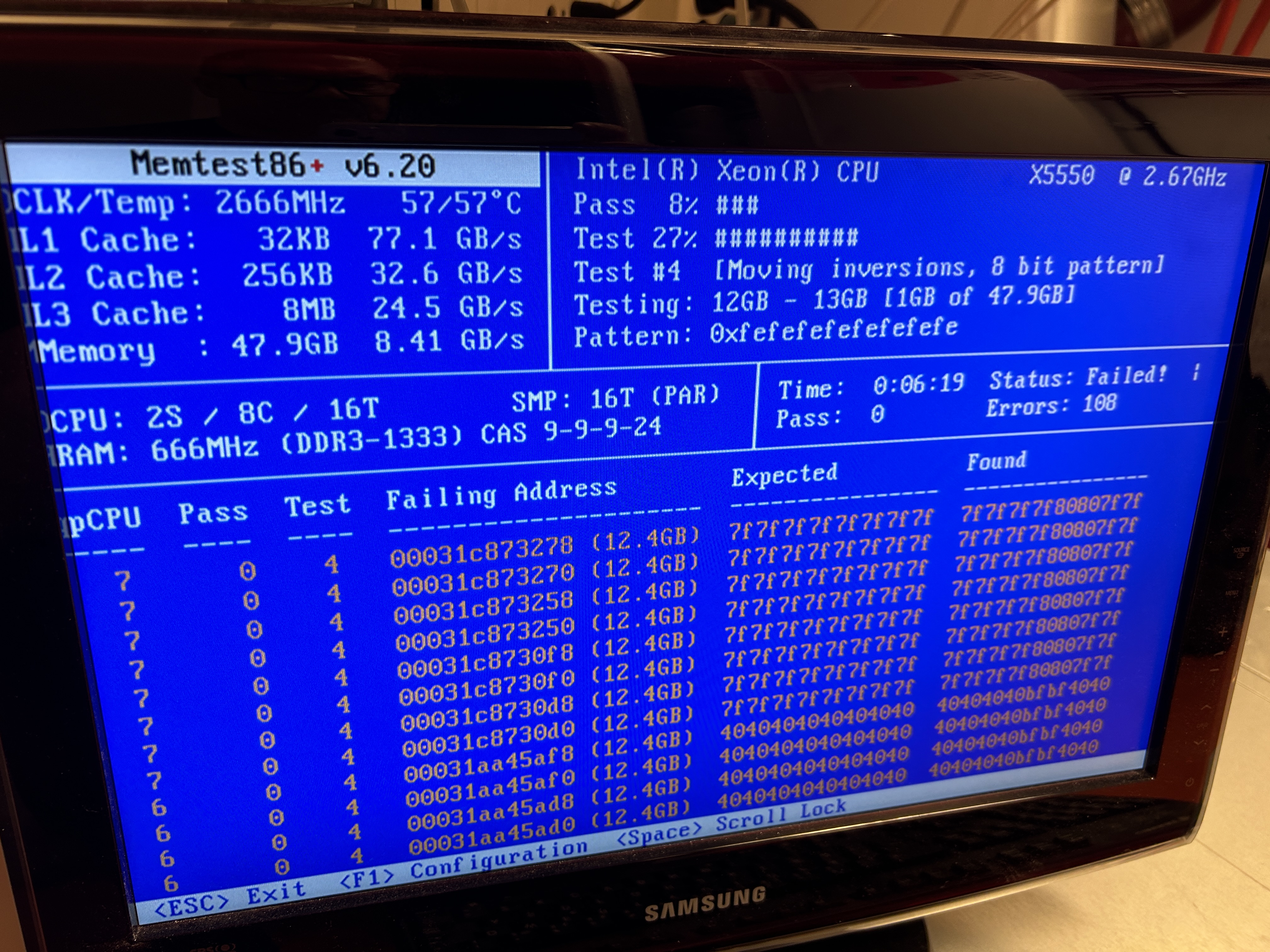

  1. Thanks so much for the help everyone. The RAM stick was the issue, so now it's working fine again. Again many thanks for the help, it really much appreciated. Cheers, Kjetil

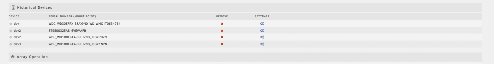

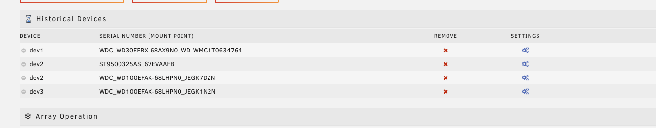

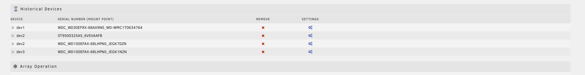

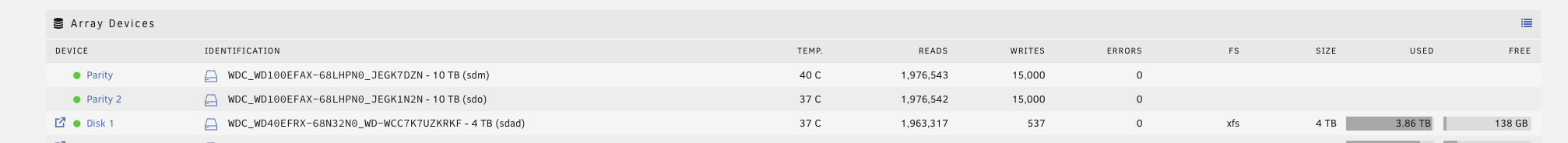

  2. Ok, removed some RAM sticks and now the test ran without any errors. But what about the discs? Why are some of the active discs also listed as "historical devices" ? Do I need to take any action here?

  4. Test 1, 2, 3 went ok, test 4 shows errors and the test freezes
  5. The test shows errors, but I don't know how to interprete them... photo enclosed.
  6. Thanks everyone, will do a test now

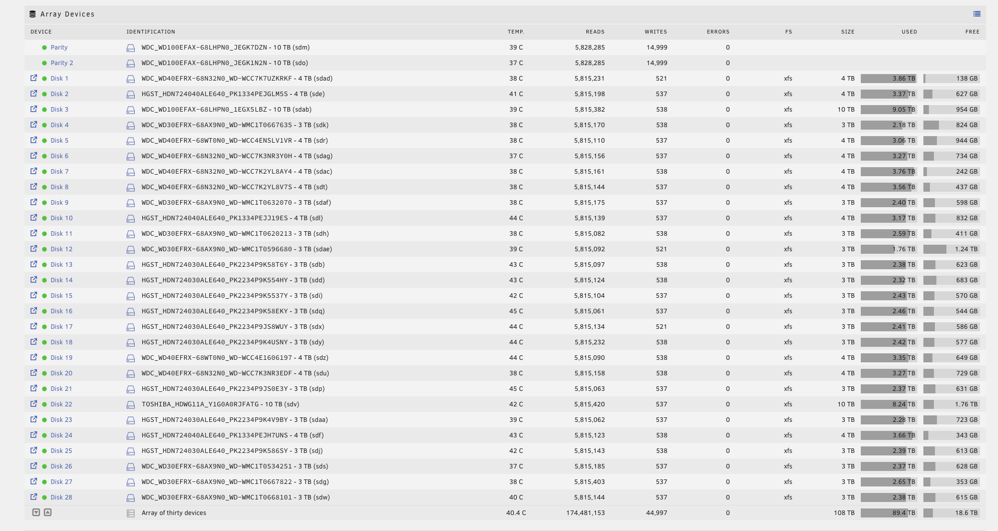

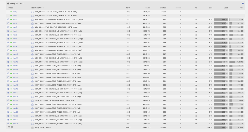

  10. Hello Having big issues with my Unraid, it has started to drop of the network and freeze after some 5-10 minutes uptime. Can also not access it directly with keyboard and monitor connected directly to the server. Sometime the screen is just black, sometimes a frozen Unraid window appears. Enclosing a diagnostic here, not sure if it's helpful. I am not a tech guy so not sure what to do. I saw today that several of the discs that is part of the raid says historical discs even if they are part of the raid. Can this be the reason for the issue? Should I do anything with the settings on these? All help is much appreciated. Thank you. federalreserve-diagnostics-20240118-1320.zip

  14. Rebuilt parity, so now it's working. Thanks for your help JorgeB 😊
