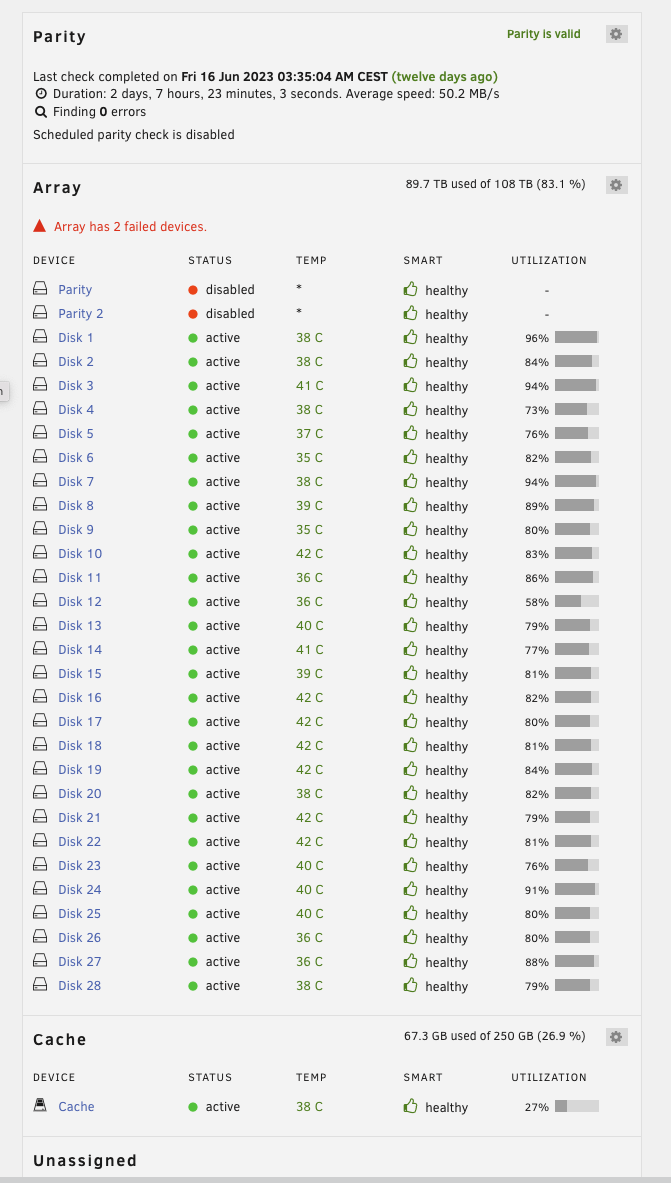

Rebuilt parity, so now it's working. Thanks for your help JorgeB 😊

So I remove the two parity discs by choosing "no device", then start and stop the array, then reassign the two discs, and start the array again in maintenance mode (choosing sync to rebuild) ?

Hello everyone Logged onto unraid today and saw an error message, parity disabled. So I took a diagnostic and shut down unraid. I add the diagnostics here. Disregard the error messages for the UPS, its disconnected but I have not updated unraid. What to do now? Start up the raid again ? Or boot in safety mode? I am not tech savy so hoping someone can help with fairly detailed descriptions.... I did a parity check a few weeks ago, showed no errors. And have not had disc error messages either. Very thankful for any help. Kind regards, Kjetil federalreserve-diagnostics-20230628-1043.zip
