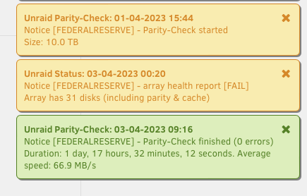

Hello,
I just got a message that "array health rapport (fail)", during a parity check.
Had a power out in the house.
Parity check said zero errors.
The diagnostics are added here. Would be great if someone more knowledgeable than me
could have a look to see if all is ok, or if something need attention.
Cheers, Kjetil

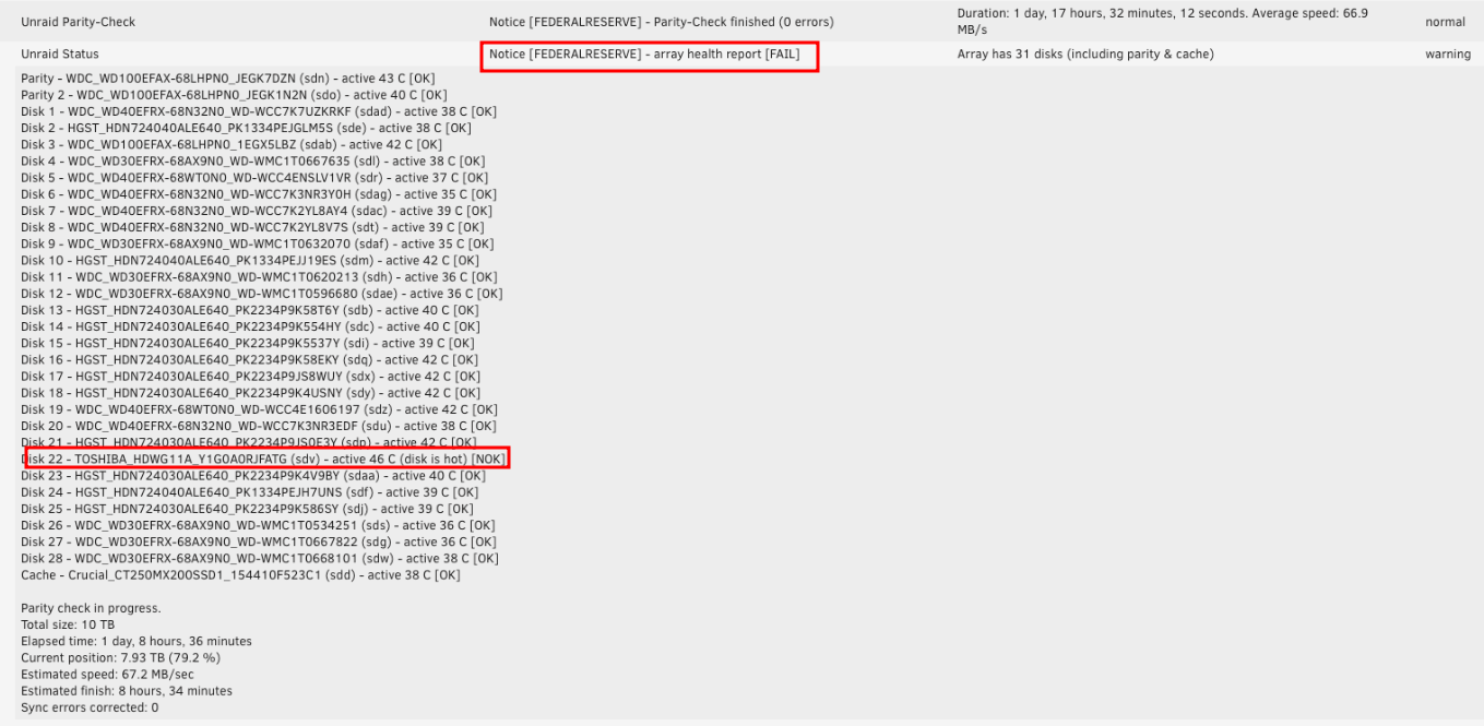

Post the complete array status report, there should be more info there.
Hi Jorge.
Where can I find the complete array status rapport?
Cheers, Kjetil

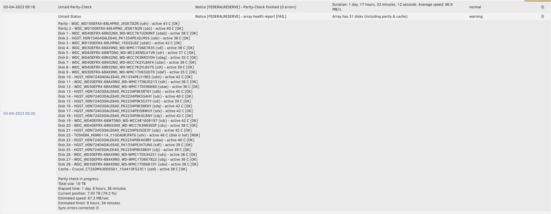

Tools -> Archived Notifications, then click on the date/time of the last one to expand.
Thank you. Here is a copy of the last message, I found no way to download it, so I took a screenshot. Same message as before.
Could it be that one of the disks was hot during the test? I read on the forum that a hot disk might make the status rapport fail.
This is the problem, improve cooling or set a higher warning temp for this disk.
One of your drives is running hot, and yes - most likely when the validation happened your drives were above the 45C threshold. A recommendation given above is valid, improve air flow - you want your drives running cool.
