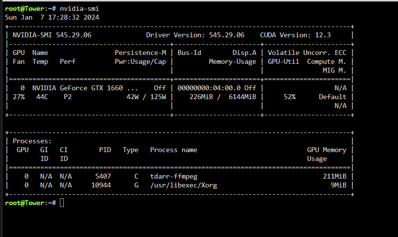

  5. Here is another image showing nvidia-smi when the GPU is in use through tdarr, but still not being properly shown in the GPU Stats dashboard tile.
  6. root@Tower:~# nvidia-smi -q -x -g GPU-74a690f4-8a5b-ec41-d40a-39f7687a2940 <?xml version="1.0" ?> <!DOCTYPE nvidia_smi_log SYSTEM "nvsmi_device_v12.dtd"> <nvidia_smi_log> <timestamp>Sun Jan 7 14:12:58 2024</timestamp> <driver_version>545.29.06</driver_version> <cuda_version>12.3</cuda_version> <attached_gpus>1</attached_gpus> <gpu id="00000000:04:00.0"> <product_name>NVIDIA GeForce GTX 1660 SUPER</product_name> <product_brand>GeForce</product_brand> <product_architecture>Turing</product_architecture> <display_mode>Disabled</display_mode> <display_active>Disabled</display_active> <persistence_mode>Disabled</persistence_mode> <addressing_mode>None</addressing_mode> <mig_mode> <current_mig>N/A</current_mig> <pending_mig>N/A</pending_mig> </mig_mode> <mig_devices> None </mig_devices> <accounting_mode>Disabled</accounting_mode> <accounting_mode_buffer_size>4000</accounting_mode_buffer_size> <driver_model> <current_dm>N/A</current_dm> <pending_dm>N/A</pending_dm> </driver_model> <serial>N/A</serial> <uuid>GPU-74a690f4-8a5b-ec41-d40a-39f7687a2940</uuid> <minor_number>0</minor_number> <vbios_version>90.16.48.00.7E</vbios_version> <multigpu_board>No</multigpu_board> <board_id>0x400</board_id> <board_part_number>N/A</board_part_number> <gpu_part_number>21C4-300-A1</gpu_part_number> <gpu_fru_part_number>N/A</gpu_fru_part_number> <gpu_module_id>1</gpu_module_id> <inforom_version> <img_version>G001.0000.02.04</img_version> <oem_object>1.1</oem_object> <ecc_object>N/A</ecc_object> <pwr_object>N/A</pwr_object> </inforom_version> <inforom_bbx_flush> <latest_timestamp>N/A</latest_timestamp> <latest_duration>N/A</latest_duration> </inforom_bbx_flush> <gpu_operation_mode> <current_gom>N/A</current_gom> <pending_gom>N/A</pending_gom> </gpu_operation_mode> <gsp_firmware_version>N/A</gsp_firmware_version> <c2c_mode>N/A</c2c_mode> <gpu_virtualization_mode> <virtualization_mode>None</virtualization_mode> <host_vgpu_mode>N/A</host_vgpu_mode> </gpu_virtualization_mode> <gpu_reset_status> <reset_required>No</reset_required> <drain_and_reset_recommended>N/A</drain_and_reset_recommended> </gpu_reset_status> <ibmnpu> <relaxed_ordering_mode>N/A</relaxed_ordering_mode> </ibmnpu> <pci> <pci_bus>04</pci_bus> <pci_device>00</pci_device> <pci_domain>0000</pci_domain> <pci_device_id>21C410DE</pci_device_id> <pci_bus_id>00000000:04:00.0</pci_bus_id> <pci_sub_system_id>87871043</pci_sub_system_id> <pci_gpu_link_info> <pcie_gen> <max_link_gen>3</max_link_gen> <current_link_gen>1</current_link_gen> <device_current_link_gen>1</device_current_link_gen> <max_device_link_gen>3</max_device_link_gen> <max_host_link_gen>3</max_host_link_gen> </pcie_gen> <link_widths> <max_link_width>16x</max_link_width> <current_link_width>4x</current_link_width> </link_widths> </pci_gpu_link_info> <pci_bridge_chip> <bridge_chip_type>N/A</bridge_chip_type> <bridge_chip_fw>N/A</bridge_chip_fw> </pci_bridge_chip> <replay_counter>0</replay_counter> <replay_rollover_counter>0</replay_rollover_counter> <tx_util>0 KB/s</tx_util> <rx_util>0 KB/s</rx_util> <atomic_caps_inbound>N/A</atomic_caps_inbound> <atomic_caps_outbound>N/A</atomic_caps_outbound> </pci> <fan_speed>27 %</fan_speed> <performance_state>P8</performance_state> <clocks_event_reasons> <clocks_event_reason_gpu_idle>Active</clocks_event_reason_gpu_idle> <clocks_event_reason_applications_clocks_setting>Not Active</clocks_event_reason_applications_clocks_setting> <clocks_event_reason_sw_power_cap>Not Active</clocks_event_reason_sw_power_cap> <clocks_event_reason_hw_slowdown>Not Active</clocks_event_reason_hw_slowdown> <clocks_event_reason_hw_thermal_slowdown>Not Active</clocks_event_reason_hw_thermal_slowdown> <clocks_event_reason_hw_power_brake_slowdown>Not Active</clocks_event_reason_hw_power_brake_slowdown> <clocks_event_reason_sync_boost>Not Active</clocks_event_reason_sync_boost> <clocks_event_reason_sw_thermal_slowdown>Not Active</clocks_event_reason_sw_thermal_slowdown> <clocks_event_reason_display_clocks_setting>Not Active</clocks_event_reason_display_clocks_setting> </clocks_event_reasons> <fb_memory_usage> <total>6144 MiB</total> <reserved>207 MiB</reserved> <used>14 MiB</used> <free>5922 MiB</free> </fb_memory_usage> <bar1_memory_usage> <total>256 MiB</total> <used>5 MiB</used> <free>251 MiB</free> </bar1_memory_usage> <cc_protected_memory_usage> <total>0 MiB</total> <used>0 MiB</used> <free>0 MiB</free> </cc_protected_memory_usage> <compute_mode>Default</compute_mode> <utilization> <gpu_util>0 %</gpu_util> <memory_util>0 %</memory_util> <encoder_util>0 %</encoder_util> <decoder_util>0 %</decoder_util> <jpeg_util>0 %</jpeg_util> <ofa_util>0 %</ofa_util> </utilization> <encoder_stats> <session_count>0</session_count> <average_fps>0</average_fps> <average_latency>0</average_latency> </encoder_stats> <fbc_stats> <session_count>0</session_count> <average_fps>0</average_fps> <average_latency>0</average_latency> </fbc_stats> <ecc_mode> <current_ecc>N/A</current_ecc> <pending_ecc>N/A</pending_ecc> </ecc_mode> <ecc_errors> <volatile> <sram_correctable>N/A</sram_correctable> <sram_uncorrectable>N/A</sram_uncorrectable> <dram_correctable>N/A</dram_correctable> <dram_uncorrectable>N/A</dram_uncorrectable> </volatile> <aggregate> <sram_correctable>N/A</sram_correctable> <sram_uncorrectable>N/A</sram_uncorrectable> <dram_correctable>N/A</dram_correctable> <dram_uncorrectable>N/A</dram_uncorrectable> </aggregate> </ecc_errors> <retired_pages> <multiple_single_bit_retirement> <retired_count>N/A</retired_count> <retired_pagelist>N/A</retired_pagelist> </multiple_single_bit_retirement> <double_bit_retirement> <retired_count>N/A</retired_count> <retired_pagelist>N/A</retired_pagelist> </double_bit_retirement> <pending_blacklist>N/A</pending_blacklist> <pending_retirement>N/A</pending_retirement> </retired_pages> <remapped_rows>N/A</remapped_rows> <temperature> <gpu_temp>33 C</gpu_temp> <gpu_temp_tlimit>N/A</gpu_temp_tlimit> <gpu_temp_max_threshold>96 C</gpu_temp_max_threshold> <gpu_temp_slow_threshold>93 C</gpu_temp_slow_threshold> <gpu_temp_max_gpu_threshold>91 C</gpu_temp_max_gpu_threshold> <gpu_target_temperature>83 C</gpu_target_temperature> <memory_temp>N/A</memory_temp> <gpu_temp_max_mem_threshold>N/A</gpu_temp_max_mem_threshold> </temperature> <supported_gpu_target_temp> <gpu_target_temp_min>65 C</gpu_target_temp_min> <gpu_target_temp_max>90 C</gpu_target_temp_max> </supported_gpu_target_temp> <gpu_power_readings> <power_state>P8</power_state> <power_draw>4.44 W</power_draw> <current_power_limit>125.00 W</current_power_limit> <requested_power_limit>125.00 W</requested_power_limit> <default_power_limit>125.00 W</default_power_limit> <min_power_limit>70.00 W</min_power_limit> <max_power_limit>150.00 W</max_power_limit> </gpu_power_readings> <gpu_memory_power_readings> <power_draw>N/A</power_draw> </gpu_memory_power_readings> <module_power_readings> <power_state>P8</power_state> <power_draw>N/A</power_draw> <current_power_limit>N/A</current_power_limit> <requested_power_limit>N/A</requested_power_limit> <default_power_limit>N/A</default_power_limit> <min_power_limit>N/A</min_power_limit> <max_power_limit>N/A</max_power_limit> </module_power_readings> <clocks> <graphics_clock>300 MHz</graphics_clock> <sm_clock>300 MHz</sm_clock> <mem_clock>405 MHz</mem_clock> <video_clock>540 MHz</video_clock> </clocks> <applications_clocks> <graphics_clock>N/A</graphics_clock> <mem_clock>N/A</mem_clock> </applications_clocks> <default_applications_clocks> <graphics_clock>N/A</graphics_clock> <mem_clock>N/A</mem_clock> </default_applications_clocks> <deferred_clocks> <mem_clock>N/A</mem_clock> </deferred_clocks> <max_clocks> <graphics_clock>2130 MHz</graphics_clock> <sm_clock>2130 MHz</sm_clock> <mem_clock>7001 MHz</mem_clock> <video_clock>1950 MHz</video_clock> </max_clocks> <max_customer_boost_clocks> <graphics_clock>N/A</graphics_clock> </max_customer_boost_clocks> <clock_policy> <auto_boost>N/A</auto_boost> <auto_boost_default>N/A</auto_boost_default> </clock_policy> <voltage> <graphics_volt>N/A</graphics_volt> </voltage> <fabric> <state>N/A</state> <status>N/A</status> </fabric> <supported_clocks> <supported_mem_clock> <value>7001 MHz</value> <supported_graphics_clock>2130 MHz</supported_graphics_clock> <supported_graphics_clock>2115 MHz</supported_graphics_clock> <supported_graphics_clock>2100 MHz</supported_graphics_clock> <supported_graphics_clock>2085 MHz</supported_graphics_clock> <supported_graphics_clock>2070 MHz</supported_graphics_clock> <supported_graphics_clock>2055 MHz</supported_graphics_clock> <supported_graphics_clock>2040 MHz</supported_graphics_clock> <supported_graphics_clock>2025 MHz</supported_graphics_clock> <supported_graphics_clock>2010 MHz</supported_graphics_clock> <supported_graphics_clock>1995 MHz</supported_graphics_clock> <supported_graphics_clock>1980 MHz</supported_graphics_clock> <supported_graphics_clock>1965 MHz</supported_graphics_clock> <supported_graphics_clock>1950 MHz</supported_graphics_clock> <supported_graphics_clock>1935 MHz</supported_graphics_clock> <supported_graphics_clock>1920 MHz</supported_graphics_clock> <supported_graphics_clock>1905 MHz</supported_graphics_clock> <supported_graphics_clock>1890 MHz</supported_graphics_clock> <supported_graphics_clock>1875 MHz</supported_graphics_clock> <supported_graphics_clock>1860 MHz</supported_graphics_clock> <supported_graphics_clock>1845 MHz</supported_graphics_clock> <supported_graphics_clock>1830 MHz</supported_graphics_clock> <supported_graphics_clock>1815 MHz</supported_graphics_clock> <supported_graphics_clock>1800 MHz</supported_graphics_clock> <supported_graphics_clock>1785 MHz</supported_graphics_clock> <supported_graphics_clock>1770 MHz</supported_graphics_clock> <supported_graphics_clock>1755 MHz</supported_graphics_clock> <supported_graphics_clock>1740 MHz</supported_graphics_clock> <supported_graphics_clock>1725 MHz</supported_graphics_clock> <supported_graphics_clock>1710 MHz</supported_graphics_clock> <supported_graphics_clock>1695 MHz</supported_graphics_clock> <supported_graphics_clock>1680 MHz</supported_graphics_clock> <supported_graphics_clock>1665 MHz</supported_graphics_clock> <supported_graphics_clock>1650 MHz</supported_graphics_clock> <supported_graphics_clock>1635 MHz</supported_graphics_clock> <supported_graphics_clock>1620 MHz</supported_graphics_clock> <supported_graphics_clock>1605 MHz</supported_graphics_clock> <supported_graphics_clock>1590 MHz</supported_graphics_clock> <supported_graphics_clock>1575 MHz</supported_graphics_clock> <supported_graphics_clock>1560 MHz</supported_graphics_clock> <supported_graphics_clock>1545 MHz</supported_graphics_clock> <supported_graphics_clock>1530 MHz</supported_graphics_clock> <supported_graphics_clock>1515 MHz</supported_graphics_clock> <supported_graphics_clock>1500 MHz</supported_graphics_clock> <supported_graphics_clock>1485 MHz</supported_graphics_clock> <supported_graphics_clock>1470 MHz</supported_graphics_clock> <supported_graphics_clock>1455 MHz</supported_graphics_clock> <supported_graphics_clock>1440 MHz</supported_graphics_clock> <supported_graphics_clock>1425 MHz</supported_graphics_clock> <supported_graphics_clock>1410 MHz</supported_graphics_clock> <supported_graphics_clock>1395 MHz</supported_graphics_clock> <supported_graphics_clock>1380 MHz</supported_graphics_clock> <supported_graphics_clock>1365 MHz</supported_graphics_clock> <supported_graphics_clock>1350 MHz</supported_graphics_clock> <supported_graphics_clock>1335 MHz</supported_graphics_clock> <supported_graphics_clock>1320 MHz</supported_graphics_clock> <supported_graphics_clock>1305 MHz</supported_graphics_clock> <supported_graphics_clock>1290 MHz</supported_graphics_clock> <supported_graphics_clock>1275 MHz</supported_graphics_clock> <supported_graphics_clock>1260 MHz</supported_graphics_clock> <supported_graphics_clock>1245 MHz</supported_graphics_clock> <supported_graphics_clock>1230 MHz</supported_graphics_clock> <supported_graphics_clock>1215 MHz</supported_graphics_clock> <supported_graphics_clock>1200 MHz</supported_graphics_clock> <supported_graphics_clock>1185 MHz</supported_graphics_clock> <supported_graphics_clock>1170 MHz</supported_graphics_clock> <supported_graphics_clock>1155 MHz</supported_graphics_clock> <supported_graphics_clock>1140 MHz</supported_graphics_clock> <supported_graphics_clock>1125 MHz</supported_graphics_clock> <supported_graphics_clock>1110 MHz</supported_graphics_clock> <supported_graphics_clock>1095 MHz</supported_graphics_clock> <supported_graphics_clock>1080 MHz</supported_graphics_clock> <supported_graphics_clock>1065 MHz</supported_graphics_clock> <supported_graphics_clock>1050 MHz</supported_graphics_clock> <supported_graphics_clock>1035 MHz</supported_graphics_clock> <supported_graphics_clock>1020 MHz</supported_graphics_clock> <supported_graphics_clock>1005 MHz</supported_graphics_clock> <supported_graphics_clock>990 MHz</supported_graphics_clock> <supported_graphics_clock>975 MHz</supported_graphics_clock> <supported_graphics_clock>960 MHz</supported_graphics_clock> <supported_graphics_clock>945 MHz</supported_graphics_clock> <supported_graphics_clock>930 MHz</supported_graphics_clock> <supported_graphics_clock>915 MHz</supported_graphics_clock> <supported_graphics_clock>900 MHz</supported_graphics_clock> <supported_graphics_clock>885 MHz</supported_graphics_clock> <supported_graphics_clock>870 MHz</supported_graphics_clock> <supported_graphics_clock>855 MHz</supported_graphics_clock> <supported_graphics_clock>840 MHz</supported_graphics_clock> <supported_graphics_clock>825 MHz</supported_graphics_clock> <supported_graphics_clock>810 MHz</supported_graphics_clock> <supported_graphics_clock>795 MHz</supported_graphics_clock> <supported_graphics_clock>780 MHz</supported_graphics_clock> <supported_graphics_clock>765 MHz</supported_graphics_clock> <supported_graphics_clock>750 MHz</supported_graphics_clock> <supported_graphics_clock>735 MHz</supported_graphics_clock> <supported_graphics_clock>720 MHz</supported_graphics_clock> <supported_graphics_clock>705 MHz</supported_graphics_clock> <supported_graphics_clock>690 MHz</supported_graphics_clock> <supported_graphics_clock>675 MHz</supported_graphics_clock> <supported_graphics_clock>660 MHz</supported_graphics_clock> <supported_graphics_clock>645 MHz</supported_graphics_clock> <supported_graphics_clock>630 MHz</supported_graphics_clock> <supported_graphics_clock>615 MHz</supported_graphics_clock> <supported_graphics_clock>600 MHz</supported_graphics_clock> <supported_graphics_clock>585 MHz</supported_graphics_clock> <supported_graphics_clock>570 MHz</supported_graphics_clock> <supported_graphics_clock>555 MHz</supported_graphics_clock> <supported_graphics_clock>540 MHz</supported_graphics_clock> <supported_graphics_clock>525 MHz</supported_graphics_clock> <supported_graphics_clock>510 MHz</supported_graphics_clock> <supported_graphics_clock>495 MHz</supported_graphics_clock> <supported_graphics_clock>480 MHz</supported_graphics_clock> <supported_graphics_clock>465 MHz</supported_graphics_clock> <supported_graphics_clock>450 MHz</supported_graphics_clock> <supported_graphics_clock>435 MHz</supported_graphics_clock> <supported_graphics_clock>420 MHz</supported_graphics_clock> <supported_graphics_clock>405 MHz</supported_graphics_clock> <supported_graphics_clock>390 MHz</supported_graphics_clock> <supported_graphics_clock>375 MHz</supported_graphics_clock> <supported_graphics_clock>360 MHz</supported_graphics_clock> <supported_graphics_clock>345 MHz</supported_graphics_clock> <supported_graphics_clock>330 MHz</supported_graphics_clock> </supported_mem_clock> <supported_mem_clock> <value>6801 MHz</value> <supported_graphics_clock>2130 MHz</supported_graphics_clock> <supported_graphics_clock>2115 MHz</supported_graphics_clock> <supported_graphics_clock>2100 MHz</supported_graphics_clock> <supported_graphics_clock>2085 MHz</supported_graphics_clock> <supported_graphics_clock>2070 MHz</supported_graphics_clock> <supported_graphics_clock>2055 MHz</supported_graphics_clock> <supported_graphics_clock>2040 MHz</supported_graphics_clock> <supported_graphics_clock>2025 MHz</supported_graphics_clock> <supported_graphics_clock>2010 MHz</supported_graphics_clock> <supported_graphics_clock>1995 MHz</supported_graphics_clock> <supported_graphics_clock>1980 MHz</supported_graphics_clock> <supported_graphics_clock>1965 MHz</supported_graphics_clock> <supported_graphics_clock>1950 MHz</supported_graphics_clock> <supported_graphics_clock>1935 MHz</supported_graphics_clock> <supported_graphics_clock>1920 MHz</supported_graphics_clock> <supported_graphics_clock>1905 MHz</supported_graphics_clock> <supported_graphics_clock>1890 MHz</supported_graphics_clock> <supported_graphics_clock>1875 MHz</supported_graphics_clock> <supported_graphics_clock>1860 MHz</supported_graphics_clock> <supported_graphics_clock>1845 MHz</supported_graphics_clock> <supported_graphics_clock>1830 MHz</supported_graphics_clock> <supported_graphics_clock>1815 MHz</supported_graphics_clock> <supported_graphics_clock>1800 MHz</supported_graphics_clock> <supported_graphics_clock>1785 MHz</supported_graphics_clock> <supported_graphics_clock>1770 MHz</supported_graphics_clock> <supported_graphics_clock>1755 MHz</supported_graphics_clock> <supported_graphics_clock>1740 MHz</supported_graphics_clock> <supported_graphics_clock>1725 MHz</supported_graphics_clock> <supported_graphics_clock>1710 MHz</supported_graphics_clock> <supported_graphics_clock>1695 MHz</supported_graphics_clock> <supported_graphics_clock>1680 MHz</supported_graphics_clock> <supported_graphics_clock>1665 MHz</supported_graphics_clock> <supported_graphics_clock>1650 MHz</supported_graphics_clock> <supported_graphics_clock>1635 MHz</supported_graphics_clock> <supported_graphics_clock>1620 MHz</supported_graphics_clock> <supported_graphics_clock>1605 MHz</supported_graphics_clock> <supported_graphics_clock>1590 MHz</supported_graphics_clock> <supported_graphics_clock>1575 MHz</supported_graphics_clock> <supported_graphics_clock>1560 MHz</supported_graphics_clock> <supported_graphics_clock>1545 MHz</supported_graphics_clock> <supported_graphics_clock>1530 MHz</supported_graphics_clock> <supported_graphics_clock>1515 MHz</supported_graphics_clock> <supported_graphics_clock>1500 MHz</supported_graphics_clock> <supported_graphics_clock>1485 MHz</supported_graphics_clock> <supported_graphics_clock>1470 MHz</supported_graphics_clock> <supported_graphics_clock>1455 MHz</supported_graphics_clock> <supported_graphics_clock>1440 MHz</supported_graphics_clock> <supported_graphics_clock>1425 MHz</supported_graphics_clock> <supported_graphics_clock>1410 MHz</supported_graphics_clock> <supported_graphics_clock>1395 MHz</supported_graphics_clock> <supported_graphics_clock>1380 MHz</supported_graphics_clock> <supported_graphics_clock>1365 MHz</supported_graphics_clock> <supported_graphics_clock>1350 MHz</supported_graphics_clock> <supported_graphics_clock>1335 MHz</supported_graphics_clock> <supported_graphics_clock>1320 MHz</supported_graphics_clock> <supported_graphics_clock>1305 MHz</supported_graphics_clock> <supported_graphics_clock>1290 MHz</supported_graphics_clock> <supported_graphics_clock>1275 MHz</supported_graphics_clock> <supported_graphics_clock>1260 MHz</supported_graphics_clock> <supported_graphics_clock>1245 MHz</supported_graphics_clock> <supported_graphics_clock>1230 MHz</supported_graphics_clock> <supported_graphics_clock>1215 MHz</supported_graphics_clock> <supported_graphics_clock>1200 MHz</supported_graphics_clock> <supported_graphics_clock>1185 MHz</supported_graphics_clock> <supported_graphics_clock>1170 MHz</supported_graphics_clock> <supported_graphics_clock>1155 MHz</supported_graphics_clock> <supported_graphics_clock>1140 MHz</supported_graphics_clock> <supported_graphics_clock>1125 MHz</supported_graphics_clock> <supported_graphics_clock>1110 MHz</supported_graphics_clock> <supported_graphics_clock>1095 MHz</supported_graphics_clock> <supported_graphics_clock>1080 MHz</supported_graphics_clock> <supported_graphics_clock>1065 MHz</supported_graphics_clock> <supported_graphics_clock>1050 MHz</supported_graphics_clock> <supported_graphics_clock>1035 MHz</supported_graphics_clock> <supported_graphics_clock>1020 MHz</supported_graphics_clock> <supported_graphics_clock>1005 MHz</supported_graphics_clock> <supported_graphics_clock>990 MHz</supported_graphics_clock> <supported_graphics_clock>975 MHz</supported_graphics_clock> <supported_graphics_clock>960 MHz</supported_graphics_clock> <supported_graphics_clock>945 MHz</supported_graphics_clock> <supported_graphics_clock>930 MHz</supported_graphics_clock> <supported_graphics_clock>915 MHz</supported_graphics_clock> <supported_graphics_clock>900 MHz</supported_graphics_clock> <supported_graphics_clock>885 MHz</supported_graphics_clock> <supported_graphics_clock>870 MHz</supported_graphics_clock> <supported_graphics_clock>855 MHz</supported_graphics_clock> <supported_graphics_clock>840 MHz</supported_graphics_clock> <supported_graphics_clock>825 MHz</supported_graphics_clock> <supported_graphics_clock>810 MHz</supported_graphics_clock> <supported_graphics_clock>795 MHz</supported_graphics_clock> <supported_graphics_clock>780 MHz</supported_graphics_clock> <supported_graphics_clock>765 MHz</supported_graphics_clock> <supported_graphics_clock>750 MHz</supported_graphics_clock> <supported_graphics_clock>735 MHz</supported_graphics_clock> <supported_graphics_clock>720 MHz</supported_graphics_clock> <supported_graphics_clock>705 MHz</supported_graphics_clock> <supported_graphics_clock>690 MHz</supported_graphics_clock> <supported_graphics_clock>675 MHz</supported_graphics_clock> <supported_graphics_clock>660 MHz</supported_graphics_clock> <supported_graphics_clock>645 MHz</supported_graphics_clock> <supported_graphics_clock>630 MHz</supported_graphics_clock> <supported_graphics_clock>615 MHz</supported_graphics_clock> <supported_graphics_clock>600 MHz</supported_graphics_clock> <supported_graphics_clock>585 MHz</supported_graphics_clock> <supported_graphics_clock>570 MHz</supported_graphics_clock> <supported_graphics_clock>555 MHz</supported_graphics_clock> <supported_graphics_clock>540 MHz</supported_graphics_clock> <supported_graphics_clock>525 MHz</supported_graphics_clock> <supported_graphics_clock>510 MHz</supported_graphics_clock> <supported_graphics_clock>495 MHz</supported_graphics_clock> <supported_graphics_clock>480 MHz</supported_graphics_clock> <supported_graphics_clock>465 MHz</supported_graphics_clock> <supported_graphics_clock>450 MHz</supported_graphics_clock> <supported_graphics_clock>435 MHz</supported_graphics_clock> <supported_graphics_clock>420 MHz</supported_graphics_clock> <supported_graphics_clock>405 MHz</supported_graphics_clock> <supported_graphics_clock>390 MHz</supported_graphics_clock> <supported_graphics_clock>375 MHz</supported_graphics_clock> <supported_graphics_clock>360 MHz</supported_graphics_clock> <supported_graphics_clock>345 MHz</supported_graphics_clock> <supported_graphics_clock>330 MHz</supported_graphics_clock> </supported_mem_clock> <supported_mem_clock> <value>5001 MHz</value> <supported_graphics_clock>2130 MHz</supported_graphics_clock> <supported_graphics_clock>2115 MHz</supported_graphics_clock> <supported_graphics_clock>2100 MHz</supported_graphics_clock> <supported_graphics_clock>2085 MHz</supported_graphics_clock> <supported_graphics_clock>2070 MHz</supported_graphics_clock> <supported_graphics_clock>2055 MHz</supported_graphics_clock> <supported_graphics_clock>2040 MHz</supported_graphics_clock> <supported_graphics_clock>2025 MHz</supported_graphics_clock> <supported_graphics_clock>2010 MHz</supported_graphics_clock> <supported_graphics_clock>1995 MHz</supported_graphics_clock> <supported_graphics_clock>1980 MHz</supported_graphics_clock> <supported_graphics_clock>1965 MHz</supported_graphics_clock> <supported_graphics_clock>1950 MHz</supported_graphics_clock> <supported_graphics_clock>1935 MHz</supported_graphics_clock> <supported_graphics_clock>1920 MHz</supported_graphics_clock> <supported_graphics_clock>1905 MHz</supported_graphics_clock> <supported_graphics_clock>1890 MHz</supported_graphics_clock> <supported_graphics_clock>1875 MHz</supported_graphics_clock> <supported_graphics_clock>1860 MHz</supported_graphics_clock> <supported_graphics_clock>1845 MHz</supported_graphics_clock> <supported_graphics_clock>1830 MHz</supported_graphics_clock> <supported_graphics_clock>1815 MHz</supported_graphics_clock> <supported_graphics_clock>1800 MHz</supported_graphics_clock> <supported_graphics_clock>1785 MHz</supported_graphics_clock> <supported_graphics_clock>1770 MHz</supported_graphics_clock> <supported_graphics_clock>1755 MHz</supported_graphics_clock> <supported_graphics_clock>1740 MHz</supported_graphics_clock> <supported_graphics_clock>1725 MHz</supported_graphics_clock> <supported_graphics_clock>1710 MHz</supported_graphics_clock> <supported_graphics_clock>1695 MHz</supported_graphics_clock> <supported_graphics_clock>1680 MHz</supported_graphics_clock> <supported_graphics_clock>1665 MHz</supported_graphics_clock> <supported_graphics_clock>1650 MHz</supported_graphics_clock> <supported_graphics_clock>1635 MHz</supported_graphics_clock> <supported_graphics_clock>1620 MHz</supported_graphics_clock> <supported_graphics_clock>1605 MHz</supported_graphics_clock> <supported_graphics_clock>1590 MHz</supported_graphics_clock> <supported_graphics_clock>1575 MHz</supported_graphics_clock> <supported_graphics_clock>1560 MHz</supported_graphics_clock> <supported_graphics_clock>1545 MHz</supported_graphics_clock> <supported_graphics_clock>1530 MHz</supported_graphics_clock> <supported_graphics_clock>1515 MHz</supported_graphics_clock> <supported_graphics_clock>1500 MHz</supported_graphics_clock> <supported_graphics_clock>1485 MHz</supported_graphics_clock> <supported_graphics_clock>1470 MHz</supported_graphics_clock> <supported_graphics_clock>1455 MHz</supported_graphics_clock> <supported_graphics_clock>1440 MHz</supported_graphics_clock> <supported_graphics_clock>1425 MHz</supported_graphics_clock> <supported_graphics_clock>1410 MHz</supported_graphics_clock> <supported_graphics_clock>1395 MHz</supported_graphics_clock> <supported_graphics_clock>1380 MHz</supported_graphics_clock> <supported_graphics_clock>1365 MHz</supported_graphics_clock> <supported_graphics_clock>1350 MHz</supported_graphics_clock> <supported_graphics_clock>1335 MHz</supported_graphics_clock> <supported_graphics_clock>1320 MHz</supported_graphics_clock> <supported_graphics_clock>1305 MHz</supported_graphics_clock> <supported_graphics_clock>1290 MHz</supported_graphics_clock> <supported_graphics_clock>1275 MHz</supported_graphics_clock> <supported_graphics_clock>1260 MHz</supported_graphics_clock> <supported_graphics_clock>1245 MHz</supported_graphics_clock> <supported_graphics_clock>1230 MHz</supported_graphics_clock> <supported_graphics_clock>1215 MHz</supported_graphics_clock> <supported_graphics_clock>1200 MHz</supported_graphics_clock> <supported_graphics_clock>1185 MHz</supported_graphics_clock> <supported_graphics_clock>1170 MHz</supported_graphics_clock> <supported_graphics_clock>1155 MHz</supported_graphics_clock> <supported_graphics_clock>1140 MHz</supported_graphics_clock> <supported_graphics_clock>1125 MHz</supported_graphics_clock> <supported_graphics_clock>1110 MHz</supported_graphics_clock> <supported_graphics_clock>1095 MHz</supported_graphics_clock> <supported_graphics_clock>1080 MHz</supported_graphics_clock> <supported_graphics_clock>1065 MHz</supported_graphics_clock> <supported_graphics_clock>1050 MHz</supported_graphics_clock> <supported_graphics_clock>1035 MHz</supported_graphics_clock> <supported_graphics_clock>1020 MHz</supported_graphics_clock> <supported_graphics_clock>1005 MHz</supported_graphics_clock> <supported_graphics_clock>990 MHz</supported_graphics_clock> <supported_graphics_clock>975 MHz</supported_graphics_clock> <supported_graphics_clock>960 MHz</supported_graphics_clock> <supported_graphics_clock>945 MHz</supported_graphics_clock> <supported_graphics_clock>930 MHz</supported_graphics_clock> <supported_graphics_clock>915 MHz</supported_graphics_clock> <supported_graphics_clock>900 MHz</supported_graphics_clock> <supported_graphics_clock>885 MHz</supported_graphics_clock> <supported_graphics_clock>870 MHz</supported_graphics_clock> <supported_graphics_clock>855 MHz</supported_graphics_clock> <supported_graphics_clock>840 MHz</supported_graphics_clock> <supported_graphics_clock>825 MHz</supported_graphics_clock> <supported_graphics_clock>810 MHz</supported_graphics_clock> <supported_graphics_clock>795 MHz</supported_graphics_clock> <supported_graphics_clock>780 MHz</supported_graphics_clock> <supported_graphics_clock>765 MHz</supported_graphics_clock> <supported_graphics_clock>750 MHz</supported_graphics_clock> <supported_graphics_clock>735 MHz</supported_graphics_clock> <supported_graphics_clock>720 MHz</supported_graphics_clock> <supported_graphics_clock>705 MHz</supported_graphics_clock> <supported_graphics_clock>690 MHz</supported_graphics_clock> <supported_graphics_clock>675 MHz</supported_graphics_clock> <supported_graphics_clock>660 MHz</supported_graphics_clock> <supported_graphics_clock>645 MHz</supported_graphics_clock> <supported_graphics_clock>630 MHz</supported_graphics_clock> <supported_graphics_clock>615 MHz</supported_graphics_clock> <supported_graphics_clock>600 MHz</supported_graphics_clock> <supported_graphics_clock>585 MHz</supported_graphics_clock> <supported_graphics_clock>570 MHz</supported_graphics_clock> <supported_graphics_clock>555 MHz</supported_graphics_clock> <supported_graphics_clock>540 MHz</supported_graphics_clock> <supported_graphics_clock>525 MHz</supported_graphics_clock> <supported_graphics_clock>510 MHz</supported_graphics_clock> <supported_graphics_clock>495 MHz</supported_graphics_clock> <supported_graphics_clock>480 MHz</supported_graphics_clock> <supported_graphics_clock>465 MHz</supported_graphics_clock> <supported_graphics_clock>450 MHz</supported_graphics_clock> <supported_graphics_clock>435 MHz</supported_graphics_clock> <supported_graphics_clock>420 MHz</supported_graphics_clock> <supported_graphics_clock>405 MHz</supported_graphics_clock> <supported_graphics_clock>390 MHz</supported_graphics_clock> <supported_graphics_clock>375 MHz</supported_graphics_clock> <supported_graphics_clock>360 MHz</supported_graphics_clock> <supported_graphics_clock>345 MHz</supported_graphics_clock> <supported_graphics_clock>330 MHz</supported_graphics_clock> </supported_mem_clock> <supported_mem_clock> <value>810 MHz</value> <supported_graphics_clock>2100 MHz</supported_graphics_clock> <supported_graphics_clock>2085 MHz</supported_graphics_clock> <supported_graphics_clock>2070 MHz</supported_graphics_clock> <supported_graphics_clock>2055 MHz</supported_graphics_clock> <supported_graphics_clock>2040 MHz</supported_graphics_clock> <supported_graphics_clock>2025 MHz</supported_graphics_clock> <supported_graphics_clock>2010 MHz</supported_graphics_clock> <supported_graphics_clock>1995 MHz</supported_graphics_clock> <supported_graphics_clock>1980 MHz</supported_graphics_clock> <supported_graphics_clock>1965 MHz</supported_graphics_clock> <supported_graphics_clock>1950 MHz</supported_graphics_clock> <supported_graphics_clock>1935 MHz</supported_graphics_clock> <supported_graphics_clock>1920 MHz</supported_graphics_clock> <supported_graphics_clock>1905 MHz</supported_graphics_clock> <supported_graphics_clock>1890 MHz</supported_graphics_clock> <supported_graphics_clock>1875 MHz</supported_graphics_clock> <supported_graphics_clock>1860 MHz</supported_graphics_clock> <supported_graphics_clock>1845 MHz</supported_graphics_clock> <supported_graphics_clock>1830 MHz</supported_graphics_clock> <supported_graphics_clock>1815 MHz</supported_graphics_clock> <supported_graphics_clock>1800 MHz</supported_graphics_clock> <supported_graphics_clock>1785 MHz</supported_graphics_clock> <supported_graphics_clock>1770 MHz</supported_graphics_clock> <supported_graphics_clock>1755 MHz</supported_graphics_clock> <supported_graphics_clock>1740 MHz</supported_graphics_clock> <supported_graphics_clock>1725 MHz</supported_graphics_clock> <supported_graphics_clock>1710 MHz</supported_graphics_clock> <supported_graphics_clock>1695 MHz</supported_graphics_clock> <supported_graphics_clock>1680 MHz</supported_graphics_clock> <supported_graphics_clock>1665 MHz</supported_graphics_clock> <supported_graphics_clock>1650 MHz</supported_graphics_clock> <supported_graphics_clock>1635 MHz</supported_graphics_clock> <supported_graphics_clock>1620 MHz</supported_graphics_clock> <supported_graphics_clock>1605 MHz</supported_graphics_clock> <supported_graphics_clock>1590 MHz</supported_graphics_clock> <supported_graphics_clock>1575 MHz</supported_graphics_clock> <supported_graphics_clock>1560 MHz</supported_graphics_clock> <supported_graphics_clock>1545 MHz</supported_graphics_clock> <supported_graphics_clock>1530 MHz</supported_graphics_clock> <supported_graphics_clock>1515 MHz</supported_graphics_clock> <supported_graphics_clock>1500 MHz</supported_graphics_clock> <supported_graphics_clock>1485 MHz</supported_graphics_clock> <supported_graphics_clock>1470 MHz</supported_graphics_clock> <supported_graphics_clock>1455 MHz</supported_graphics_clock> <supported_graphics_clock>1440 MHz</supported_graphics_clock> <supported_graphics_clock>1425 MHz</supported_graphics_clock> <supported_graphics_clock>1410 MHz</supported_graphics_clock> <supported_graphics_clock>1395 MHz</supported_graphics_clock> <supported_graphics_clock>1380 MHz</supported_graphics_clock> <supported_graphics_clock>1365 MHz</supported_graphics_clock> <supported_graphics_clock>1350 MHz</supported_graphics_clock> <supported_graphics_clock>1335 MHz</supported_graphics_clock> <supported_graphics_clock>1320 MHz</supported_graphics_clock> <supported_graphics_clock>1305 MHz</supported_graphics_clock> <supported_graphics_clock>1290 MHz</supported_graphics_clock> <supported_graphics_clock>1275 MHz</supported_graphics_clock> <supported_graphics_clock>1260 MHz</supported_graphics_clock> <supported_graphics_clock>1245 MHz</supported_graphics_clock> <supported_graphics_clock>1230 MHz</supported_graphics_clock> <supported_graphics_clock>1215 MHz</supported_graphics_clock> <supported_graphics_clock>1200 MHz</supported_graphics_clock> <supported_graphics_clock>1185 MHz</supported_graphics_clock> <supported_graphics_clock>1170 MHz</supported_graphics_clock> <supported_graphics_clock>1155 MHz</supported_graphics_clock> <supported_graphics_clock>1140 MHz</supported_graphics_clock> <supported_graphics_clock>1125 MHz</supported_graphics_clock> <supported_graphics_clock>1110 MHz</supported_graphics_clock> <supported_graphics_clock>1095 MHz</supported_graphics_clock> <supported_graphics_clock>1080 MHz</supported_graphics_clock> <supported_graphics_clock>1065 MHz</supported_graphics_clock> <supported_graphics_clock>1050 MHz</supported_graphics_clock> <supported_graphics_clock>1035 MHz</supported_graphics_clock> <supported_graphics_clock>1020 MHz</supported_graphics_clock> <supported_graphics_clock>1005 MHz</supported_graphics_clock> <supported_graphics_clock>990 MHz</supported_graphics_clock> <supported_graphics_clock>975 MHz</supported_graphics_clock> <supported_graphics_clock>960 MHz</supported_graphics_clock> <supported_graphics_clock>945 MHz</supported_graphics_clock> <supported_graphics_clock>930 MHz</supported_graphics_clock> <supported_graphics_clock>915 MHz</supported_graphics_clock> <supported_graphics_clock>900 MHz</supported_graphics_clock> <supported_graphics_clock>885 MHz</supported_graphics_clock> <supported_graphics_clock>870 MHz</supported_graphics_clock> <supported_graphics_clock>855 MHz</supported_graphics_clock> <supported_graphics_clock>840 MHz</supported_graphics_clock> <supported_graphics_clock>825 MHz</supported_graphics_clock> <supported_graphics_clock>810 MHz</supported_graphics_clock> <supported_graphics_clock>795 MHz</supported_graphics_clock> <supported_graphics_clock>780 MHz</supported_graphics_clock> <supported_graphics_clock>765 MHz</supported_graphics_clock> <supported_graphics_clock>750 MHz</supported_graphics_clock> <supported_graphics_clock>735 MHz</supported_graphics_clock> <supported_graphics_clock>720 MHz</supported_graphics_clock> <supported_graphics_clock>705 MHz</supported_graphics_clock> <supported_graphics_clock>690 MHz</supported_graphics_clock> <supported_graphics_clock>675 MHz</supported_graphics_clock> <supported_graphics_clock>660 MHz</supported_graphics_clock> <supported_graphics_clock>645 MHz</supported_graphics_clock> <supported_graphics_clock>630 MHz</supported_graphics_clock> <supported_graphics_clock>615 MHz</supported_graphics_clock> <supported_graphics_clock>600 MHz</supported_graphics_clock> <supported_graphics_clock>585 MHz</supported_graphics_clock> <supported_graphics_clock>570 MHz</supported_graphics_clock> <supported_graphics_clock>555 MHz</supported_graphics_clock> <supported_graphics_clock>540 MHz</supported_graphics_clock> <supported_graphics_clock>525 MHz</supported_graphics_clock> <supported_graphics_clock>510 MHz</supported_graphics_clock> <supported_graphics_clock>495 MHz</supported_graphics_clock> <supported_graphics_clock>480 MHz</supported_graphics_clock> <supported_graphics_clock>465 MHz</supported_graphics_clock> <supported_graphics_clock>450 MHz</supported_graphics_clock> <supported_graphics_clock>435 MHz</supported_graphics_clock> <supported_graphics_clock>420 MHz</supported_graphics_clock> <supported_graphics_clock>405 MHz</supported_graphics_clock> <supported_graphics_clock>390 MHz</supported_graphics_clock> <supported_graphics_clock>375 MHz</supported_graphics_clock> <supported_graphics_clock>360 MHz</supported_graphics_clock> <supported_graphics_clock>345 MHz</supported_graphics_clock> <supported_graphics_clock>330 MHz</supported_graphics_clock> <supported_graphics_clock>315 MHz</supported_graphics_clock> <supported_graphics_clock>300 MHz</supported_graphics_clock> </supported_mem_clock> <supported_mem_clock> <value>405 MHz</value> <supported_graphics_clock>645 MHz</supported_graphics_clock> <supported_graphics_clock>630 MHz</supported_graphics_clock> <supported_graphics_clock>615 MHz</supported_graphics_clock> <supported_graphics_clock>600 MHz</supported_graphics_clock> <supported_graphics_clock>585 MHz</supported_graphics_clock> <supported_graphics_clock>570 MHz</supported_graphics_clock> <supported_graphics_clock>555 MHz</supported_graphics_clock> <supported_graphics_clock>540 MHz</supported_graphics_clock> <supported_graphics_clock>525 MHz</supported_graphics_clock> <supported_graphics_clock>510 MHz</supported_graphics_clock> <supported_graphics_clock>495 MHz</supported_graphics_clock> <supported_graphics_clock>480 MHz</supported_graphics_clock> <supported_graphics_clock>465 MHz</supported_graphics_clock> <supported_graphics_clock>450 MHz</supported_graphics_clock> <supported_graphics_clock>435 MHz</supported_graphics_clock> <supported_graphics_clock>420 MHz</supported_graphics_clock> <supported_graphics_clock>405 MHz</supported_graphics_clock> <supported_graphics_clock>390 MHz</supported_graphics_clock> <supported_graphics_clock>375 MHz</supported_graphics_clock> <supported_graphics_clock>360 MHz</supported_graphics_clock> <supported_graphics_clock>345 MHz</supported_graphics_clock> <supported_graphics_clock>330 MHz</supported_graphics_clock> <supported_graphics_clock>315 MHz</supported_graphics_clock> <supported_graphics_clock>300 MHz</supported_graphics_clock> </supported_mem_clock> </supported_clocks> <processes> <process_info> <gpu_instance_id>N/A</gpu_instance_id> <compute_instance_id>N/A</compute_instance_id> <pid>10944</pid> <type>G</type> <process_name>/usr/libexec/Xorg</process_name> <used_memory>9 MiB</used_memory> </process_info> </processes> <accounted_processes> </accounted_processes> </gpu> </nvidia_smi_log>
  7. GNU nano 7.2 gpujson Time = Sun, 07 Jan 2024 11:32:59 -0500 {"04:00.0":{"clock":"300","fan":"27%","memclock":"405","memutil":"0%","memused":"11","power":"5W","powermax":"N\/A","rxutil":"0","txutil":"0","temp":"34 \u00b0C","tempmax":"96 \u00b0C","util":"0%","vendor":"NVIDIA","name":"GTX 1660 SUPER","clockmax":"2130","memclockmax":"7001","memtotal":"6144","encutil":"0%","decutil":"0%","pciemax":1000,"perfstate":"P8","throttled":"Yes","thrtlrsn":" (gpu_idle)","pciegen":1,"pciegenmax":3,"pciewidth":4,"pciewidthmax":16,"sessions":1,"uuid":"GPU-74a690f4-8a5b-ec41-d40a-39f7687a2940","plexusing":false,"plexmem":0,"plexcount":0,"jellyfinusing":false,"jellyfinmem":0,"jellyfincount":0,"handbrakeusing":false,handbrakemem":0,"handbrakecount":0,"embyusing":false,"embymem":0,"embycount":0,"tdarrusing":false,"tdarrmem":0,"tdarrcount":0,"unmanicusing":false,"unmanicmem":0,"unmaniccount":0,"dizquetvusing":false,"dizquetvmem":0,"dizquetvcount":0,"ersatztvusing":false,"ersatztvmem":0,"ersatztvcount":0,"fileflowsusing":false,"fileflowsmem":0,"fileflowscount":0,"frigateusing":false,"frigatemem":0,"frigatecount":0,"Threadfinusing":false,"Threadfinmem":0,"Threadfincount":0,"codeprojectusing":false,"codeprojectmem":0,"codeprojectcount":0,"deepstackusing":false,"deepstackmem":0,"deepstackcount":0,"nsfminerusing":false,"nsfminermem":0,"nsfminercount":0,"shinobiprousing":false,"shinobipromem":0,"shinobiprocount":0,"foldinghomeusing":false,"foldinghomemem":0,"foldinghomecount":0,"appssupp":["plex","jellyfin","handbrake","emby","tdarr","unmanic","dizquetv","ersatztv","fileflows","frigate","Threadfin","codeproject","deepstack","nsfminer","shinobipro","foldinghome"],"vfio":false,"vfiochk":false,"vfiochkid":"0000:04:00.0","panel":1}} Here is everything that is in there, right now looks like just a bunch of apps stating they aren't using the GPU, but at the end I see some entries, mainly "vfio":false, which again verifies that the GPU is not bound to vfio and is not used in a VM. if I run nvidia-smi the GPU shows up there with the same idle state details, just won't show properly in the GPU Stats dashboard tile.
  8. Where would I find that file?
  9. Done that a few times now, still no luck. I was able to see a small line of text one time it opened briefly telling me "GPU not available, bound to VFIO or in use in a VM" which is strange because that GPU is not bound to VFIO or used in a VM. It is passed through for a few dockers to use (Plex and Tdarr) but I have a separate GPU that is passed through for a VM, not the one I am trying to display in the stats.
