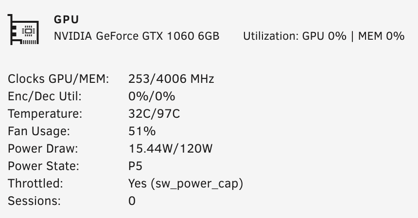

  8. Hi, This is a great extension and seems to work great. I am seeing a Throttle message and I don't quite understand it. What does it mean? The GPU is pass-through to Plex only. I've attached a screenshot. Thanks
