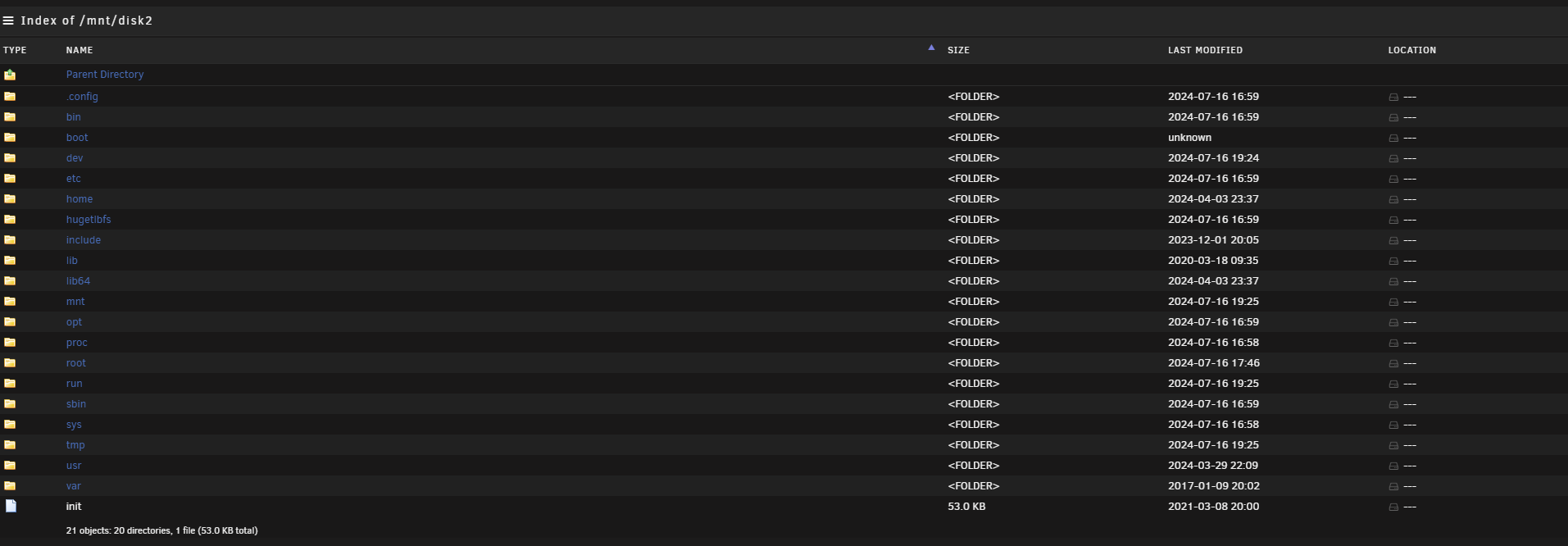

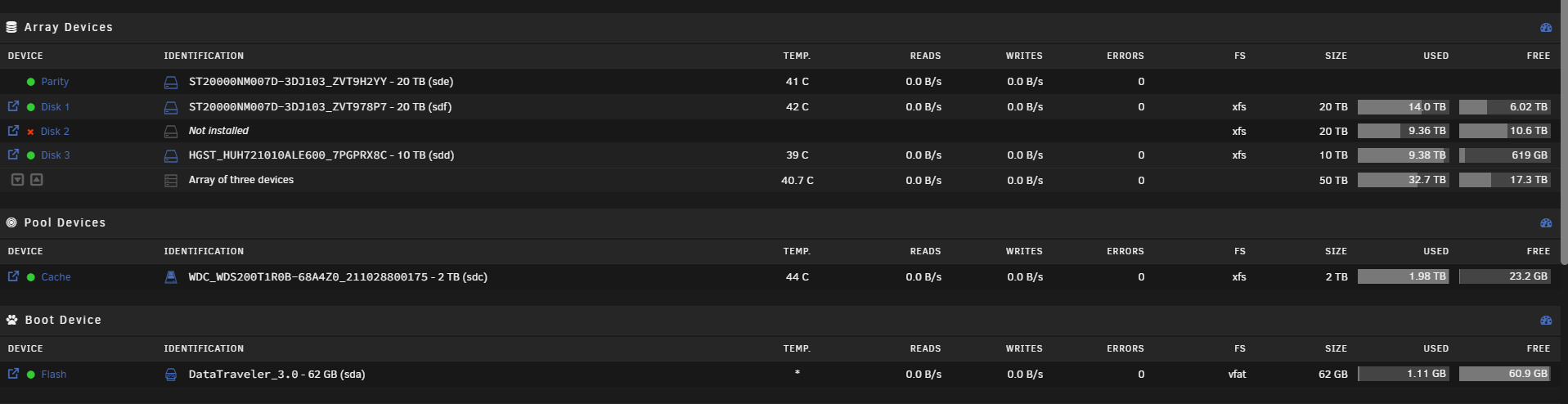

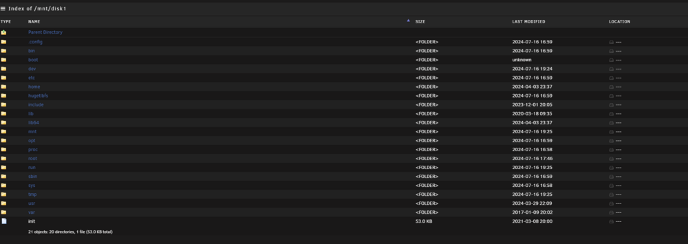

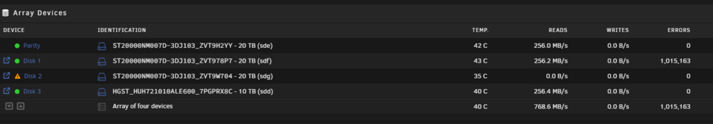

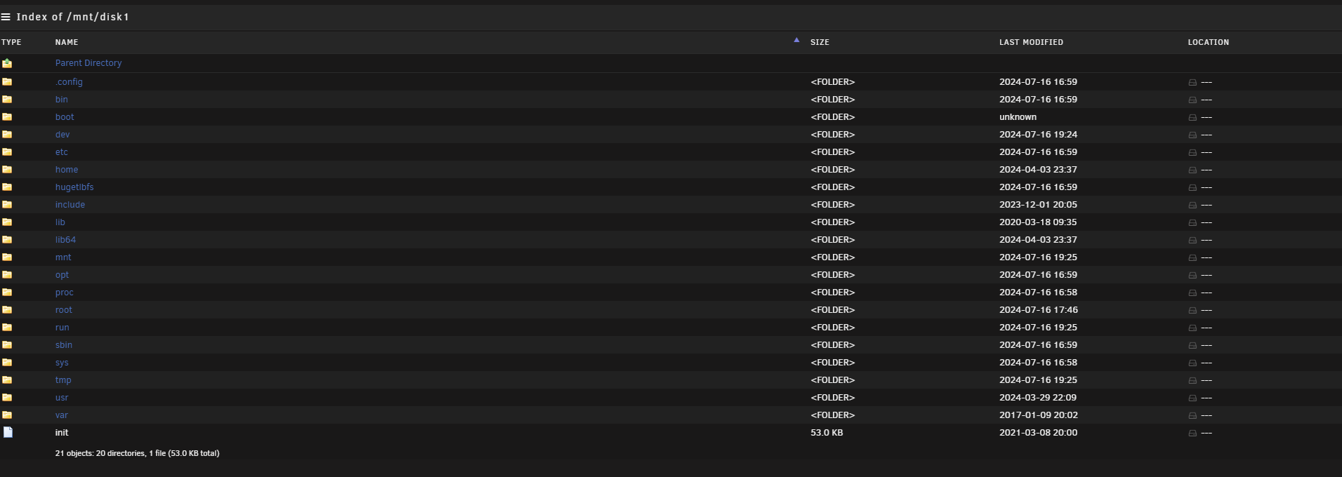

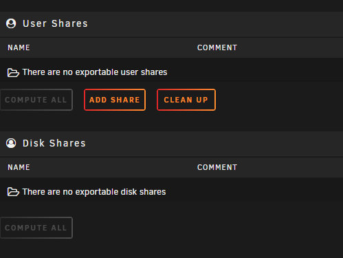

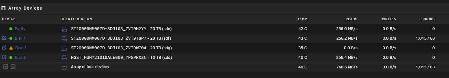

  6. Phase 1 - find and verify superblock... Phase 2 - using internal log - zero log... ERROR: The filesystem has valuable metadata changes in a log which needs to be replayed. Mount the filesystem to replay the log, and unmount it before re-running xfs_repair. If you are unable to mount the filesystem, then use the -L option to destroy the log and attempt a repair. Note that destroying the log may cause corruption -- please attempt a mount of the filesystem before doing this.
  7. Good evening, I caused some damage while changing a disk. Today, since I was running out of space in my array, I removed disk 2 (HGST_HUH721010ALE600_1DGJ8K7Z) which was 10TB and replaced it with a new disk (ST20000NM007D-3DJ103_ZVT9W704) which is 20TB. To do this, I stopped the array, physically removed the 10TB disk, and inserted the 20TB disk. Once Unraid detected it, I selected the new 20TB disk in the dropdown menu to replace disk 2 and started the array. The data reconstruction began immediately, but after a few hours, I noticed that no shares were available anymore. If I check /mnt/disk1 and /mnt/disk2, they don't exist and it only shows the parent directory and it seems to be read only. I stopped everything, and if I try to restart it, I get errors on disk 1 (a disk that shouldn't have any errors since it passed the parity check a few days ago). I still have the original 10TB disk 2 with all the data but now it want the 20tb. What can I do? w/o the disk seems to be all working and all data there, but I'm afraid that when it found errors on disk 1, it might have corrected and corrupted the files. Disk 1 and Disk 2 when the Data-Rebuild is in progress. Disk 3 seems to be intact. help <3 quiethub-diagnostics-20240716-1727.zip
