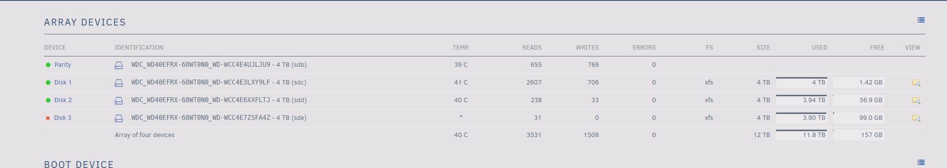

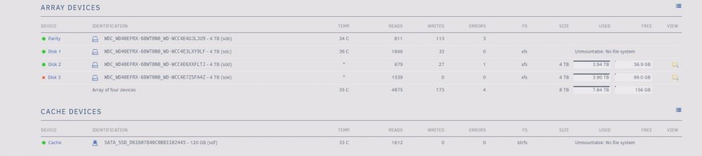

After reboot every single drive showed as "Unmountable: No file system"
I then rebooted again and then 1 or 2 of the drives recovered.
Now after multiple reboots and re-seating every cable and drive and putting the old cached drive back in, I now seem to have 1 drive that is genuinely failed and 1 drive showing "Unmountable: No file system", the unmountable drive has 0 errors and passed smart test.
Also the old cache drive now also shows "Unmountable: No file system".
All of these drives have been in the array for years, and have data on them.

It is only actually showing 1 failed drive in the array however, just one is showing with no file system. Is there no way for me to get the one with bad filesystem to do a check and show up correctly?
Parity disk shows as working correctly
Disk 1 shows as Unmountable: No file system
Disk 2 is showing as working correctly
Disk 3 is showing as a disabled drive and a smart scan wont complete.
I have re-seated everything again and just removed the cached drive completely and same issue with same drives.

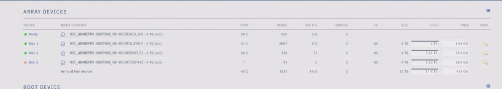

Ok, thanks a lot that fixed disk 1. Screenshot attached.
Disk 3 still disabled, is this disk completely failed or can I now just rebuild this?
