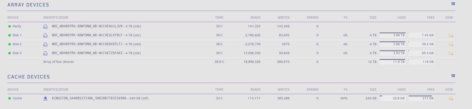

The scan completed successfully with no errors so I rebuilt the drive and now I have it all back up and running with my new Cache drive.
I assume when I inserted the cache drive a cable must have got knocked slightly loose causing all the errors.
