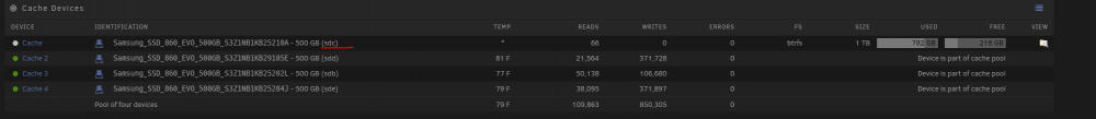

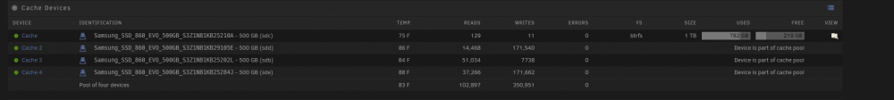

Also, i stopped and started thee array before making the OP so i could get the exact message from the popup but it didnt come up this time. Below is a picture of my cache pool, sdc is the new drive that i put in that did not rebuild.

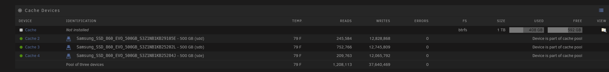

Stop array, unassign cache1, start array, wait a couple of minutes and grab new diags.
Strange, it's not trying to remove the missing device, add it back again.
The notification is normal, just not normal that it's not trying to delete/replace the missing device, try this, stop the array, again unassign cache1, start array and type:
btrfs dev del missing /mnt/cache
Post new diags after cache pool activity stops.

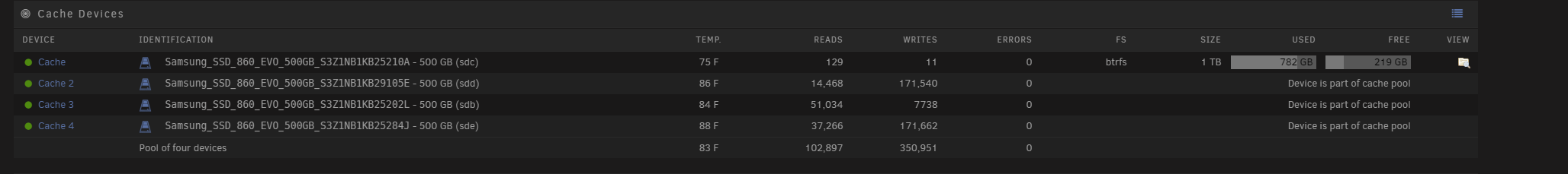

OK, now add back the other SSD and this time it should hopefully work.
@JorgeB Is it normal for this to happen for that drive? It is a brand new drive.

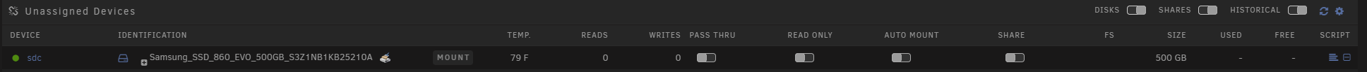

@JorgeB removed it and started it and looking in unassigned devices it doesnt show that its mountable, can preclear it though.

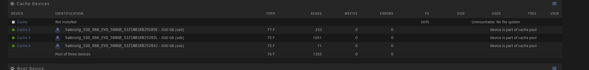

Stop the array, unassign all cache devices, start array to make Unraid "forget" current cache config, stop array, reassign all cache devices (there can't be an "All existing data on this device will be OVERWRITTEN when array is Started" warning for any cache device), start array.
1 minute ago, hermy65 said:
i assume if we blow this away i just add the new drive then tell it to format the cache array since its unmountable
Just need to format with the new device, all data will be lost.

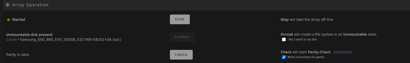

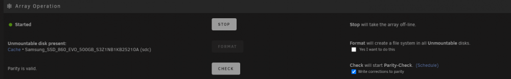

@JorgeB bummer, that did not work. Followed your steps, there was no existing data overwritten warning. Started it back up and it says unmountable for the cache array
