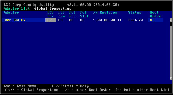

I am going to go ahead and update the LSI 9300 firmware, but to me this seems to be a harddrive problem.

Disk looks fine on SMART, I would recommend updating the firmware first, since it's very old and has known issues, you can easily do it inside Unraid.
Note that you'll need to do  a new config after the update because the disk's ID will change, one of the known issues with that old firmware.
