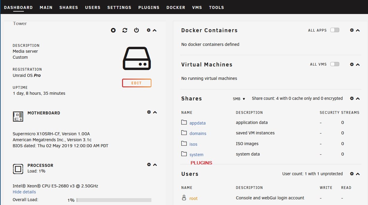

I have a follow-up question regarding the error I got shown in my top opening post.  After 15 hours of waiting my Parity setup process is now complete. However, after looking at the attached JPG file of my UnRAID GUI Dashboard I was left wondering if a PLUGINS folder needs to be showing where I have indicated in the attached JPG with the word "PLUGINS" shown in RED?  (Right below the System folder in the SHARES section).
The error mentions "failed to open stream local/emhttp/plugins" so this makes me wonder if in the SHARES section of the dashboard there should be a Security Stream called "PLUGINS"?  I am suspecting this because the error mentions the words "STREAM" and "PLUGINS" and the Dashboard GUI mentions "Security Stream" but no "PLUGINS".  In short, I would appreciate it a lot if anyone out there can take a look at their Dashboard and let me know if a "Plugins" folder appears anywhere in the SHARES section of your Dashboard.  Thank you.

Not on either of my two Unraid servers.  What browser are you using?   (The reason that I am asking is that the red PLUGINS in the Shares box appears to be some sort of an anomaly as it does not possess any of the format attributes of the other entries in that box-- or the entire Dashboard page for that matter.)
Furthermore, I have numerous plugins installed and there is absolutely no mention/box  about 'Plugins' on the Dashboard.
