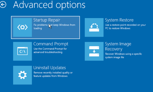

I went into the Repair options page but nothing worked.
"System Restore" option wouldn't even recognize a windows installation.

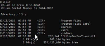

Under "Command Prompt", I could see the drive with the Windows installation.

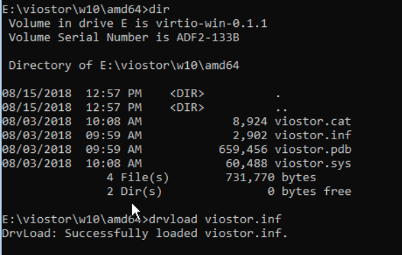

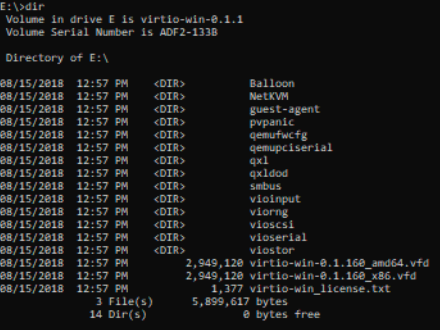

I have the install media and virtio driver isos both connected. I tried the "drvload <path to>viostor.inf" command and that made the windows 10 installation be recognized by the Rescue menu but Startup repair still failed.
I don't see any option for a Safe Mode boot.

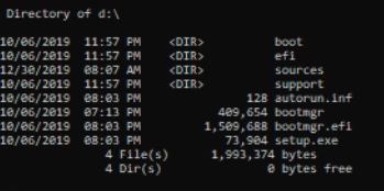

I tried booting from the insall disk to see what other repair options exist but nothing seemed to help.

These are the drives I see:

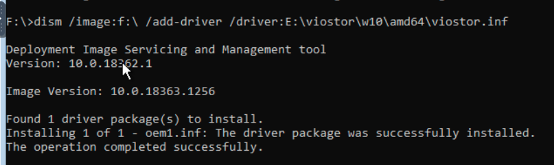

I loaded the viostor driver like this:
Then used dism to inject the driver into the windows installation
I tried rebooting here but nothing changed. So I went back and redid the above steps then used bcdedit to make it go to safemode
