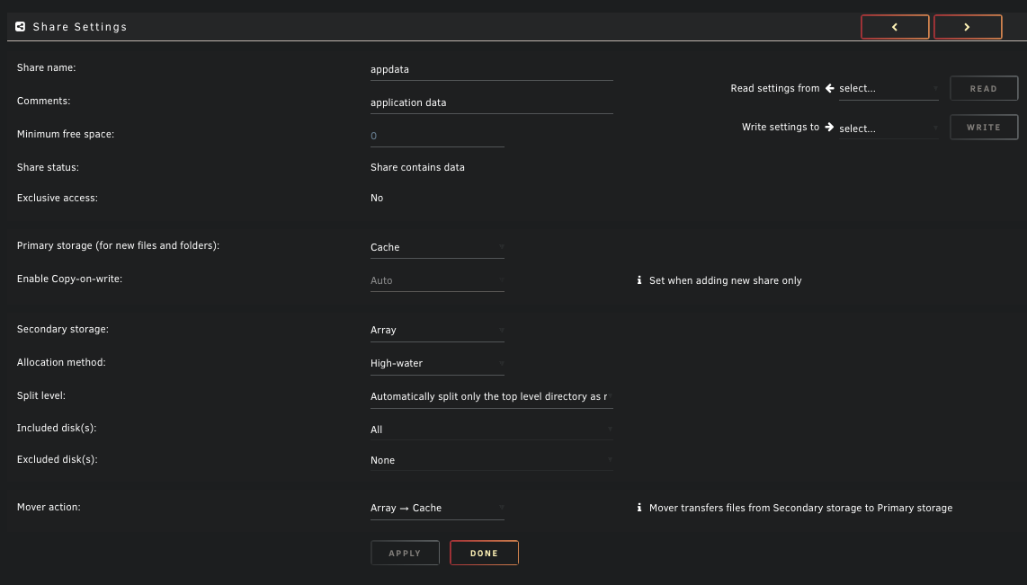

  2. Currently, appdata is primarily stored on the cache drive but gets moved to the array by the Mover once a day at 3:40 AM. So, files are still initially written to the cache. If your app, rradio, requires writing to the temp directory on the cache for stability, that's already in place. However, keeping everything in appdata exclusively on the cache isn't ideal. It wouldn’t benefit from the redundancy and backup features of the Unraid array, which is a key advantage of using Unraid for storage. It looks like our setups differ too much for this to be a workable solution for me. I appreciate your assistance, but I'll explore other options. Thank you again for your help!

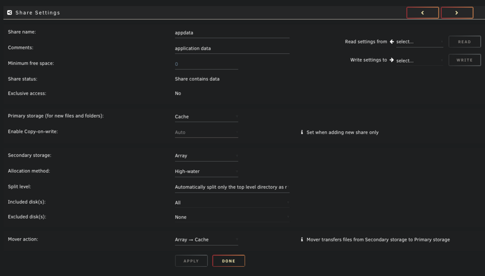

  3. i just checked again and it looks like it's already using Cache as the primary storage despite residing in /mnt/user/appdata

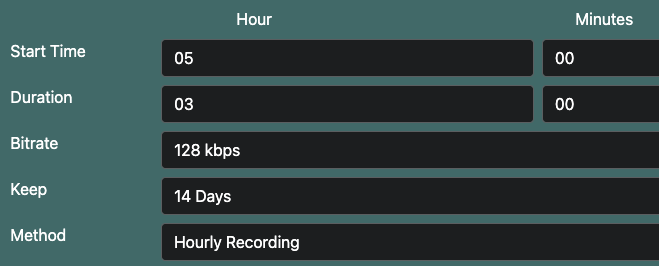

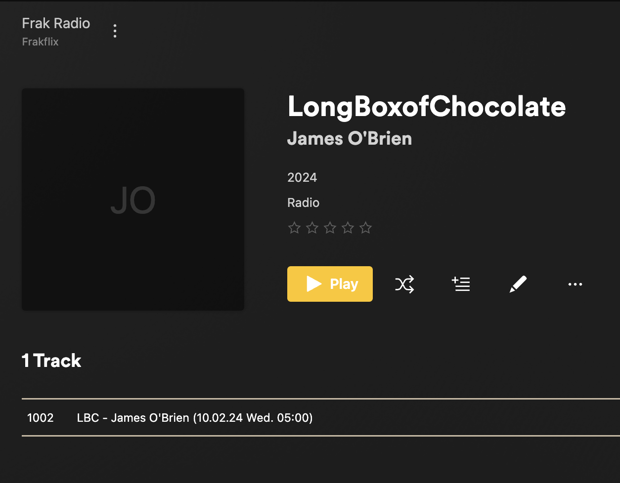

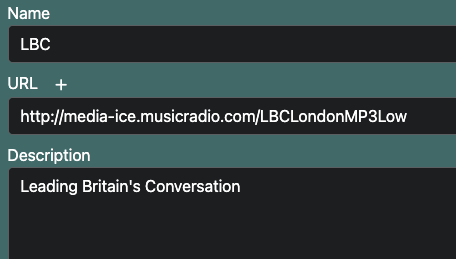

  6. Thank you for the feedback and tips. I deleted everything and started over using the MP3 stream URL that had worked perfectly for me when using the vlc command line to capture recordings in the past. It's also low bandwidth so should be less taxing or demanding on the system and less likely to fail. I created a new recording schedule every day for 3 hours starting at 5AM and used the Hourly instead of Continuous option The logs indicated that two of the three 1 hour recordings completed successfully. The middle hour is missing. 2024-10-04 05:00:10 [INFO] (Executing job 1-1) 2024-10-04 05:00:10 [INFO] (Job registered: False.) 2024-10-04 05:00:10 [INFO] (Setting up recording LBC - James O'Brien) 2024-10-04 05:00:10 [INFO] (Creating recording task) 2024-10-04 05:00:10 [INFO] (Recording stream) 2024-10-04 05:00:10 [INFO] (Job sent to ffmpeg recording engine) 2024-10-04 05:00:10 [INFO] (Arguments: -i "http://media-ice.musicradio.com/LBCLondonMP3Low" -c copy -t 3600 -metadata Title="LBC - James O'Brien (10.04.24 Fri. 05:00)" -metadata Album="James O'Brien" -metadata Artist="LBC" -metadata Track="1004" -metadata Album_Artist="LBC" -metadata Year="2024" -metadata Genre="Radio" -metadata Comments="LBC_James_O_Brien_(2024-10-04_05.00.10_Friday)" -c:a libmp3lame -ab 128k -y "/app/config/temp/LBC_James_O_Brien_(2024-10-04_05.00.10_Friday).mp3".) 2024-10-04 05:30:10 [INFO] (Executing job 1-1) 2024-10-04 05:30:10 [INFO] (Job registered: True.) 2024-10-04 05:30:10 [INFO] (Aborting) 2024-10-04 05:59:56 [INFO] (Parsing metadata) 2024-10-04 05:59:56 [INFO] (ffmpeg exit code 0) 2024-10-04 05:59:56 [INFO] (File recorded LBC_James_O_Brien_(2024-10-04_05.00.10_Friday).mp3) 2024-10-04 05:59:56 [INFO] (Updating job register) 2024-10-04 05:59:56 [INFO] (Moving recorded file from temp folder to media folder) 2024-10-04 05:59:56 [INFO] (Generating audio feed) 2024-10-04 05:59:56 [INFO] (Job 1-1 completed) 2024-10-04 06:00:10 [INFO] (Executing job 1-2) 2024-10-04 06:00:10 [INFO] (Job registered: False.) 2024-10-04 06:00:10 [INFO] (Setting up recording LBC - James O'Brien) 2024-10-04 06:00:10 [INFO] (Creating recording task) 2024-10-04 06:00:10 [INFO] (Recording stream) 2024-10-04 06:00:10 [INFO] (Job sent to ffmpeg recording engine) 2024-10-04 06:00:10 [INFO] (Arguments: -i "http://media-ice.musicradio.com/LBCLondonMP3Low" -c copy -t 3600 -metadata Title="LBC - James O'Brien (10.04.24 Fri. 06:00)" -metadata Album="James O'Brien" -metadata Artist="LBC" -metadata Track="1004" -metadata Album_Artist="LBC" -metadata Year="2024" -metadata Genre="Radio" -metadata Comments="LBC_James_O_Brien_(2024-10-04_06.00.10_Friday)" -c:a libmp3lame -ab 128k -y "/app/config/temp/LBC_James_O_Brien_(2024-10-04_06.00.10_Friday).mp3".) 2024-10-04 06:00:30 [INFO] (Parsing metadata) 2024-10-04 06:00:30 [ERROR] (Object reference not set to an instance of an object.-) 2024-10-04 07:00:10 [INFO] (Executing job 1-3) 2024-10-04 07:00:10 [INFO] (Job registered: False.) 2024-10-04 07:00:10 [INFO] (Setting up recording LBC - James O'Brien) 2024-10-04 07:00:10 [INFO] (Creating recording task) 2024-10-04 07:00:10 [INFO] (Recording stream) 2024-10-04 07:00:10 [INFO] (Job sent to ffmpeg recording engine) 2024-10-04 07:00:10 [INFO] (Arguments: -i "http://media-ice.musicradio.com/LBCLondonMP3Low" -c copy -t 3600 -metadata Title="LBC - James O'Brien (10.04.24 Fri. 07:00)" -metadata Album="James O'Brien" -metadata Artist="LBC" -metadata Track="1004" -metadata Album_Artist="LBC" -metadata Year="2024" -metadata Genre="Radio" -metadata Comments="LBC_James_O_Brien_(2024-10-04_07.00.10_Friday)" -c:a libmp3lame -ab 128k -y "/app/config/temp/LBC_James_O_Brien_(2024-10-04_07.00.10_Friday).mp3".) 2024-10-04 07:30:10 [INFO] (Executing job 1-3) 2024-10-04 07:30:10 [INFO] (Job registered: True.) 2024-10-04 07:30:10 [INFO] (Aborting) 2024-10-04 07:59:57 [INFO] (Parsing metadata) 2024-10-04 07:59:57 [INFO] (ffmpeg exit code 0) 2024-10-04 07:59:57 [INFO] (File recorded LBC_James_O_Brien_(2024-10-04_07.00.10_Friday).mp3) 2024-10-04 07:59:57 [INFO] (Updating job register) 2024-10-04 07:59:57 [INFO] (Moving recorded file from temp folder to media folder) 2024-10-04 07:59:57 [INFO] (Generating audio feed) 2024-10-04 07:59:57 [INFO] (Job 1-3 completed) When I checked the folders manually, I see only two recordings: root@bf4d254a14f5:/media# ls -lasth total 110M 0 drwxrwxrwx 1 99 users 200 Oct 4 07:59 . 55M -rw-r--r-- 1 root root 55M Oct 4 07:59 'LBC_James_O_Brien_(2024-10-04_07.00.10_Friday).mp3' 55M -rw-r--r-- 1 root root 55M Oct 4 05:59 'LBC_James_O_Brien_(2024-10-04_05.00.10_Friday).mp3' 0 drwxr-xr-x 1 root root 170 Oct 3 19:11 .. 0 lrwxrwxrwx 1 root root 6 Oct 1 17:16 media -> /media root@bf4d254a14f5:/media# ls -lasth /app/config/temp total 0 0 drwxr-xr-x 1 root root 0 Oct 4 13:27 . 0 drwxr-xr-x 1 99 users 192 Oct 1 17:16 .. root@bf4d254a14f5:/media#

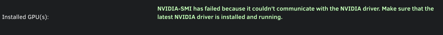

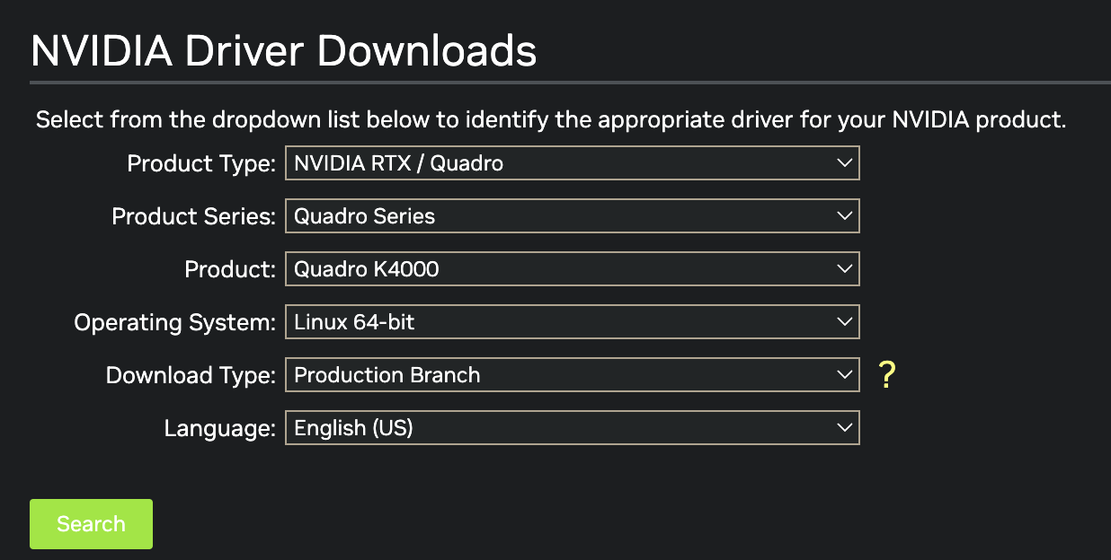

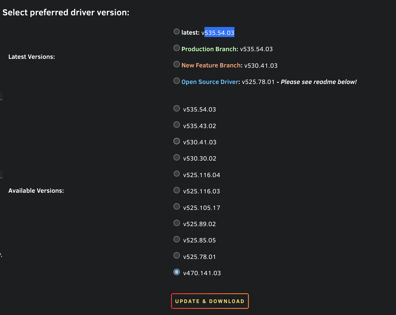

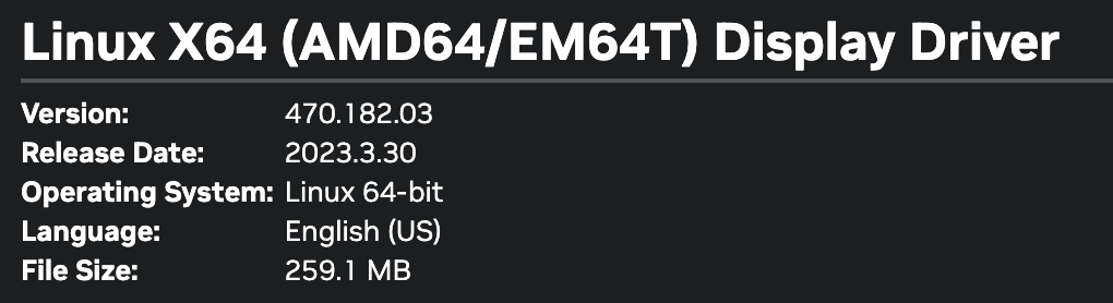

  11. I have the Nvidia Quadro K4000 graphics card. When I try to install the latest from the plugin, I get this error: The Nvidia drivers page points me to this driver for Linux 64bit which is fairly recent (March 2023) However, when I use the plugin, the only 470.xxx one that it provides is the one at the bottom: v470.141.03 I want to be able to use this card with Docker for apps that use the "--runtime=nvidia" parameter like stable-diffusion etc. that detect the NVIDIA GPU and ask for its GPUID e.g. GPU-xxxxxxx-xxxx-xxxx-xxxx-xxxxxxx. Is this something that can be supported?
