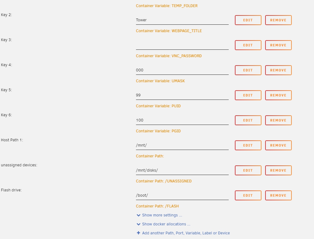

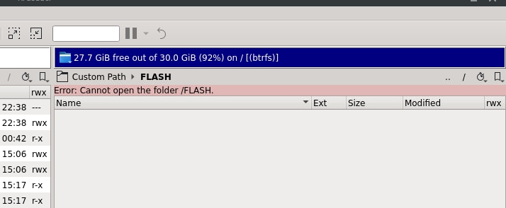

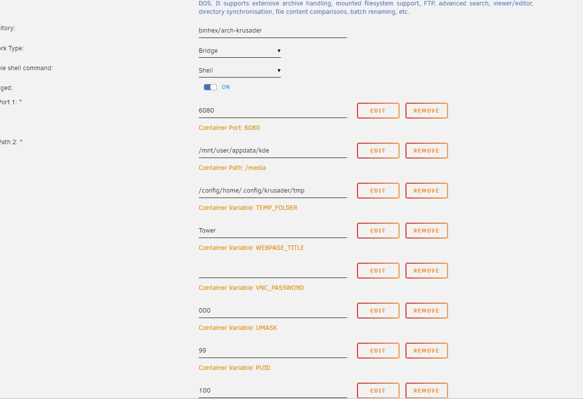

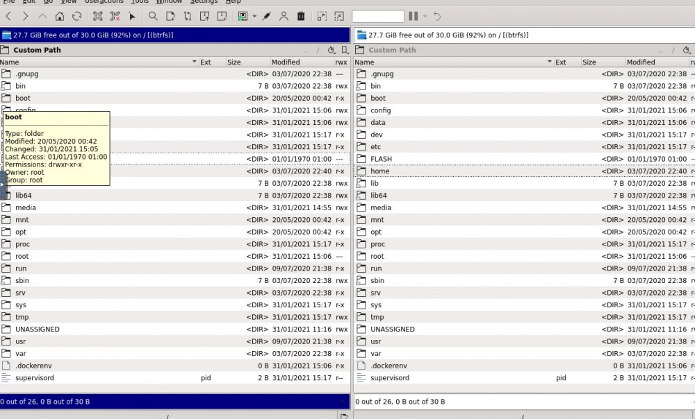

here we go...finally I got it, but still some issues with a docker: Krusader.  Perhaps you can help me to find solution.
tried to install your Krusader, and following SpaceInvader indication, but the settings pages are different and perhaps I've made some mistakes.
However the docker was installed, but in the GUI I don't see the same details Space was shown and if I go into some folder ( for instance FLASH ) it doesn't show anything.
Any suggestions on how to fix all these issues ?
- are the settings corrects ?
- the version showed in the Spaceinvaders is different, especially regarding the KEYS that in the video are not mentionign and not with such a numeber of them, however I left them untouched
- in the setting the line  "the Webpage title " : is as default named TOWER.  Is the name of the server ? I left it, but to be clear, my server has a different name, should I change it ?
- Why I can't see UNRAID FOLDER ? The main issue it that I would move file onto some  share folders, but since I don't see them, I can't.   Any suggestion on  it ? I saw anoher video from a french user and i realize that perhaps ina new version...UNRAID FOLDER became the " media " folder, but, even in this case..if I open the media folder I don't see anything inside
Any suggets ?
THX for your kind support
Attacched some screenshots
Do you understand docker volume mapping?
