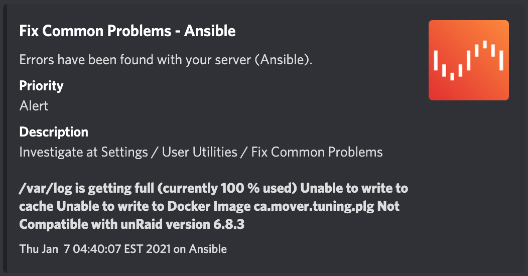

Currently running 6.8.3 and having a new and strange issue I can't figure out. Server had been running for multiple months with little to no issue, but recently every few days my log will fill up overnight (usually between 4:30AM - 5:00AM) which basically causes the server to cease to function (all dockers shut down except Plex, which ceases to function) and can only be fixed with a reboot. While the reboot fixes the issue, it keeps occurring and I'd like to fix it at the source.

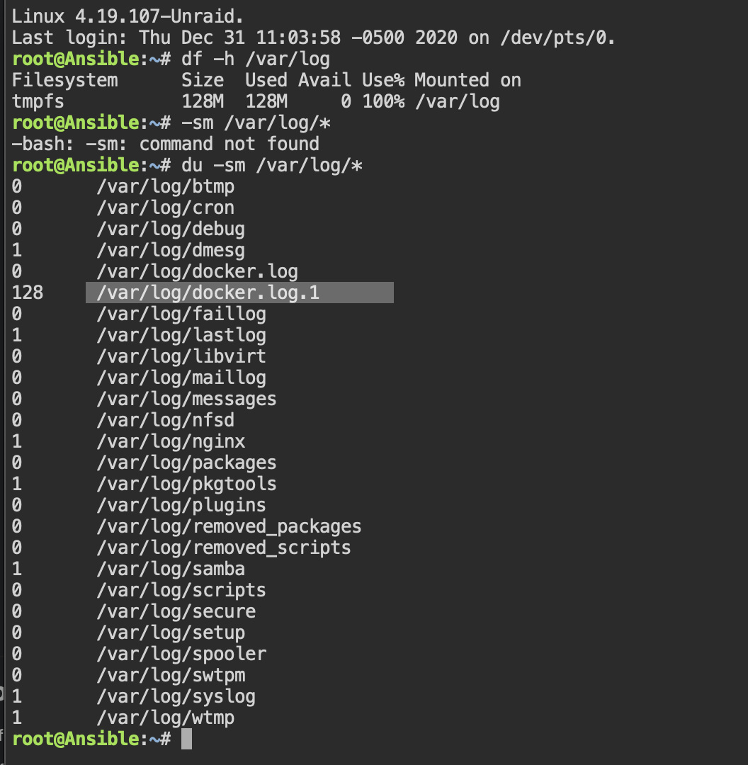

  • -sm /var/log/* output
  • All Diagnostics files (strangely my  syslog doesn't have any entries after ~2:00AM)

Looks like you have problems on your NVME drive:
Jan  7 02:02:57 Ansible kernel: BTRFS info (device nvme0n1p1): leaf 2371893067776 gen 22649348 total ptrs 127 free space 6377 owner 2
Jan  7 02:02:57 Ansible kernel: 	item 0 key (998602620928 168 32768) itemoff 16230 itemsize 53
Jan  7 02:02:57 Ansible kernel: 		extent refs 1 gen 8074017 flags 1
Jan  7 02:02:57 Ansible kernel: 		ref#0: extent data backref root 5 objectid 40579188 offset 0 count 1
Jan  7 02:02:57 Ansible kernel: 	item 1 key (998602653696 168 24576) itemoff 16177 itemsize 53
Jan  7 02:02:57 Ansible kernel: 		extent refs 1 gen 20973330 flags 1
Jan  7 02:02:57 Ansible kernel: 		ref#0: extent data backref root 5 objectid 81908089 offset 0 count 1
Jan  7 02:02:57 Ansible kernel: 	item 2 key (998602678272 168 16384) itemoff 16124 itemsize 53
Jan  7 02:02:57 Ansible kernel: 		extent refs 1 gen 20807749 flags 1
Jan  7 02:02:57 Ansible kernel: 		ref#0: extent data backref root 5 objectid 81073547 offset 0 count 1
This cause errors on loop2 (docker.img I think).
Jan  7 02:02:57 Ansible kernel: BTRFS: error (device nvme0n1p1) in __btrfs_free_extent:6802: errno=-2 No such entry
Jan  7 02:02:57 Ansible kernel: BTRFS info (device nvme0n1p1): forced readonly
Jan  7 02:02:57 Ansible kernel: BTRFS: error (device nvme0n1p1) in btrfs_run_delayed_refs:2935: errno=-2 No such entry
Jan  7 02:02:57 Ansible kernel: BTRFS error (device nvme0n1p1): pending csums is 7475200
Jan  7 02:03:01 Ansible kernel: loop: Write error at byte offset 10158755840, length 4096.
Jan  7 02:03:01 Ansible kernel: print_req_error: I/O error, dev loop2, sector 19841320
Jan  7 02:03:01 Ansible kernel: BTRFS error (device loop2): bdev /dev/loop2 errs: wr 6, rd 0, flush 0, corrupt 0, gen 0
Jan  7 02:03:11 Ansible kernel: loop: Write error at byte offset 4098166784, length 4096.
Jan  7 02:03:11 Ansible kernel: print_req_error: I/O error, dev loop2, sector 8004232
Jan  7 02:03:11 Ansible kernel: BTRFS error (device loop2): bdev /dev/loop2 errs: wr 7, rd 0, flush 0, corrupt 0, gen 0
Jan  7 02:03:11 Ansible kernel: loop: Write error at byte offset 2370904064, length 4096.
Jan  7 02:03:11 Ansible kernel: print_req_error: I/O error, dev loop2, sector 4630672
Jan  7 02:03:11 Ansible kernel: BTRFS error (device loop2): bdev /dev/loop2 errs: wr 8, rd 0, flush 0, corrupt 0, gen 0
Jan  7 02:03:11 Ansible kernel: loop: Write error at byte offset 3451928576, length 4096.
Jan  7 02:03:11 Ansible kernel: print_req_error: I/O error, dev loop2, sector 6742048
Jan  7 02:03:11 Ansible kernel: BTRFS error (device loop2): bdev /dev/loop2 errs: wr 9, rd 0, flush 0, corrupt 0, gen 0
This would explain your issues with your dockers and the log filling with errors.

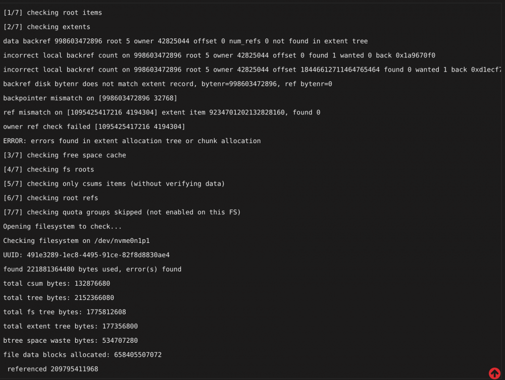

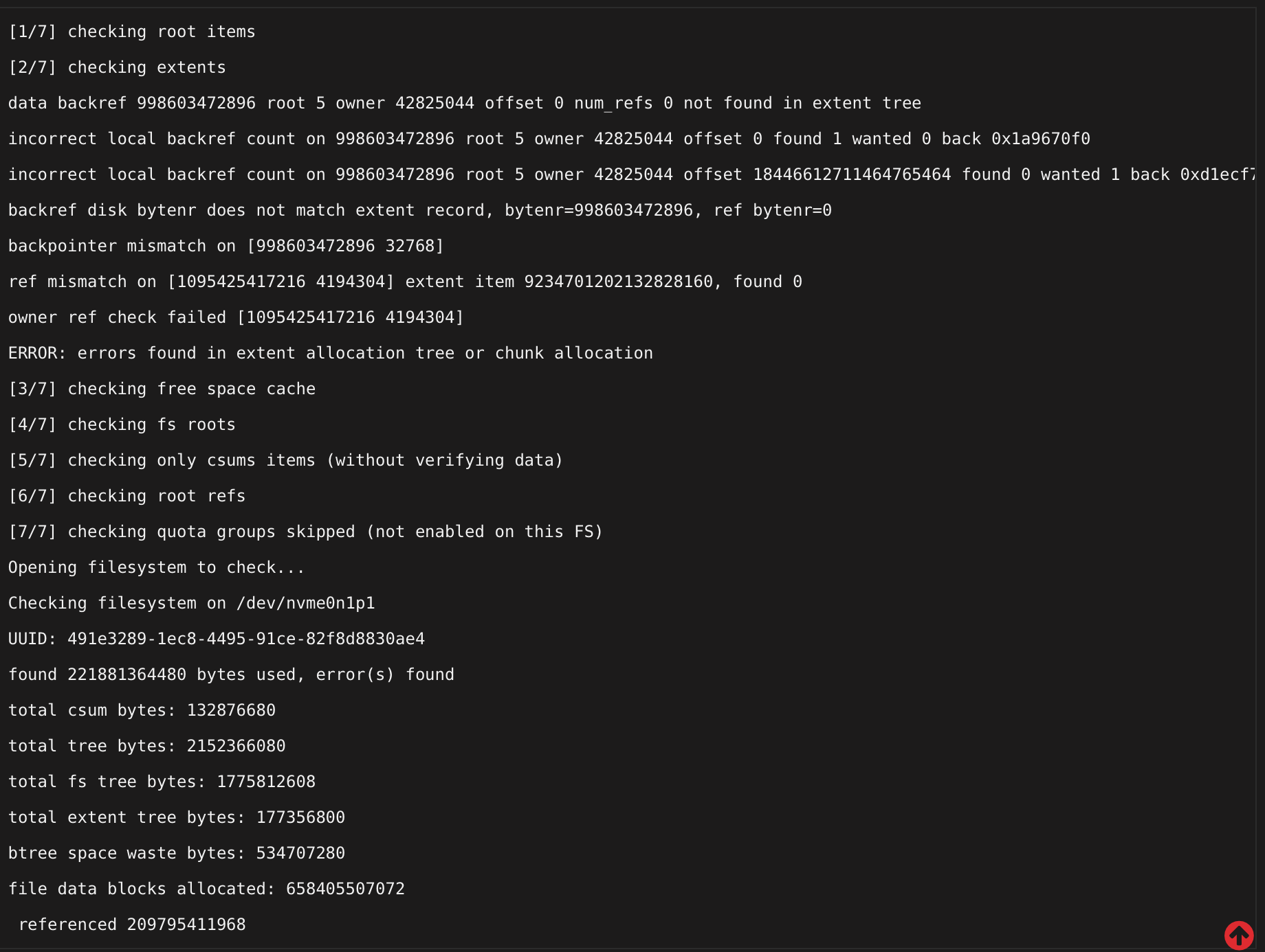

I performed a BTRFS scrub (no errors) and also a filesystem check (output attached)

You can try check --repair but only after making sure everything important is backed up, if it doesn't work or if it re-occurs best bet is to re-format and restore the data.
Thanks @JorgeB will try that now and hope it solves the issue.
