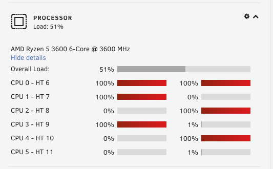

some more information to add: after having a transfer stall out via local network, i noticed the CPU usage looks like this (see below) and UNRAID functions very sluggishly until it degrades to not functioning. I am doing some more research the more I am finding out.

thanks @jonathanm i found that same thread yesterday and changed the idle state Power Idle Control, but didn't come back and disable C-states. So far that seems to have knocked things into shape so far. Currently transferring 918GB and it's running smooth at the 250GB mark. Keeping fingers crossed, but looking promising. Big shout out to @JorgeB for his post above, thanks guys and thanks to this great community for the quick responses on all of my posts, much appreciated.
