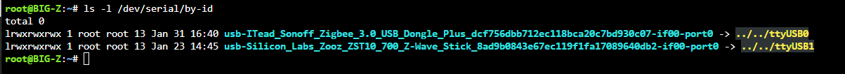

the best method to passthrough usb to docker is via device by-id
open unraid terminal
type
ls -l /dev/serial/by-id
you will get output of your devices with names
copy the whole BLUE name of your device

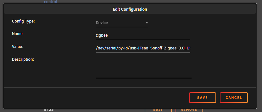

go to your docker and edit config
add /dev/serial/by-id/  before pasting the name from above.
eg
/dev/serial/by-id/usb-ITead_Sonoff_Zigbee_3.0_USB_Dongle_Plus_dcf756dbb712ec118bca20c7bd930c07-if00-port0
then add :/dev/zigbee to the end -  this is the container mount point
so you end up with this in your Docker Host config:
/dev/serial/by-id/usb-ITead_Sonoff_Zigbee_3.0_USB_Dongle_Plus_dcf756dbb712ec118bca20c7bd930c07-if00-port0:/dev/zigbee
if anywere inside your docker program it asks for the device location you would set it to :
/dev/zigbee

yes it can change if you have more than 1 USB device.
if you only have one it will always be 0
by-id is the only sure way.
