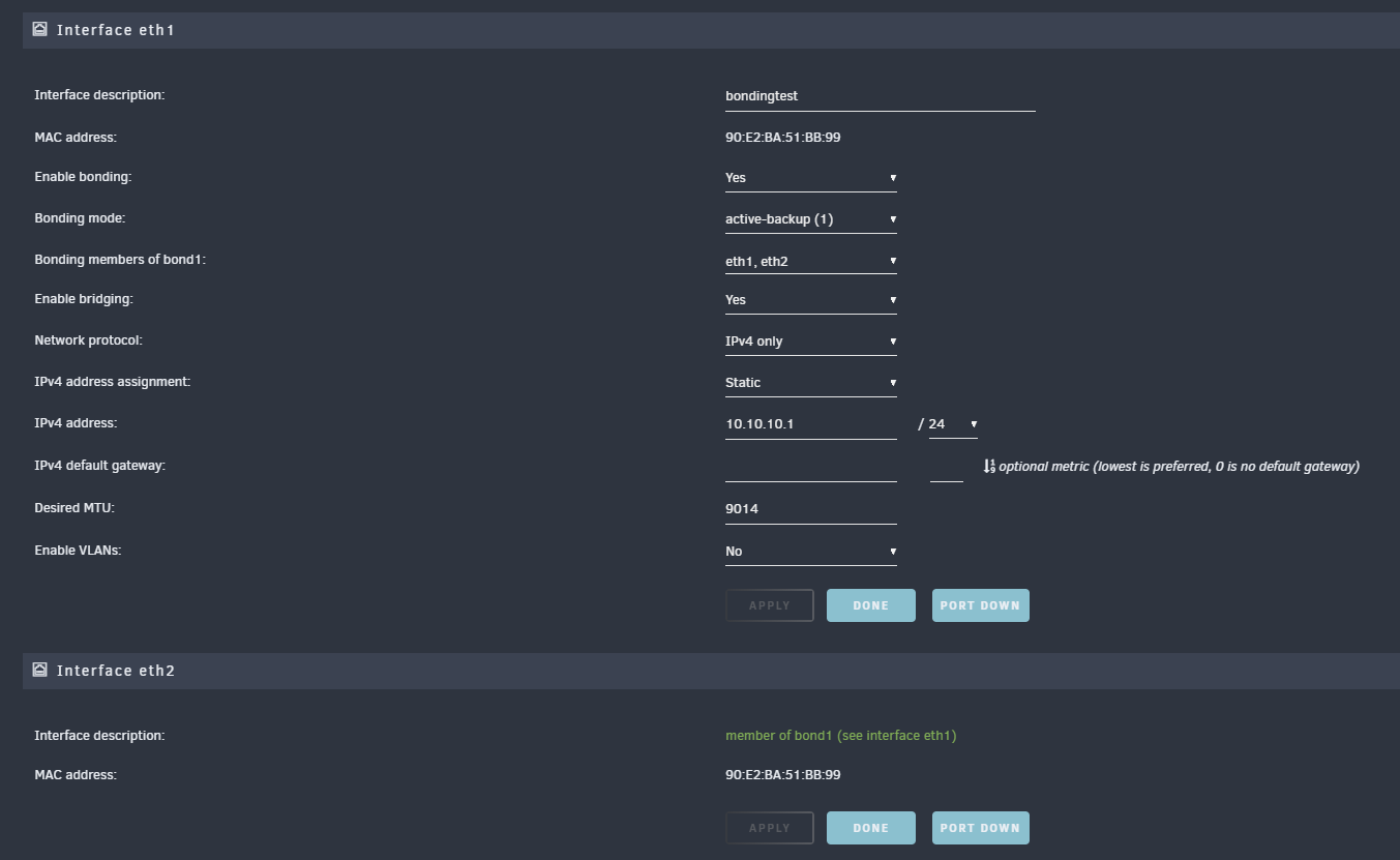

I've setup bonding for my 10gbe fibre NIC but can't change the bonding mode from active-backup. No matter what setting I choose it just reverts back to active-backup (1)
Here are my settings

for me it's the same issue, the button option is stuck on active-backup, when i reboot my unraid box it'll be set to active-backup (and as a result not get a network connection, because the switch is expecting an 802.3ad setup) when i start the array, but if i first go into the settings menu, set it to 802.3ad, click apply, and then start the array.. it works.
the button still says active-backup, but it's running 802.3ad.
