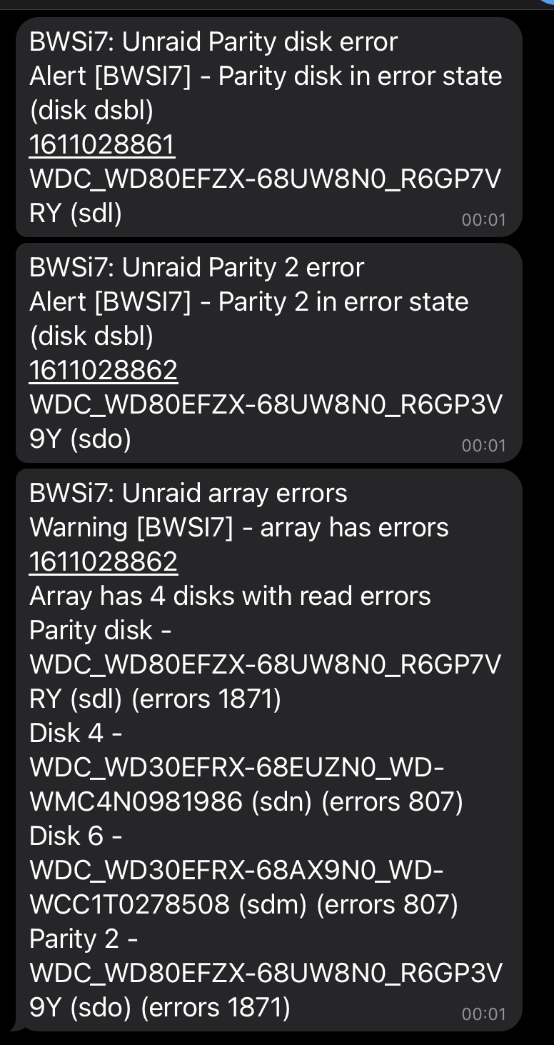

4 disks fail at the same time. Controller failure??

Please post the diagnostics before rebooting.
Wish I could. But server also shut itself down
