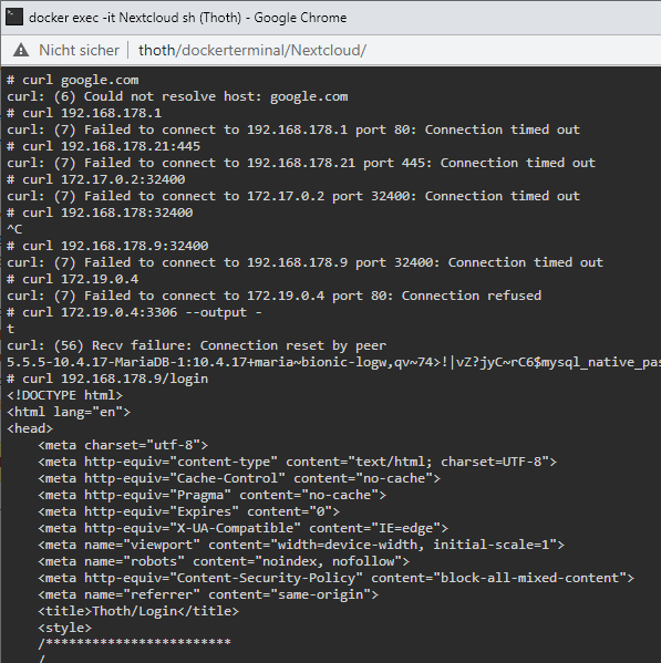

I'm trying to isolate some of my docker containers and after testing different IPs and Ports I found out that all of my docker containers are able to connect to the Unraid WebGUI.
Example:
Thanks to docker's --internal flag all these connections failed:
google.com           Internet
192.168.178.1        Router
192.168.178.21:445   SMB Client
172.17.0.2:32400     Plex Bridge IP
192.168.178.9:32400  Plex Host IP
Only these connections worked:
172.19.0.4:3306       MariaDB (wanted)
192.168.178.9/login   Unraid WebGUI (unwanted)
Is this a wanted behaviour? How can I block this?
