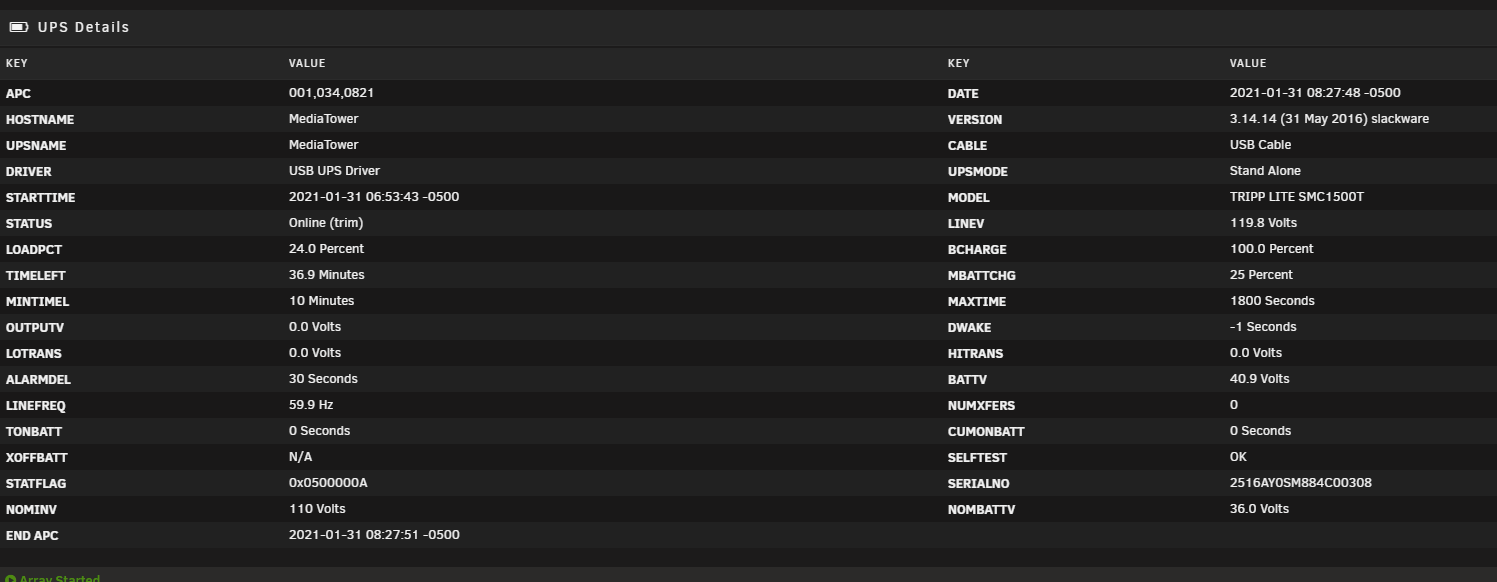

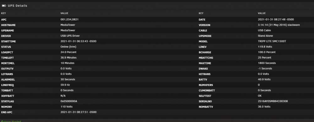

Not sure if the table above is right after the discharge event, or after the batteries have been charging for awhile.

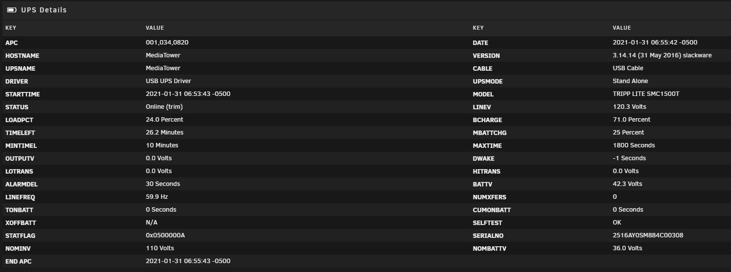

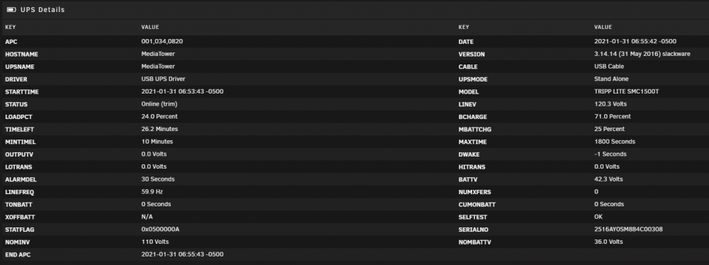

On the graphic it shows BATTV as 42.3 volts.   For a 48V lead-acid battery at room temperature
that's about 1% charged (99% discharged).  The table also shows BCHARGE at 71 percent.
Those two numbers disagree with each other.
While float charging, the battery should sit at 54.4 volts for 100% capacity.

OK,  36V is an unusual UPS battery bank voltage.   My numbers assumed a 48v bank.
Does your server load increase when the UPS switches on?    Sometimes the
server starts a shutdown process which increases the load.  The 36.9 minutes
I think assumes the UPS goes to 0% charge.   The table above appears to be to shutoff
when the battery gets down to 25%, and MAXTIME of 1800 seconds (30 minutes).
The table shows  OUTPUTV of 0.0 volts.  Not sure what that refers to, my UPS driver
does not provide that parameter.
What does your OUTPUTV parameter show?

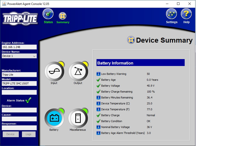

Did you reset the battery date in the UPS firmware?
Yes I did.. I followed the instructions from Tripp Lite. Here is the Tripp Lite app reporting info on my UPS.
