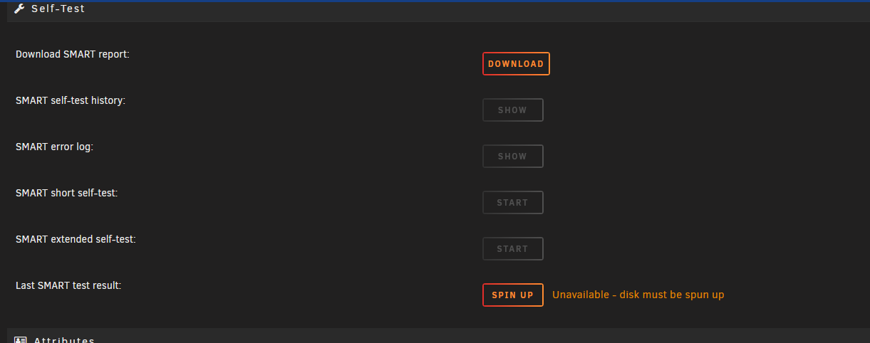

I forgot to ask, is there any regular surface scans/long diagnostic SMART tests scheduling in Unraid? I liked that Stablebit Scanner did this, and I do it today via HD Sentinel on some servers to be pro-active and detect pending and/or reallocated sector failures early.
A parity check reads all sectors on all drives in the parity array.
You can initiate and check results of SMART tests in the GUI, and if you wanted, you could script them.

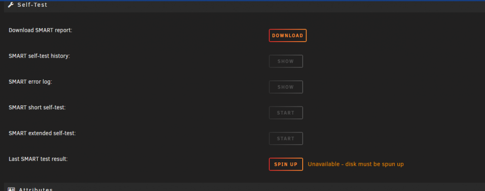

FYI - here's the GUI SMART section:
Thank you, if I can schedule the extended self-test via scripting or otherwise, I'll be good. I like to run them every 30 days.

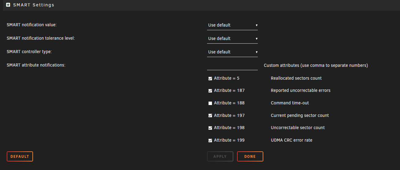

A followup if I may. I read in the Unraid 6 Manual:
"You can subscribe to different types of notifications for each method and even add custom alerts for SMART values attribute monitoring."
Will this act similar to the N second checking mdmonitor can do in md setups? So that when a sector read or write operation is attempted, and there's a pending and/or reallocation event happening, I will be notified almost instantly on e-mail without having to run a test manually or wait for my script to run.
Yes, because of some cabling issues, I was getting a lot of UDMA CRC errors on a particular disk.  The error notifications were frequent and almost instantaneous.  I ended up attaching that disk to a different HBA SATA cable/port and rebuilding.  It was the same disk and I just rebuilt it onto itself and all was good.  Because of all the errors, unRAID eventually marked the disk unreadable.
Notifications can be email but also pop up in the unRAID GUI.
I had another case where I turned off SMART monitoring of a particular attribute because I was getting notified of an "error" that minutes later corrected itself. It got so frequent it was annoying and was due to a firmware bug in that particular SSD model.
Being able to opt out certain attributes is surely a nice option to have.

Here's what it looks like (I turned off 197 because it was a false pending sector count reading):
That's a pretty serious firmware bug... To report false pending.
