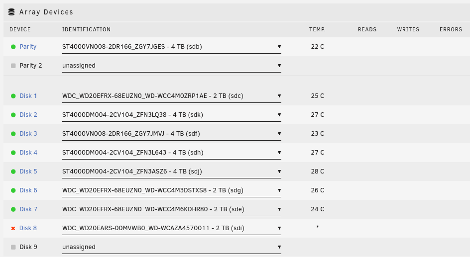

array of 9 disks (8 data + parity) and cache drive....

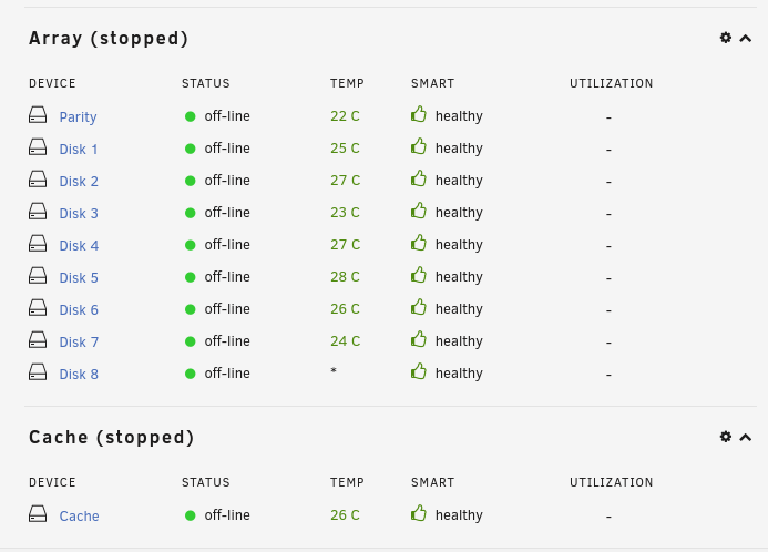

The parity just started and within a minute I got a warning that one disk is 'disabled' and parity and the array stopped.. The log (attached) shows lot of read and then write errors. The disk shows healthy and smart diagnostic found no problem but the disk is disabled. Any suggestion how to put it back into the array (new config?) or the disk is not to be trusted and require a replacement?1223953507_Screenshotfrom2021-02-0100-34-57.png.922275df023c48efedce8906b6779d8e.png1958885428_Screenshotfrom2021-02-0100-32-03.png.29ec4418518e7f0d91822086752dc12d.png Or any other suggestion please.
Regards
BobNik

Looks more like a controller problem, you're using a SASLP/SAS2LP and those have been known to drop disks without a reason, though that disk is quite old and showing some issues, still recommend replacing it with an LSI HBA.
