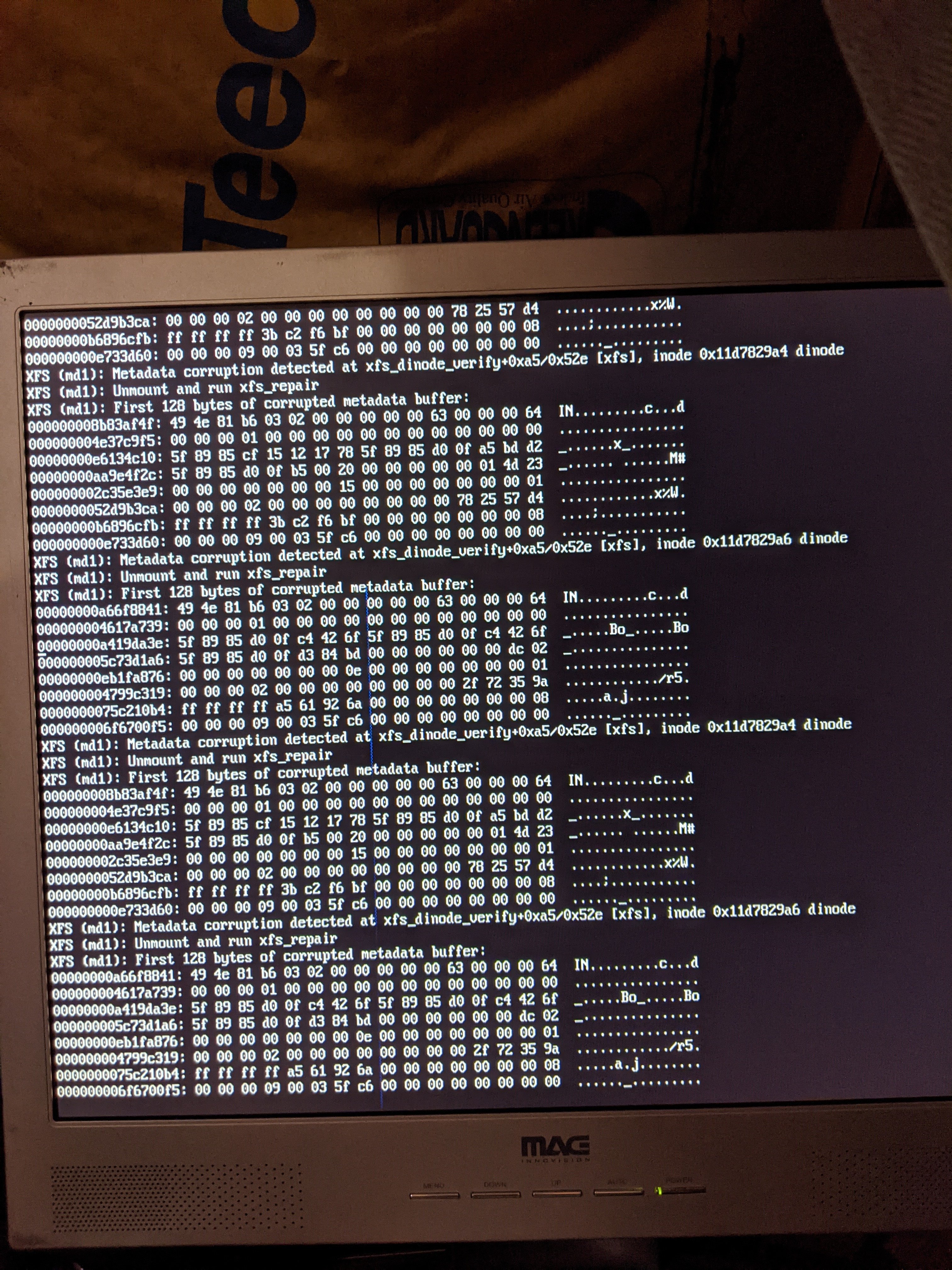

I can't find any relevant log data, but I'm worried I'm looking in the wrong place. Instead, I hooked up a VGA monitor to the server and took a photo (below).
  • The symptoms are benign mostly, but can actually take down my home network in some rare cases.
  • System boots well. Runs flawlessly for 1-2 days. But, eventually, something like this appears on the monitor. More rarely, it generates HUGE amounts of network traffic, and grinds everything to a halt.
  • I'm considering running a repair on the xfs filesystem on disc1 (md1). But I also understand that can come with risks.

Go to Tools - Diagnostics and attach the complete Diagnostics ZIP file to your NEXT post in this thread.
Repair filesystem on disk1, be sure to capture the output so you can post it.

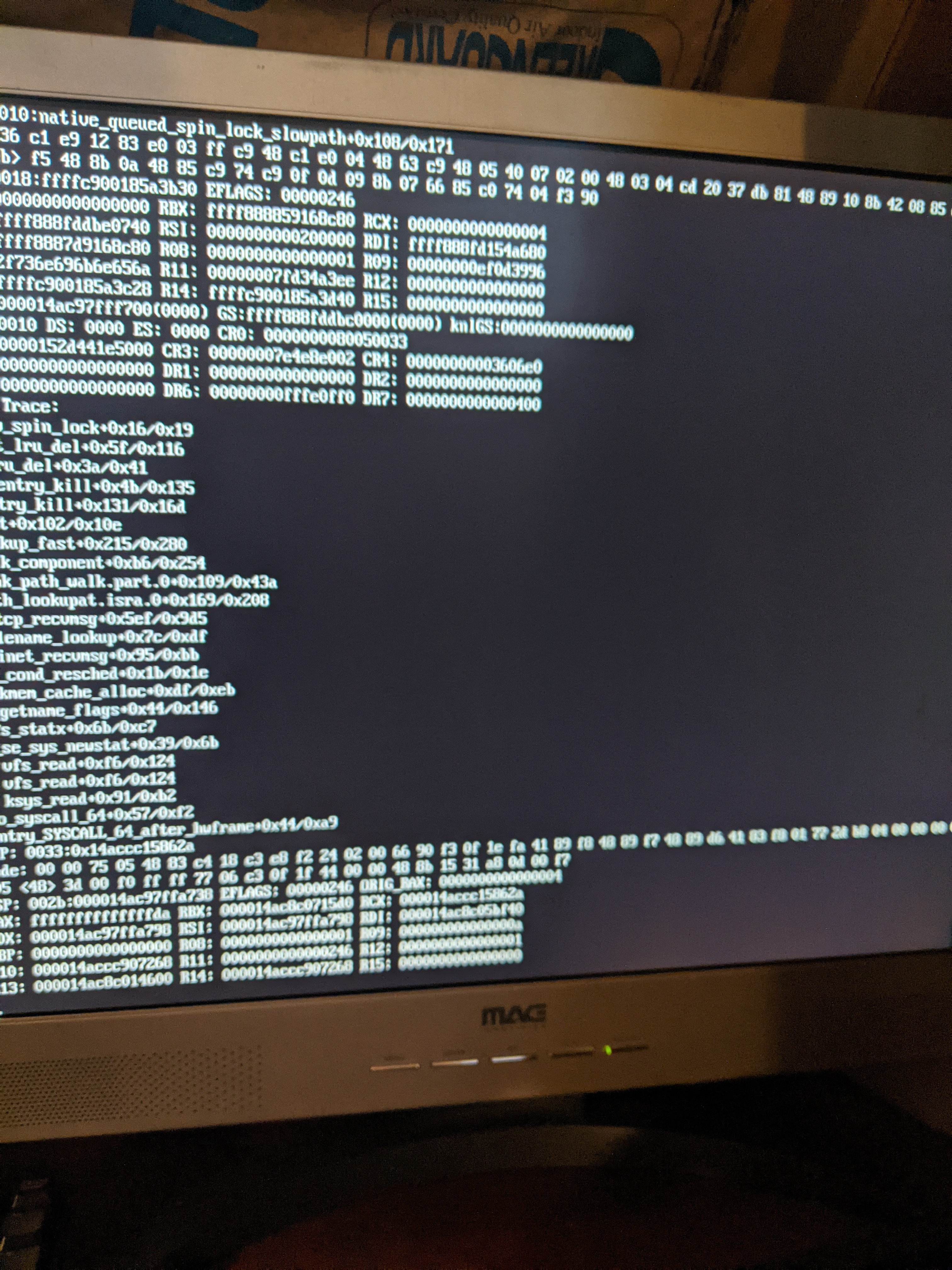

Previous problem h as begun expressing itself in the old way again. Image of monitor on server attached as well as logs after a reboot (had to reboot, response was too slow).
athena-diagnostics-20210207-1644.zip
Diags are just after rebooting so not much to see, you can try this and then post that log.

Thar she blows....syslog
There are some xfs related crashes, run a filesystem check (without -n) on disk2.
Put it in maintenance mode, and run on disk2 (removed the -n argument). Results below:

Try again, leave remote syslog running.
Test in progress. Transcoding some Plex, copying some trivial files, etc. Will report back.
