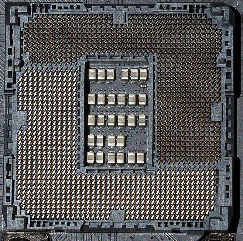

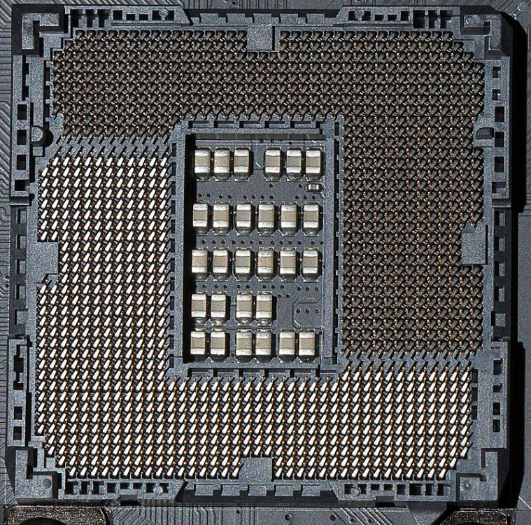

I looked at the pins on MB and it appears to have 5 missing pins. I see holes with no pins in it....

No speaker connected. I will add when I get a replacement MB. The CPU is 10900K so according to Sireal63 it does have Graphics Processor on it. Based on the missing pins on CPU socket I have gotten a RMA from Newegg.
TY for all of the suggestions guys. I would never of looked at the CPU socket and found the missing pins.
