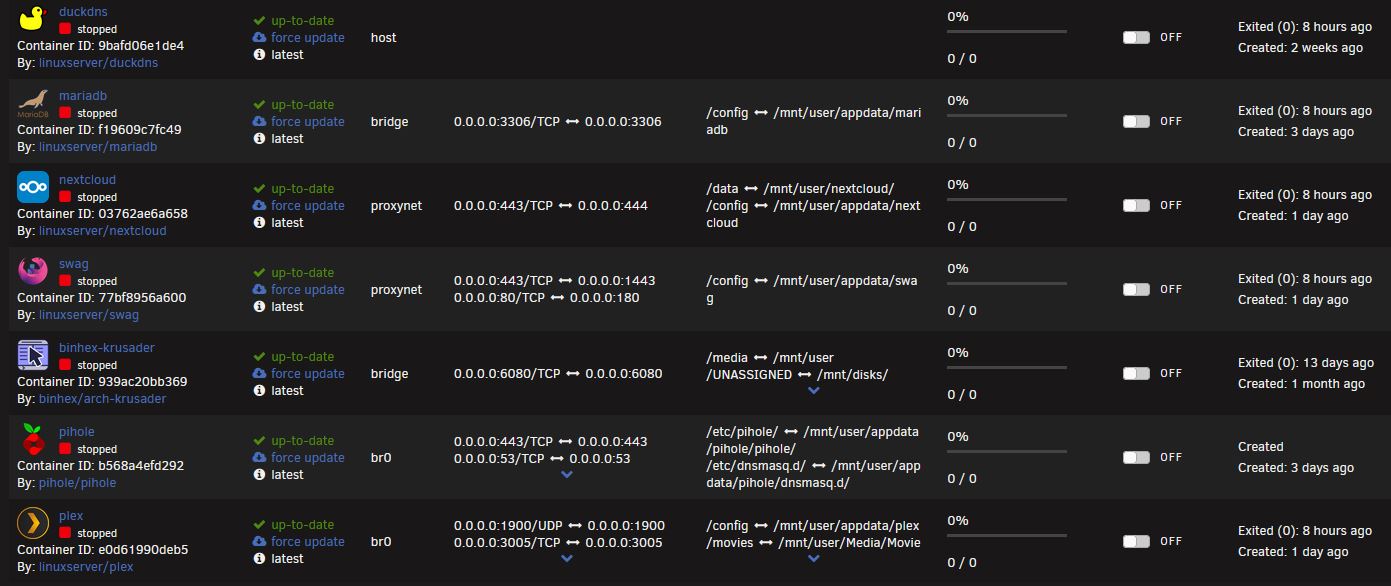

I think I traced it to some Docker Containers. I'm not able to use Plex or Pihole without a crash in 3 days. I'd really love to get this solved. I've realized that I can run the following Docker containers without error:
- DuckDNS
- mariaDB
- Swag
- Nextcloud

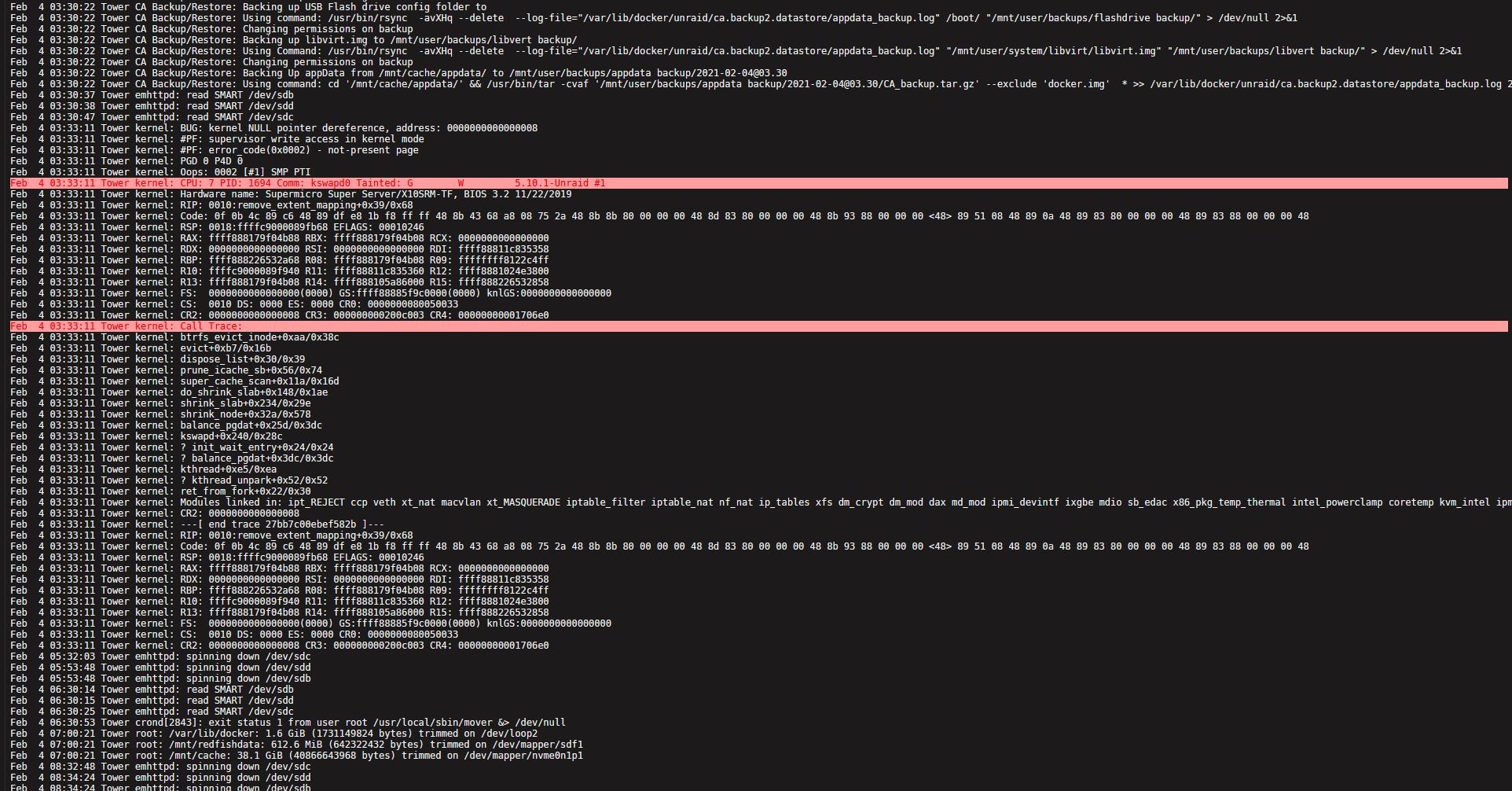

If I run Pihole or Plex I get a call trace or kernel panic within 3 days. Does this have something to do with br0? This happened last night during an appdata backup and may have stopped the backup. Can anyone translate these errors to human readable?
Most likely yes.
google macvlan crash site:forums.unraid.net

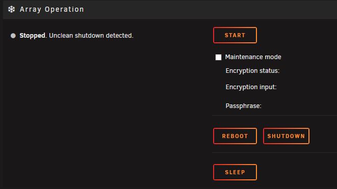

So I set up the networks per the guide. I went to start VM service and got an error that the libvert service failed to start. I figured I'd try to reboot. When I went to reboot it would not let me stop the array. I then clicked shut down (which I assume that stops the array before it shuts down) It then hung and became unresponsive.
After reboot it now says unclean shutdown detected. And started a parity check. OMG. I just had one 3 days ago.

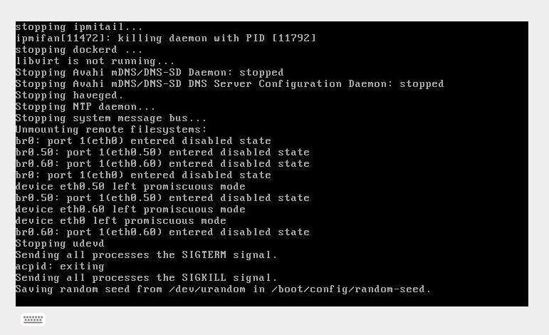

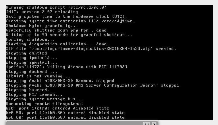

Here are a couple screenshots from my KVM console when it shut down:     Do I have to let this finish?
This is where it hung:

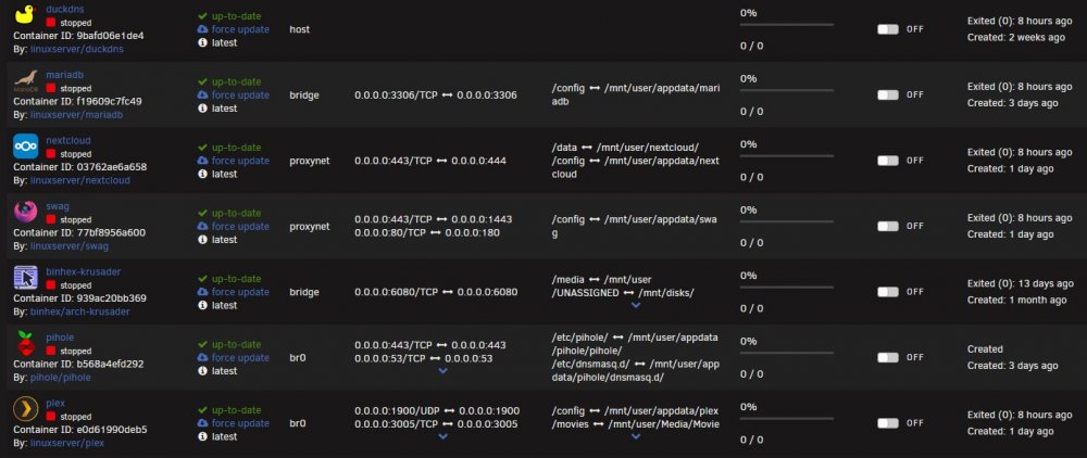

Ok @Hoopster, little update. I was able to get my docker containers working again. Set up br0.50 for VMs and br0.60 for Docker. Added the VLANs on my Edgerouter. Tagged the ports on the switch, updated each container and I'm up and running. Couple question:
- The way I understand it, my router wont be handing out DHCP leases for Docker containers like it does for VMs? (I'm so confused how Docker works)
- Do I have to completely segregate the VLANs with firewall rules to keep the Call Trace issue from happening?
- Should I delete/disable br0 completely?
- I have "Host access to custom networks" set to "Enable." I think I need this for Nextcloud to work (?) Will this cause the macvlan issues?
Edited by adminmat
2 hours ago, adminmat said:
Is having segregated VLANs really the only way to get docker containers to work on unRAID?
No, but, if you are assigning custom IP addresses to docker containers and you are getting macvlan call traces, it is one way to prevent those in many cases.
Docker has no idea about the existence of your router based DHCP server and does not communicate with it.  If you want to do DHCP with docker containers, the VLAN from the unRAID/docker side needs it own IP address range.  I don't even deal with that and just assign static IP address to docker containers within the range I told it to use which is outside the range of DHCP addresses I let my router assign (so there are no conflicts).
Not necessary.  I also have a Ubiquiti USG router (the one used in the bonienl example) and by default it allows all corporate LANs (my VLANs are in this category) to communicate back and forth.  I have done nothing to prevent this with firewall rules.
Again, not necessary.  It's mere presence (at least from what I have seen) does not cause any problems, just assigning IP addresses on this interface to docker containers is the issue.  I still have br0 enabled.
I don't know if this, by itself, could cause the issue.  I had the call trace issues long before that option even existed.  I do currently have it disabled and have never enabled that option.  There are some reports of networking/router issue with it enabled, but, those just may be DHCP conflicts.
