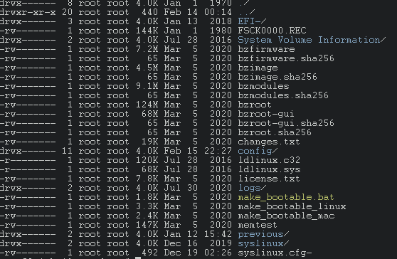

Does the ‘EFI’ folder on the boot drive have a trailing ‘~’ character?    If it does then it is set to boot in legacy mode.    If it does not then it is set to support UEFI booting.

@itimpi The EFI folder has a dash in it:

You could try removing the trailing ‘~’ character and see if you can then boot in UEFI mode.
That must be it, I will make another attempt once 6.9 is out since I'm waiting for the ability to setup SSD pools anyway. Thanks for the input, I should've thought of looking at difference in the flash between my existing install and the fresh one.
