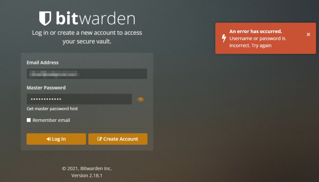

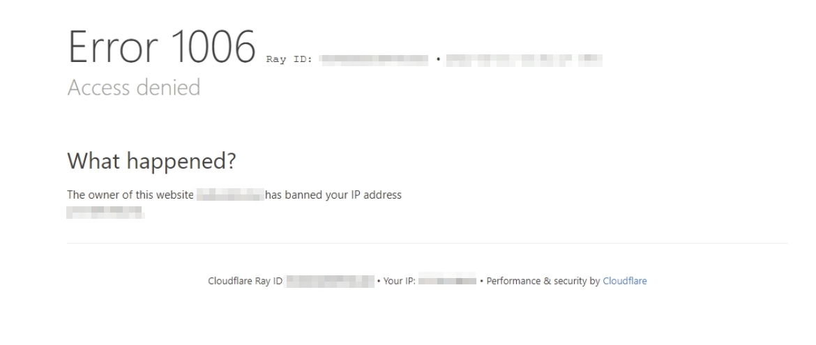

So let's say some unknown user comes along and tries to login with unauthorized credentials / start hammering the portal
30 seconds ~ 1 min and poff banned via cloudflare.

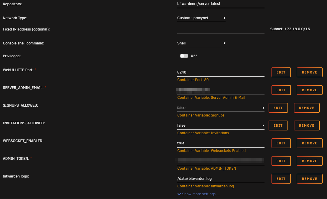

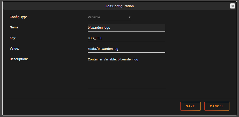

First we go into the settings of bitwardenrs container and we edit the template like I have in the images below.
And inside bitwarden logs you add this.
The /data/ is equal to /mnt/cache/appdata/bitwarden/
Now it's important to know that the bitwarden.log I have there is not going to be generated untill you add the varaibles in the container,
then restart the container. Once this is done the .log will show up in /appdata/bitwarden/

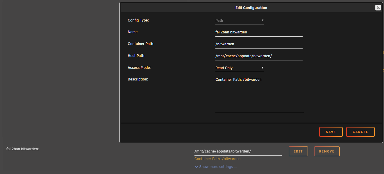

Next let's head into Swag container, and add a path like i have done in the image below.
And same thing here,
the /bitwarden/  is equal to /mnt/cache/appdata/bitwarden/
Next you save and restart swag

Don't know if you need it but, this is how my volume mapping looks for bitwarden.
Yours should look the same.
