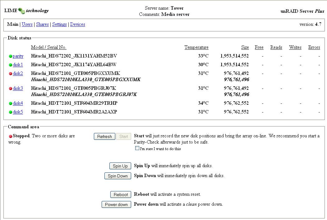

PLEASE HELP - Installed 4.7 and now showing 2 disks are wrong
So I just upgraded from 4.6 to 4.7 and when I booted up I got the error saying "Two or more disks are wrong."  I attached a screenshot and syslog.  Not really an expert when it comes to these issue and wanted to see what I should do next.
Thanks in advance.

easy :)
just got to your disks page
unassign both wrong drives
and assign them right again... in other words just swap them on your drives page
when you go back to the main page after it should be all OK and you will be able to start the array
i better shut up :P
looking second time at the pic i saw they were at the right spot ...
HPA issue as BRiT said
No, not so easy.  :-\
You definitely have HPA on those two drives. You need to address the HPA issue before they will function in unRAID 4.7 or later.

Can I click on the "I'm sure I want to do this" and start the array?  The new size it shows is larger then the old, so not sure if it would let me do that.  Or will that make matters worse?
Can I go back to 4.6 for now?  I have a M4A785-M motherboard on the way and should be here next week.  I also picked up some 2TB drives and will be replacing the disk 2 and disk 3 that have HPA.  I am getting away from Gigabyte boards due to the HPA issues and this is not the first time.
syslog.txt
If the description says it will clear the disks DO NOT START THE ARRAY.
You can probably set a new initial configuration and then have unRAID recalculate parity based on the new configuration or revert to the 4.6 version you were running.
