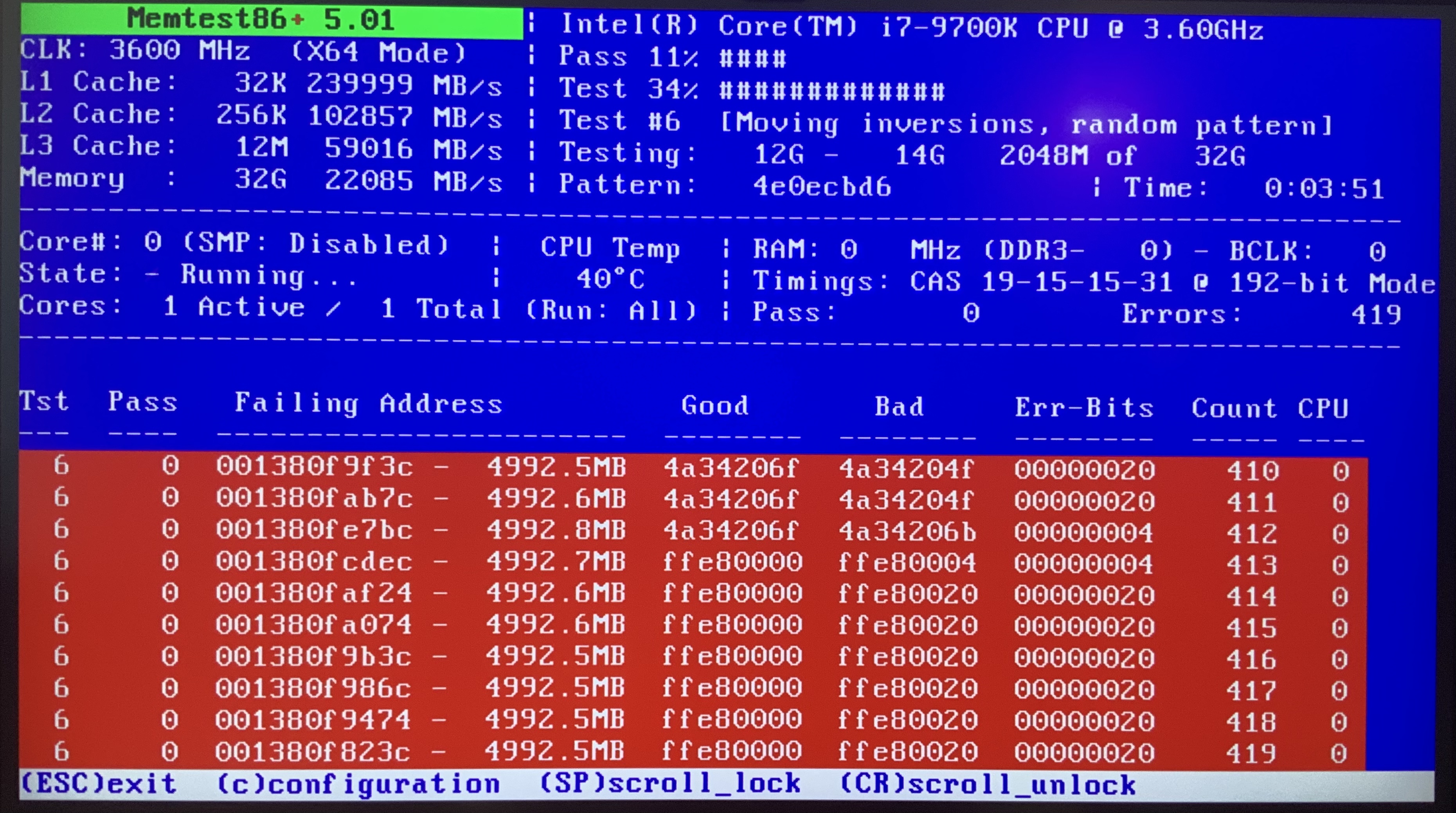

Running it right now and it is finding what looks like a lot errors (see attached).
Yep, try with just one dimm to find the problem one.
So to clarify, corruptions with my RAM are causing the issues with my NVME drives?
Almost certainly!
RAM issues are unpredictable as to the symptoms they cause but file system corruption is not an uncommon one.
The only acceptable number of errors when running memtest is 0 :(
And btrfs is much more sensitive to RAM errors than for example xfs, so much more likely for problems to be detected there first, and a couple of bit flips in the wrong place can destroy a btrfs filesystem.
